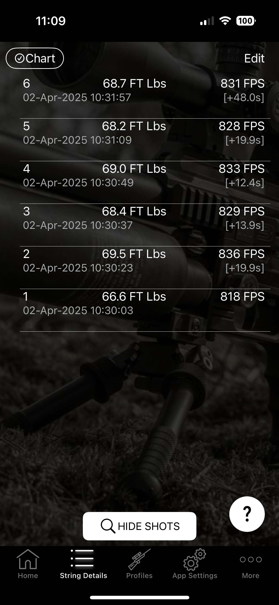

lowered it down to around 170 and def improved
I bet you are under hammered even at 170Bar. Do you know if it has a heavier hammer weight or spring? Also do you have the skinny plenum tube or the bigger Power Plenum? What barrel length is this, makes a huge difference?
My old Wildcat was faster at about 140Bar than what your rifle is doing, suggesting something is still amiss.
I have the skinny plenum 600mm barrel and not to sure about the hammer components. I was thinking of just starting to update everything piece by piece. Like the power block kit, slug kit, transfer port etc.
I’ll bring reg down to 150 and see what happens, hammer is maxed out
I would certainly recommend the Power Block kit, you will see a nice boost in performance. And a hammer weight and spring will be opened up and easy to swap out while you are installing the Power Block kit anyway. I would consider the Huma tuning kit over the FX slug kit, and for sure get the Huma transfer-port and probe.
