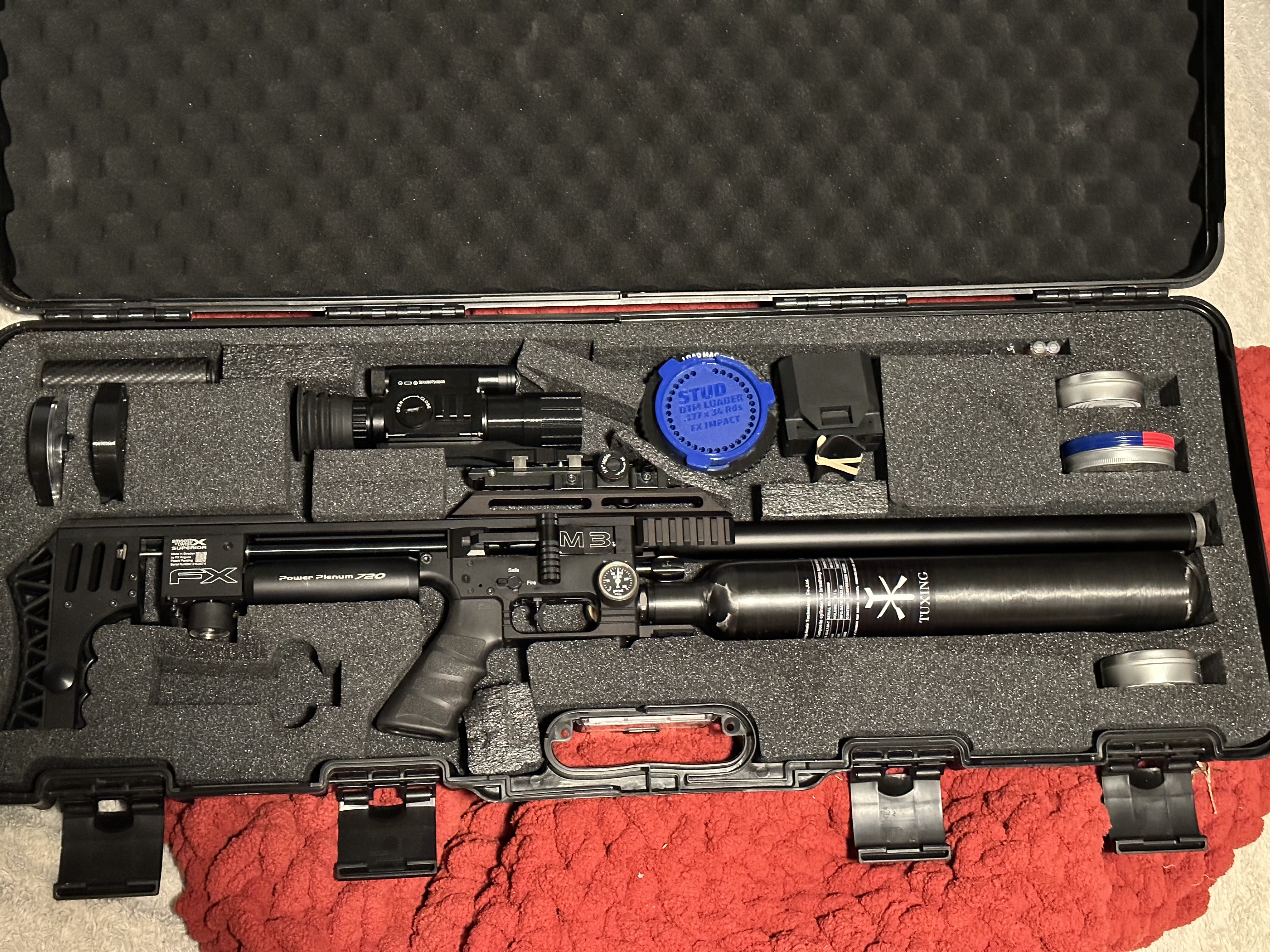

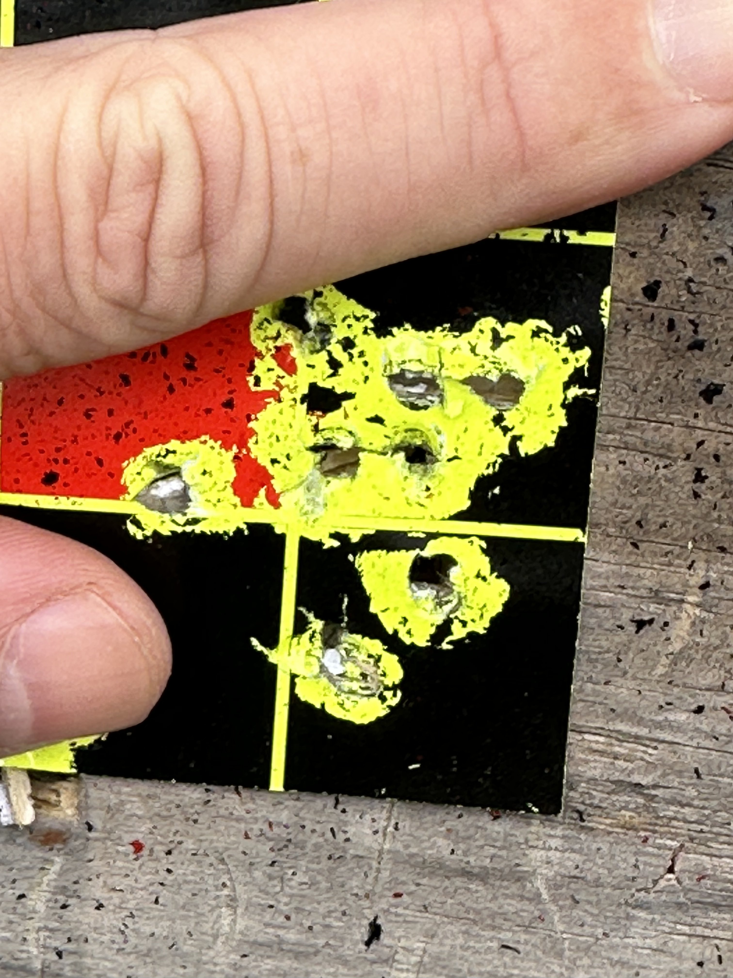

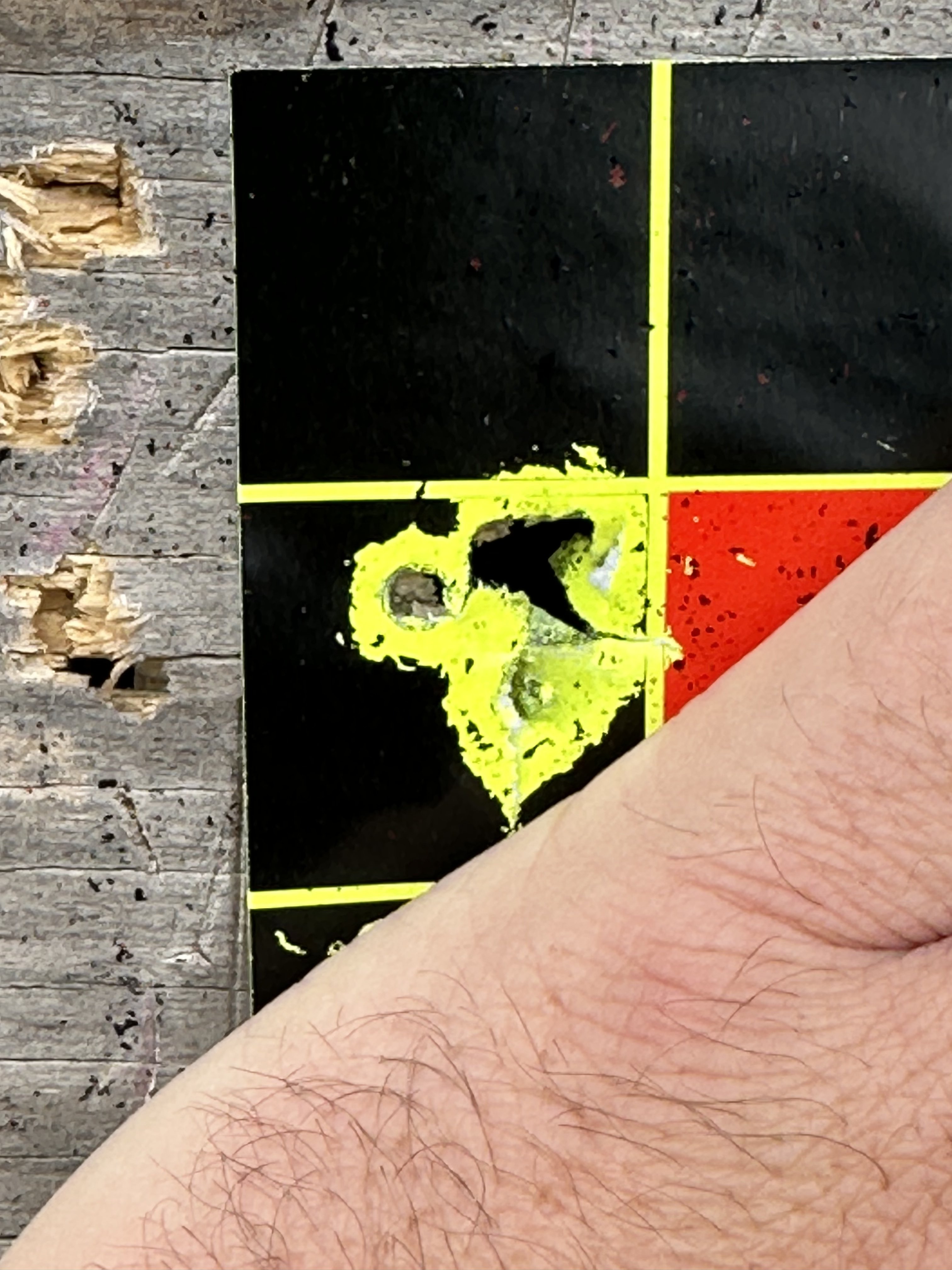

Impact M3 .177 insane shot count with Hades and easy to turn up for slugs
So I purchased some hades in .177 for my Impact with 700mm barrel and 700cc bottle. They did not like the higher (880-900) speeds in my gun so I ended up getting down to 600fps for them to be good at 22 yards and kinda decent at 50 yards. Where I ended up I am using 4 bar per magazine. So starting at 250 bar and ending at second reg of 80 bar that would calculate out to 1445 shots per fill. That is almost 3 tins of pellets. Below are the groups at 22 and 50 yards as well as a picture of the gun.
