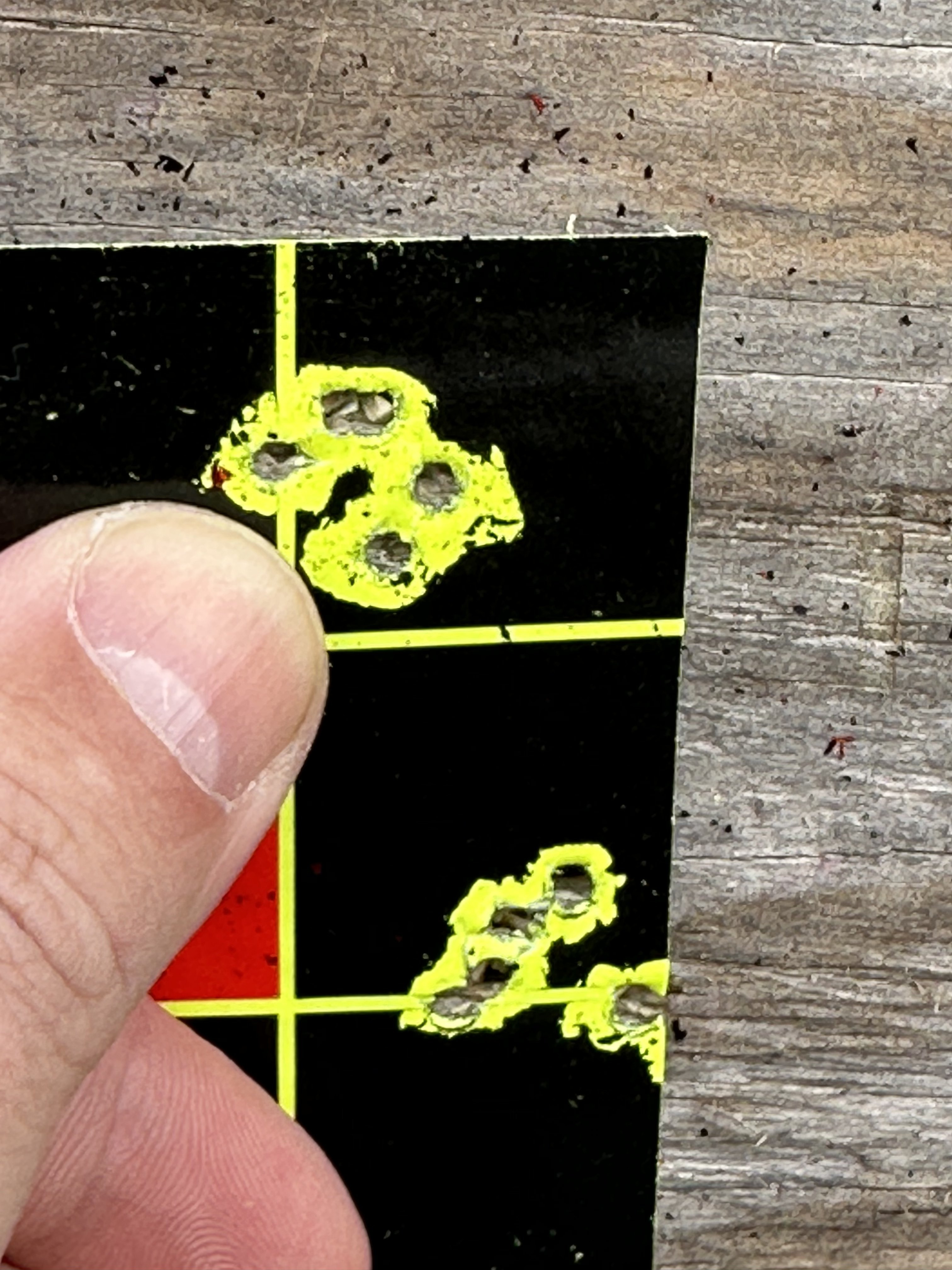

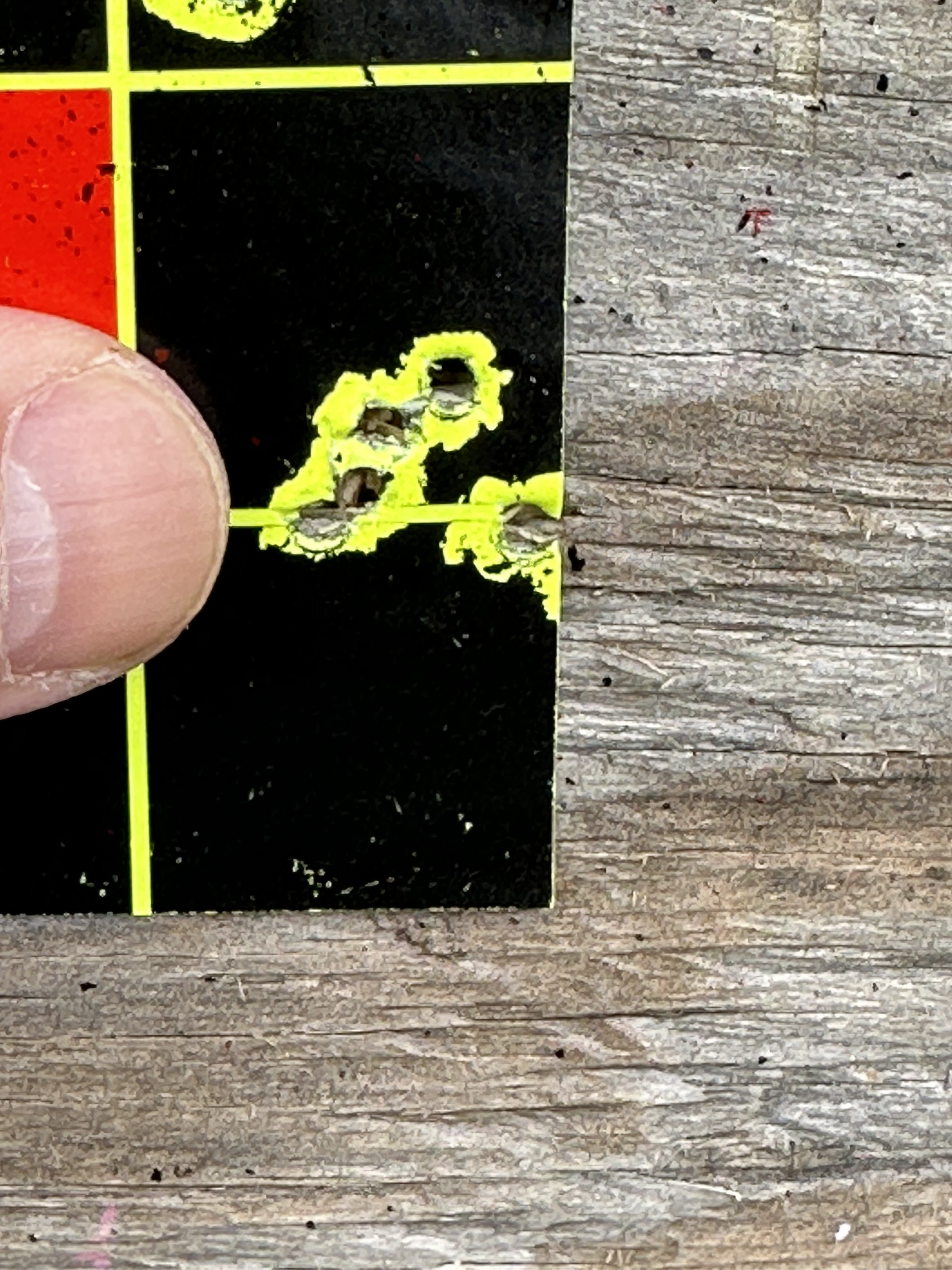

I decided to move my Sekhmet digital gauge to the second reg and it turns out my factory gauge was off. It is not 80 bar but 95 bar. That means it was set at 115 bar from the factory and not 100 bar. I had the digital gauge on the bottle because I wanted to see if it was correct as it read different than my compressor. That factory gauge was off as well, it read about 20 bar low. The digital matches my compressor.
Went out and put some 12.5 and 15 grain slugs down range. It will send the 15s 920fps and I settled on 880fps for accuracy. Macro on 16 and micro on 3 with valve on line 4. 2nd reg at 95 bar. Below are two 5 shot groups with the 15s at 50 yards.

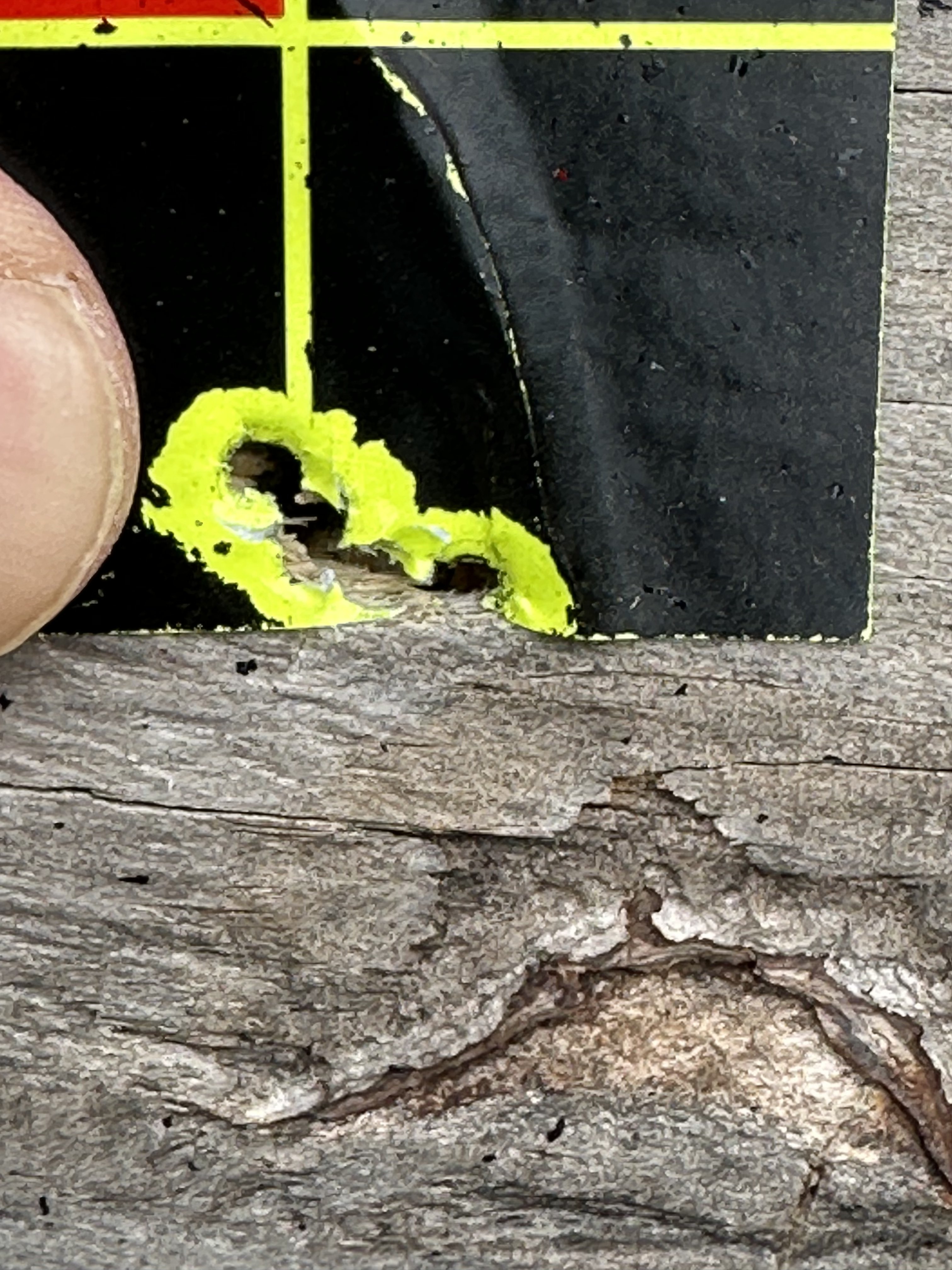

I settled on 920fps with the 12.5s. Below is a 5 shot group at 50 yards.
