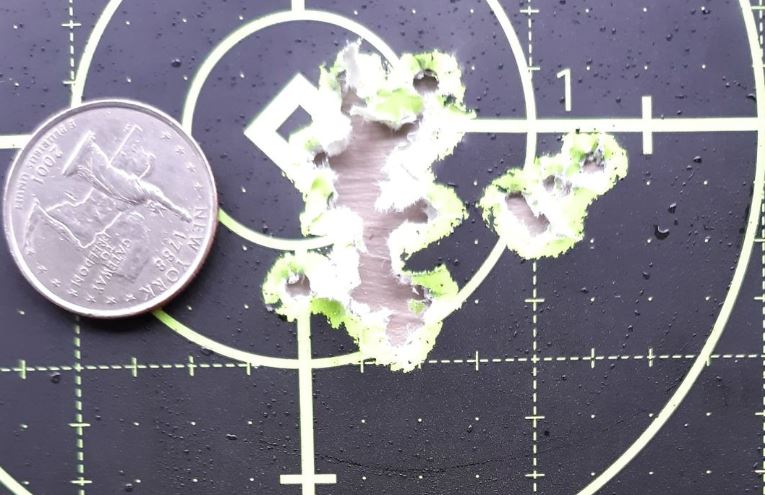

Was shooting them with my Impact M3 .22 700mm heavy liner, carbon sleeve, harmonic tuner
I got very stable speed shots in 1020fps, 2nd Reg 130 Bar, but no accuracy at all ... Harmonic tuner did not help either.

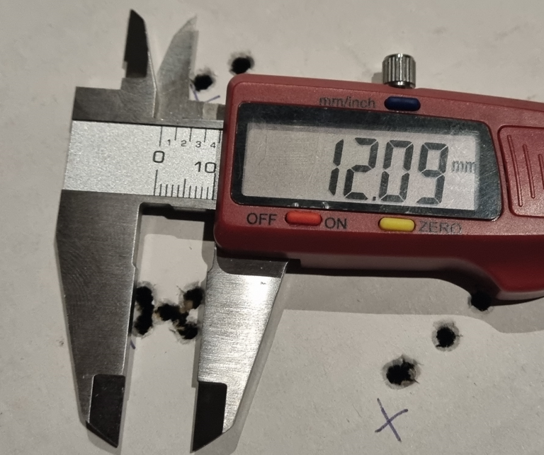

Noticed that accuracy is much better when lowering speed. So reduced Reg2 to 120 bar, and from 975 reduced to 965 with valve. Working with Harmonic tuner got a good result shooting 50m target:
BUT at 100 m not good at all... Expecting to reach sub moa. But was far from that, like 3 inch or even more.
Will try reducing speed even more, but ran out of amo.
They say that slugs like higher speeds, but that does not seem to be so. Or is it with heavier slugs only?
