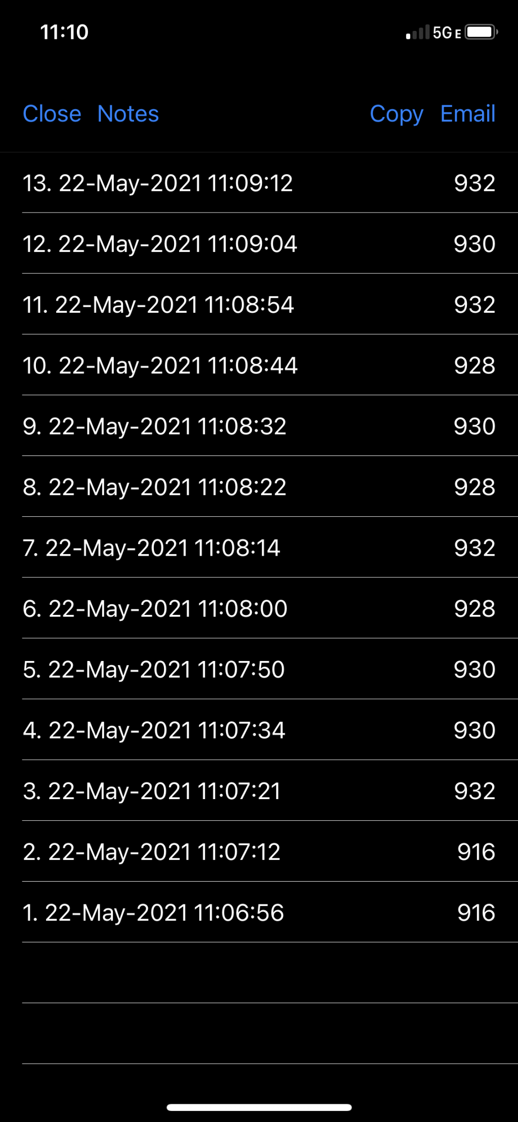

this was no dry firing, the gun was just filled and it is grouping a full clip(13) under 3/4in at 50 yards. I’m gonna slow it to 870-900 FPS and hope groups tighten.
