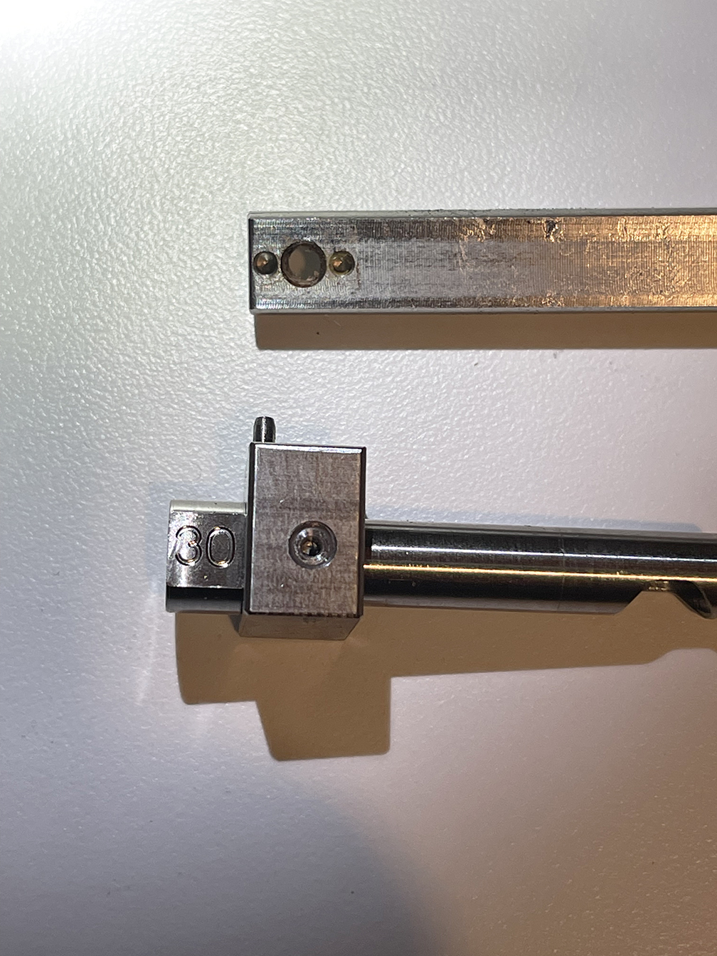

I found what is causing the issue of my magazines not feeding smoothly. Call it a happy accident produced the culprit. When checking the tightness of the little 1.5mm grub screw that holds the probe in the carrier, and with VERY little pressure, the head began to strip, so I stopped. I immediately ordered a couple of spares from FX and wow they arrived in 2 days! Way to go FX!!! But...Then I found a video where Ernest recommends replacing the factory carrier with the K&L "Ultra Grip Probe Carrier". I ordered it and it arrived today. Broke the rifle down and when I removed the factory installed probe carrier, I noticed that somehow FX neglected to install one of the two cylindrical pins that hold the carrier in proper alignment when the tightening up the countersunk screw on the probe guide. Photo attached. The missing pin allowed for just enough wiggle and play to cause it to snag up on the magazine when moving it forward.
So now the mystery is solved and I have ordered two replacement pins tonight. Fingers crossed that they get here next week so that I can go on the hog hunt I have planned.
Thanks for all your input and thank you FX for your excellent and super fast support!
