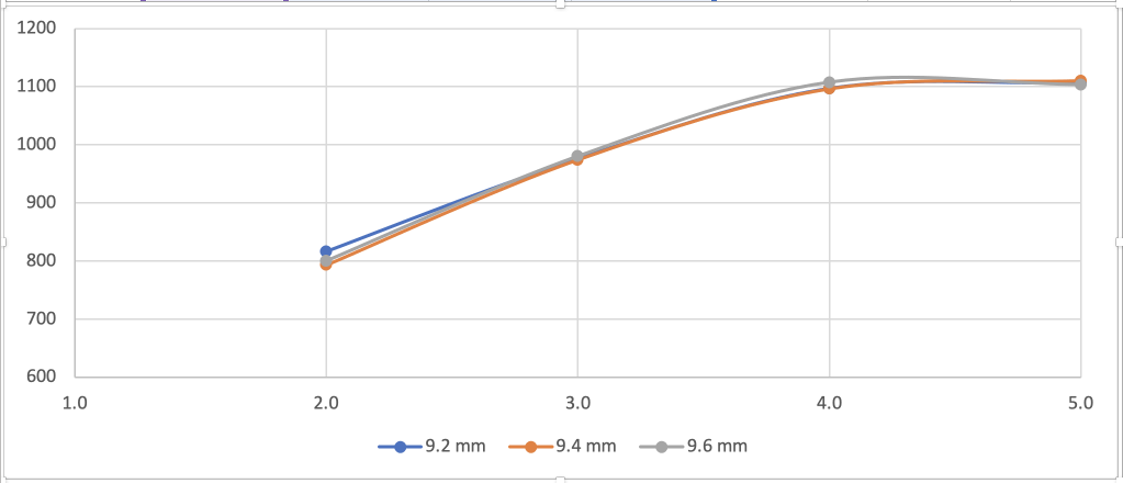

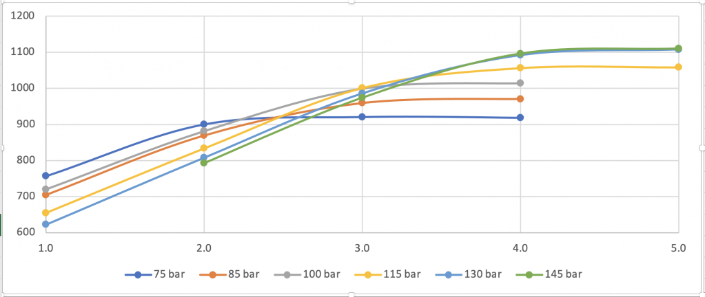

I'm trying to tune a .22 sniper to shoot range of ammunition with only needing to move the micro (or macro) adjuster. However I only can get about two units of adjustability out of the micro adjuster before it has no further effect. For simplicity we can ignore the macro wheel as it simply modifies the position of the micro adjuster. I can shift the position of curve of the micro adjuster with the valve adjuster, but can't seem to extend the range. For example, at a fixed reg pressure, I can shoot 18.1 gr pellets from 725 to 1025 FPS from micro adjuster positions 1.0 to 3.0 respectively if the valve adjuster is at 9.6 mm. Beyond 3.0 is too much hammer spring and does nothing good. Tightening the valve adjuster to 9.2 mm still starts at around 725, but lowers the top end to just under 1000 FPS (with micro at 1.0 to 3.0). I'd like to get more top end to shoot 25.4 gr pellets/slugs at 950+ FPS and still be able to plink with 14.3 gr Crosman ammo. The macro wheel provides about 1.6 points of micro adjuster range, so maybe more range isn't useful for a given micro setting. I'd like to be able to move the starting point of the micro adjuster and be able to use something like 3-4 points of its range. Maybe this isn't possible, but I wanted to see what other's experiences have been.
