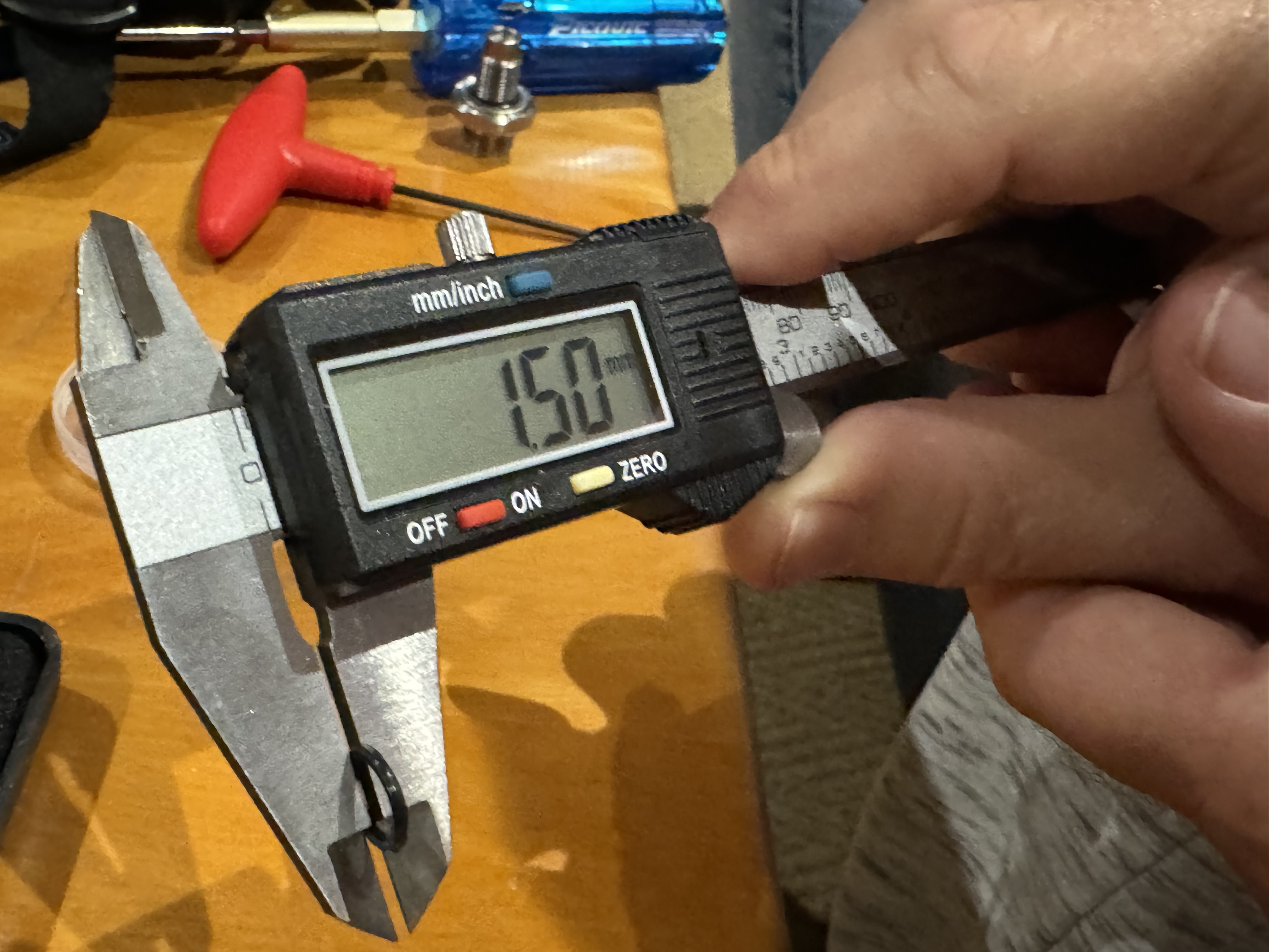

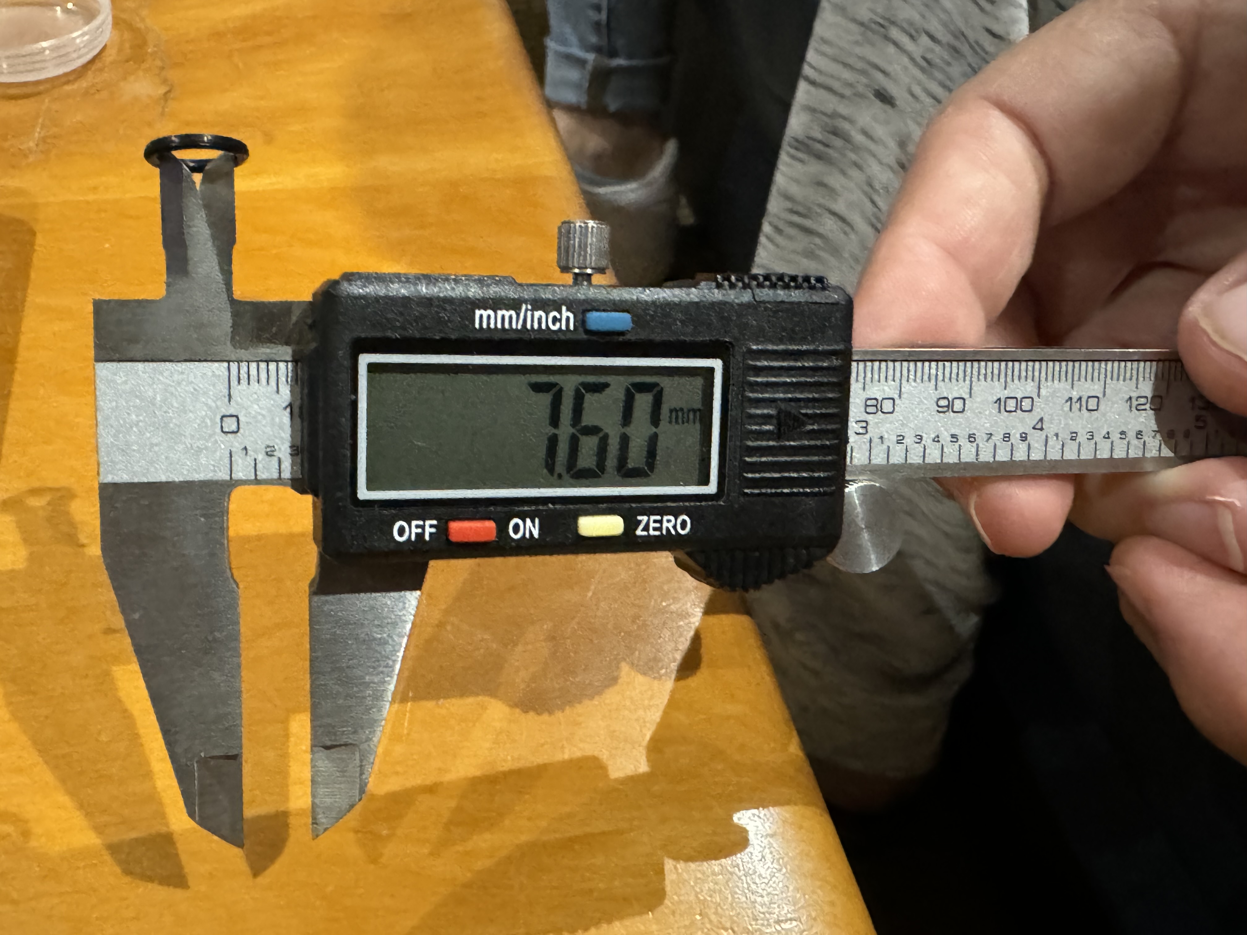

I found the O-ring that's most likely the root cause of a slow leak from the front reg I've been dealing with for weeks now. Problem is, it doesn't show up on FX's parts diagrams. Does anyone know which O-ring this is?
Thanks! That O-ring is supposed to be 7.5x1.5, measuring something squishy with calipers is damn near impossible so you were really close.

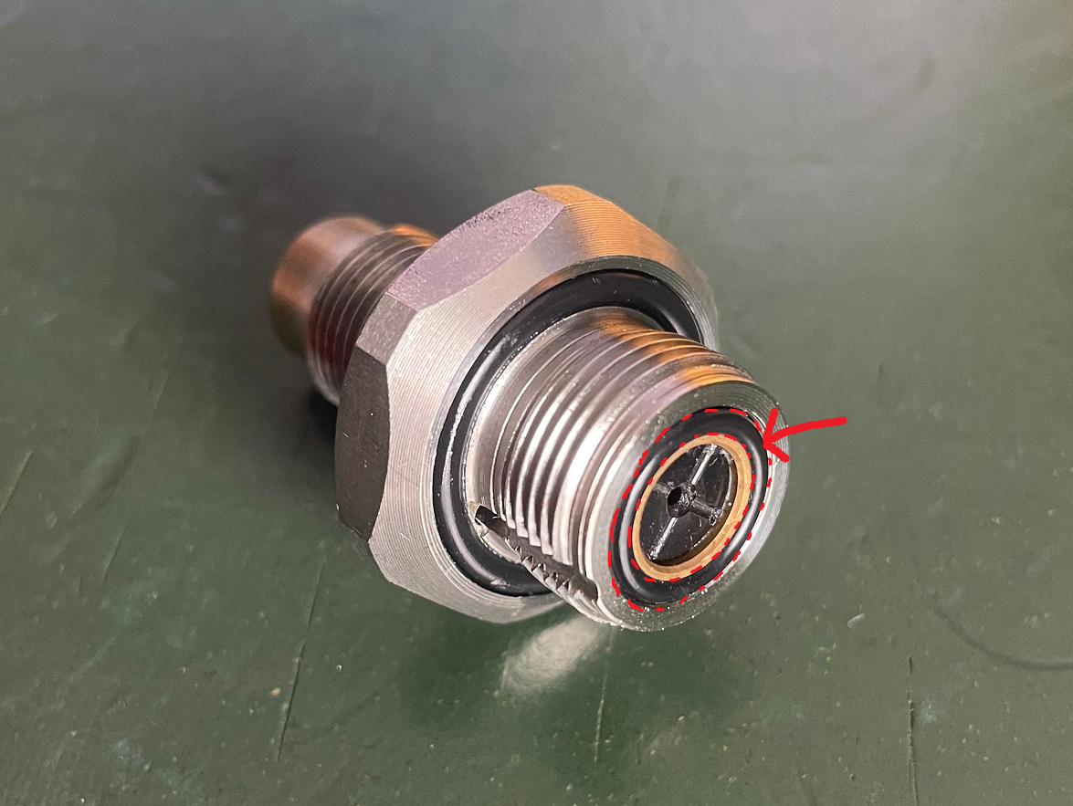

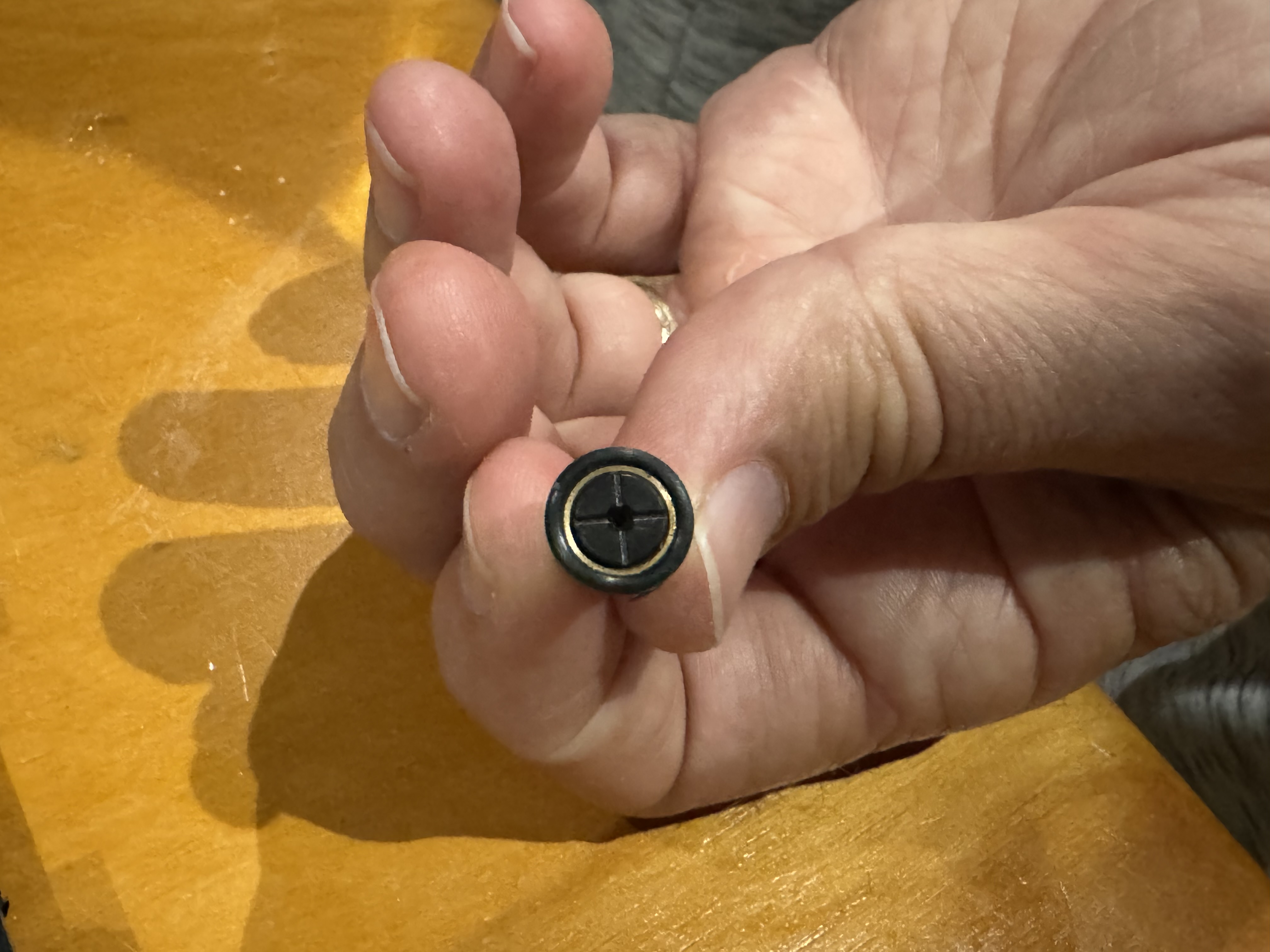

Another O-ring altogether ended up being the culprit. It's the little 4x1.5 one hidden deep in the reg body, also not included on the diagram (ffs FX, how hard is it really?). Replaced that one and leak seems to be fixed now.
