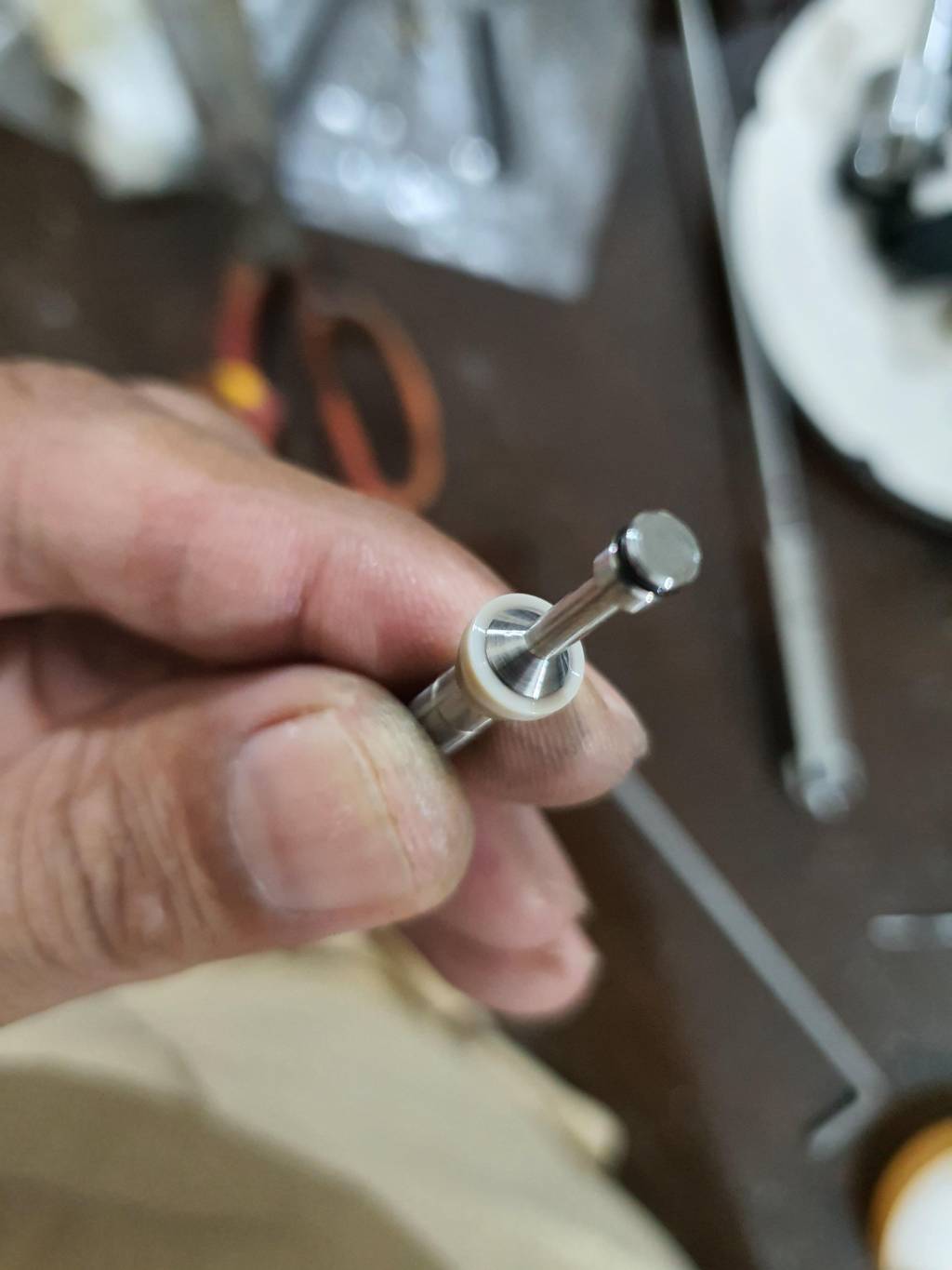

Sealing perfectly even at 60 bars.

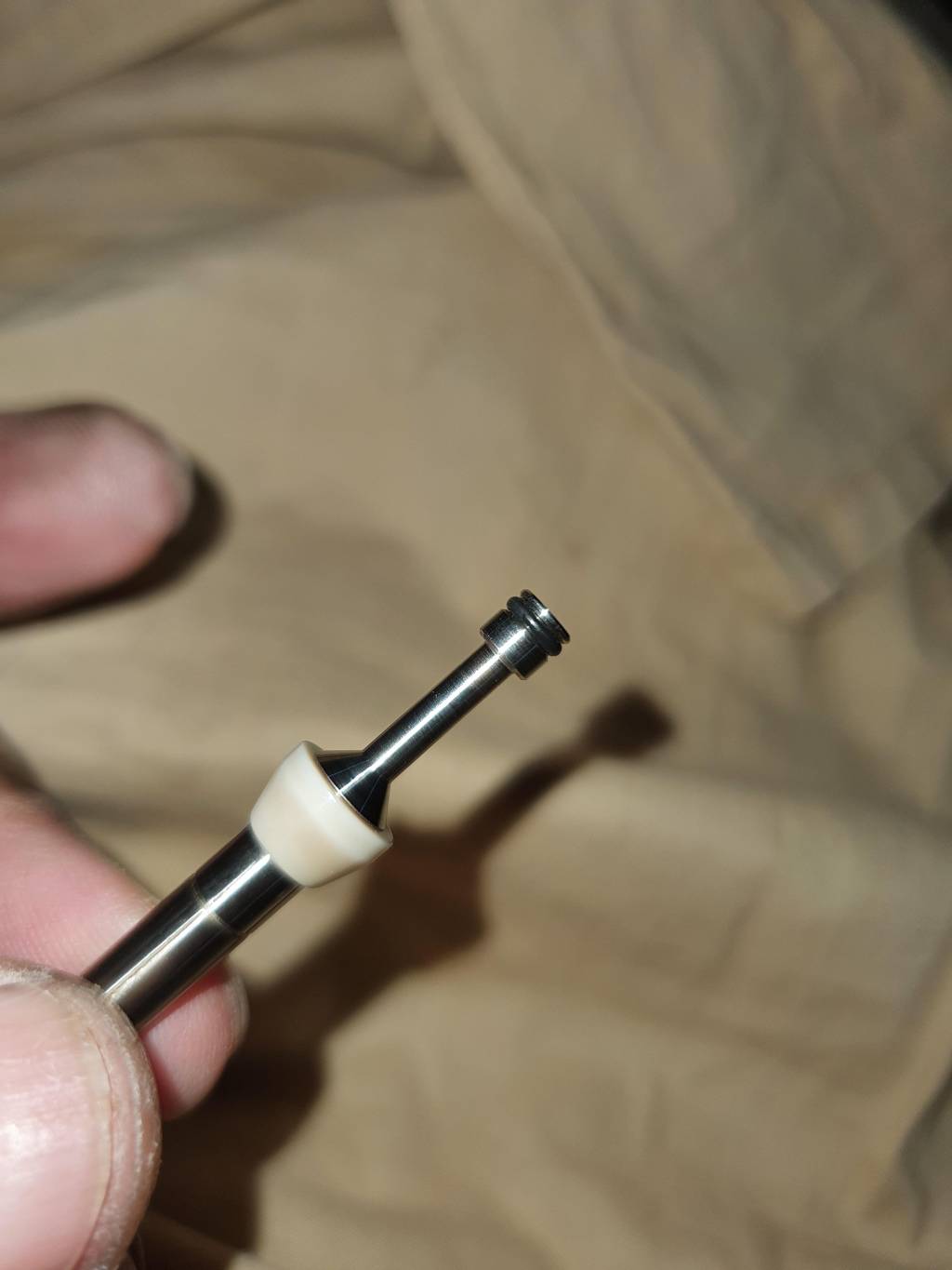

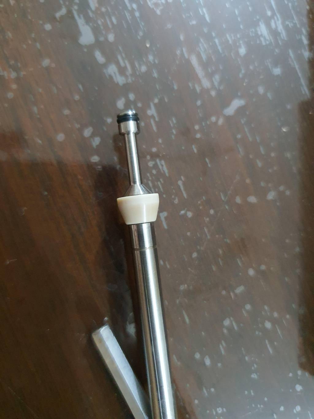

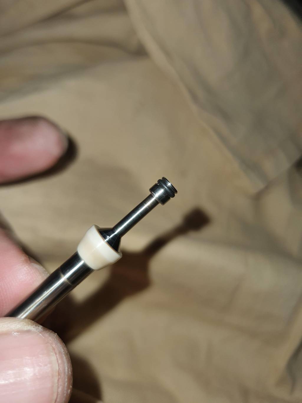

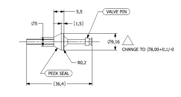

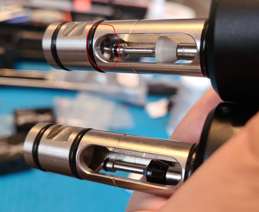

When I was there (couple times) I ported the Rear Block to a 7.2x9.2 mm slot, ported the Valve House from 6.5 to 7.4 mm, I made couple scenarios with the peek poppet and finally ended up with 8.2 mm. And I left the front Rad 0.3.
Screenshot some of these mods. Finally I ended up with a power increase = aggressive.
At the moment cannot upload images, must be again some server issues "unable to create upload directory".
Edit: finally got the pictures uploading. These were my changes un-restricting the air passage only (like a stage #1 chip tunning the car, just to remove the restrictions), I have many alterations at the front end.
