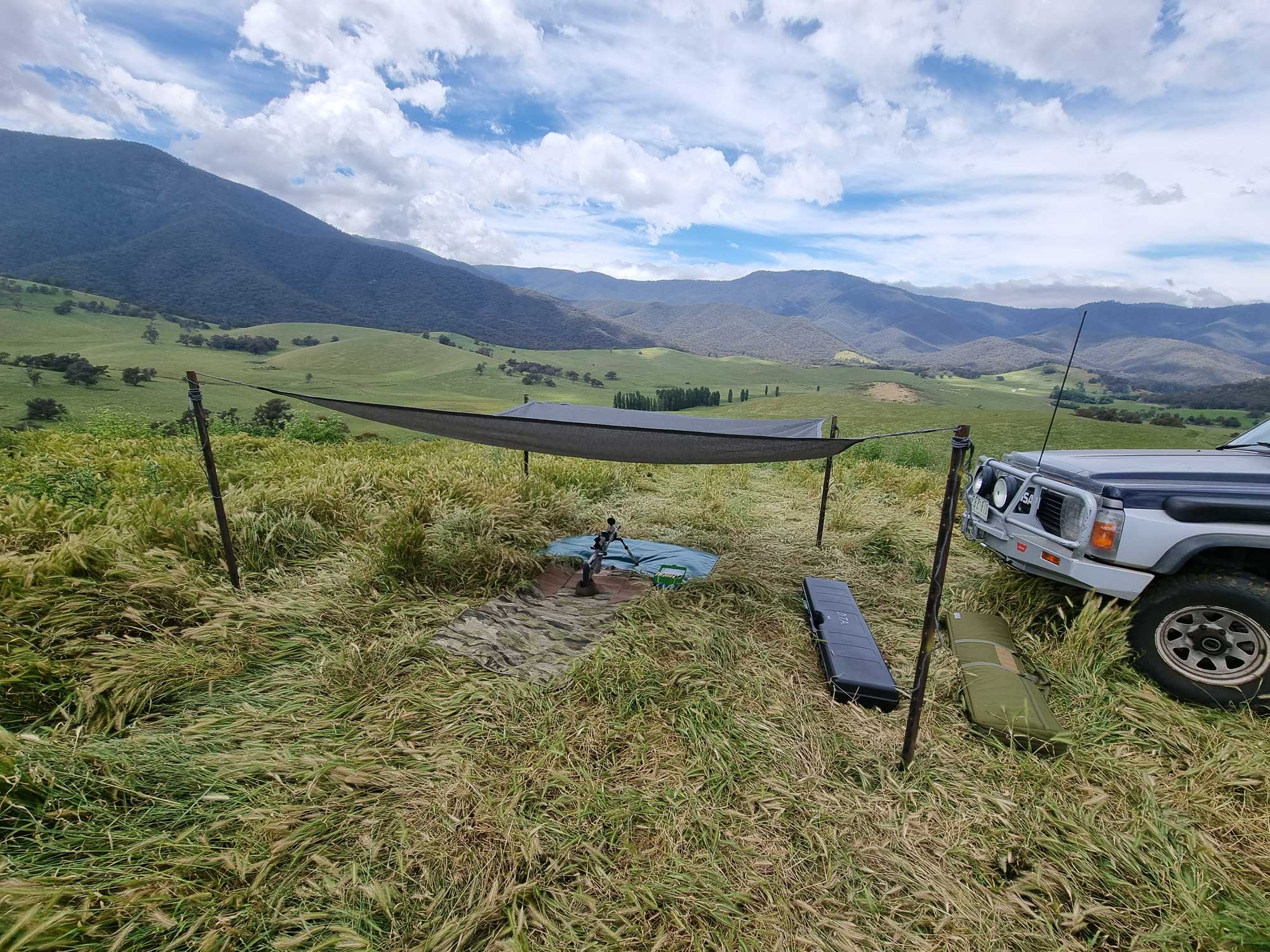

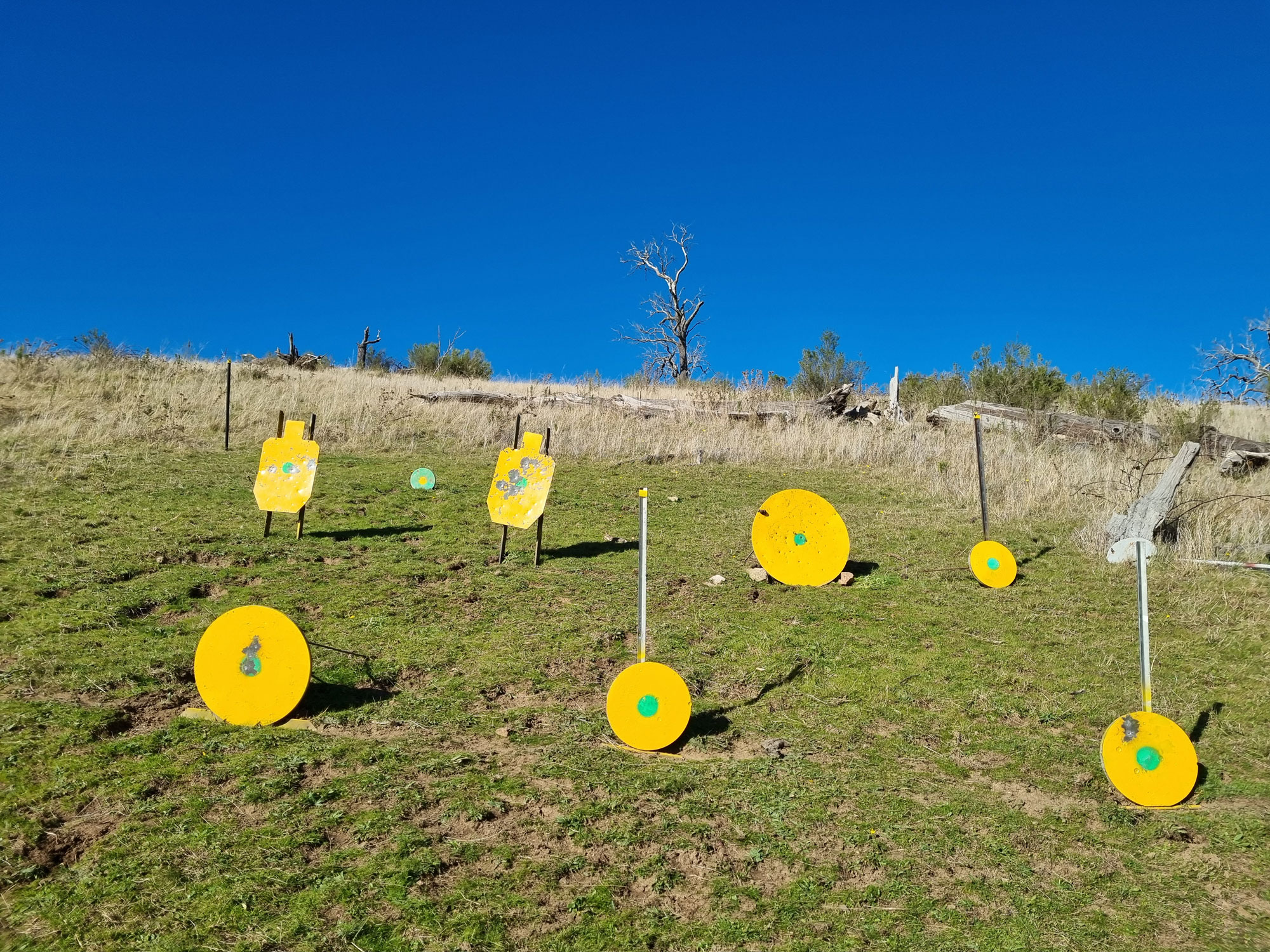

I am a LONG time shooter ( powder burners ) form way back ..my passion is precision and ELR. I am lucky to own a big property and have several ranges set up out to 3500mtrs to which myself an friends often shoot.

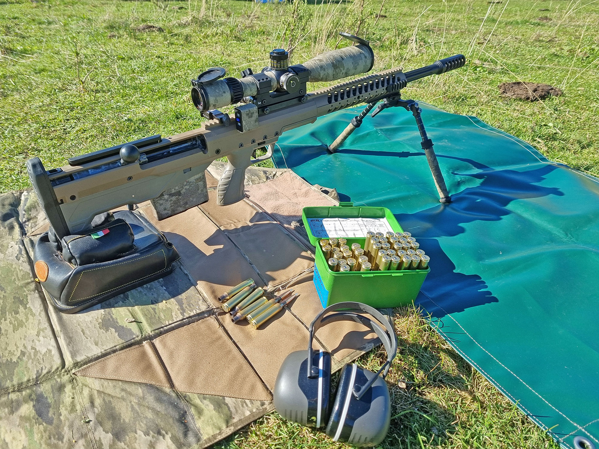

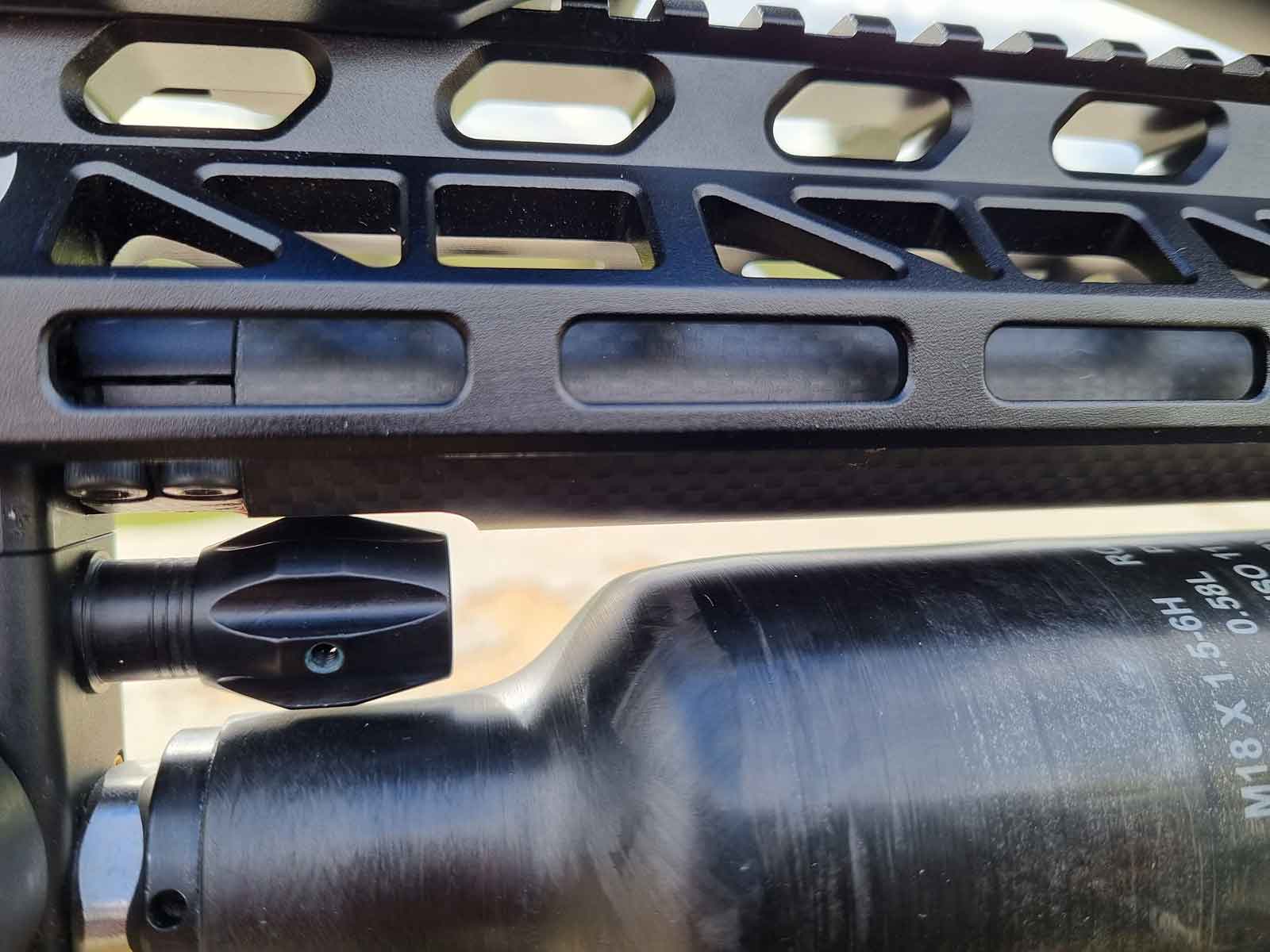

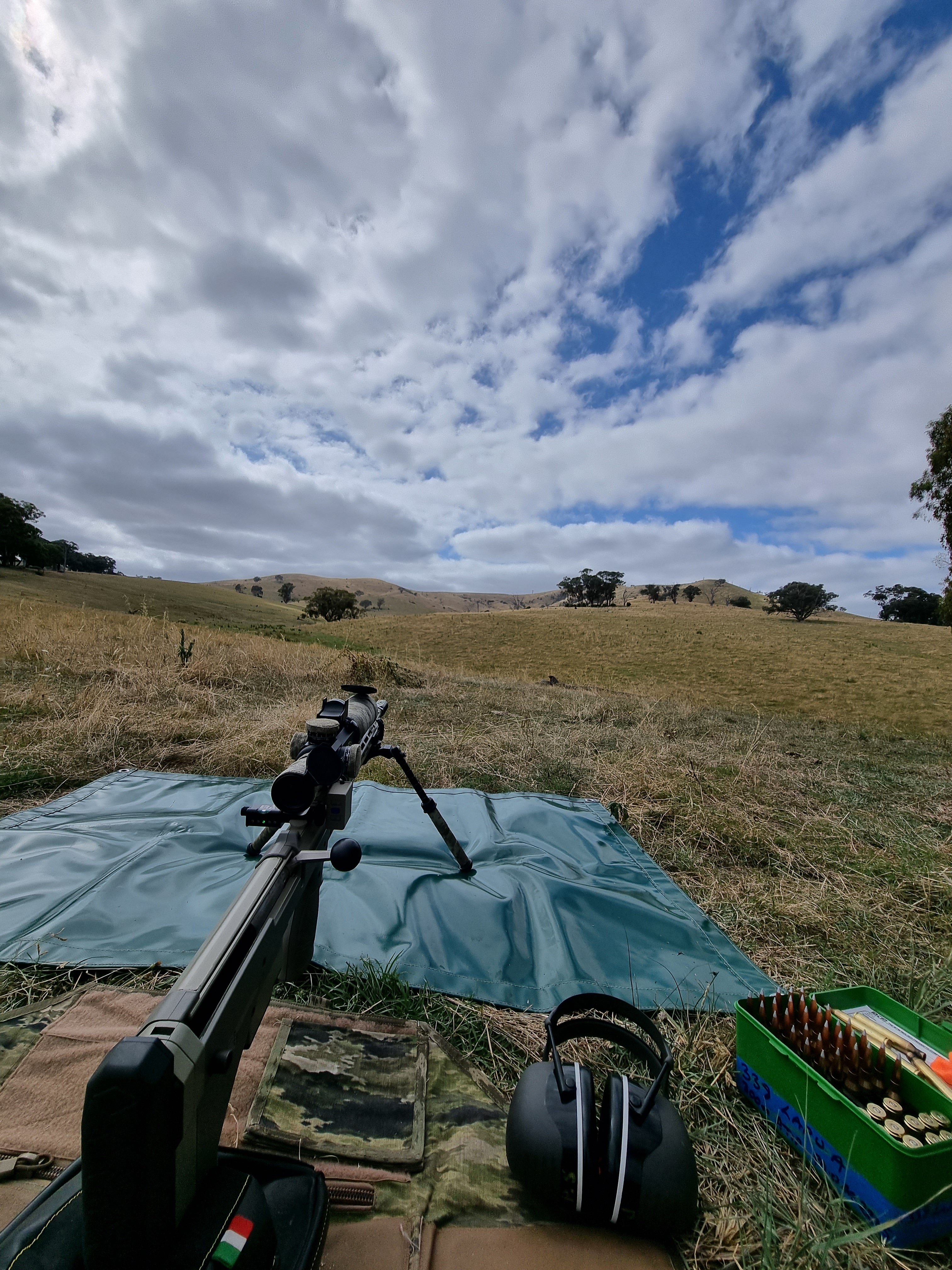

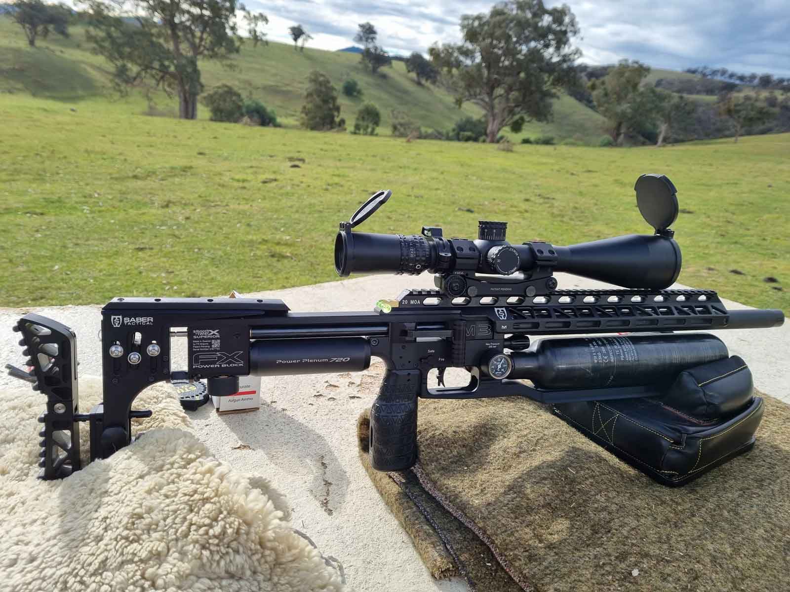

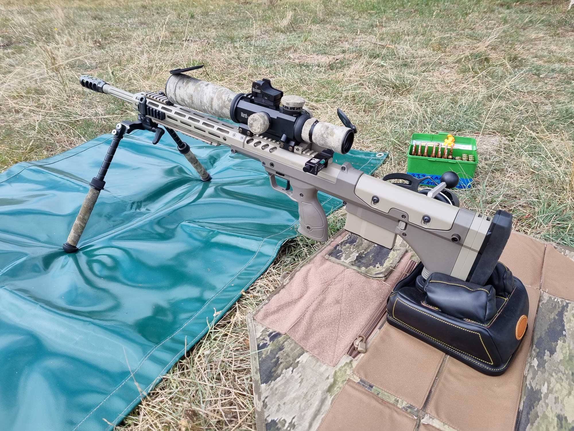

Attached a some pics of my centre fire rifles i use for ELR and my Impact

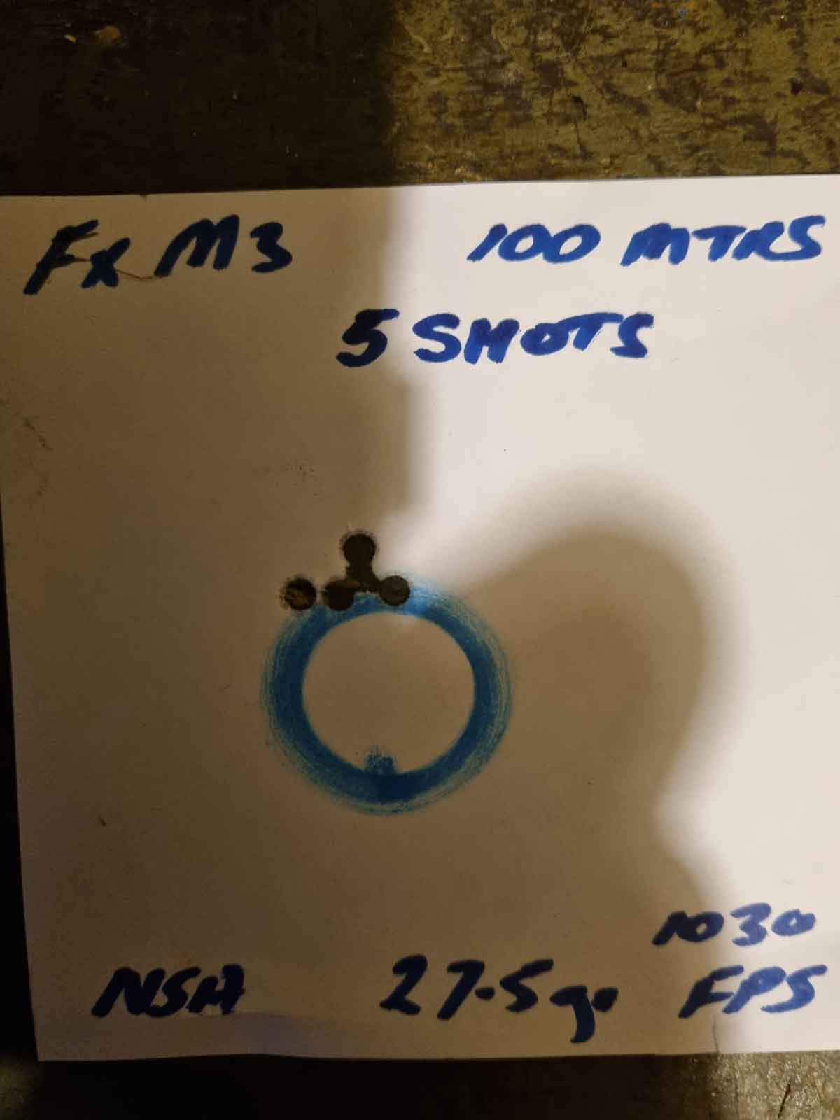

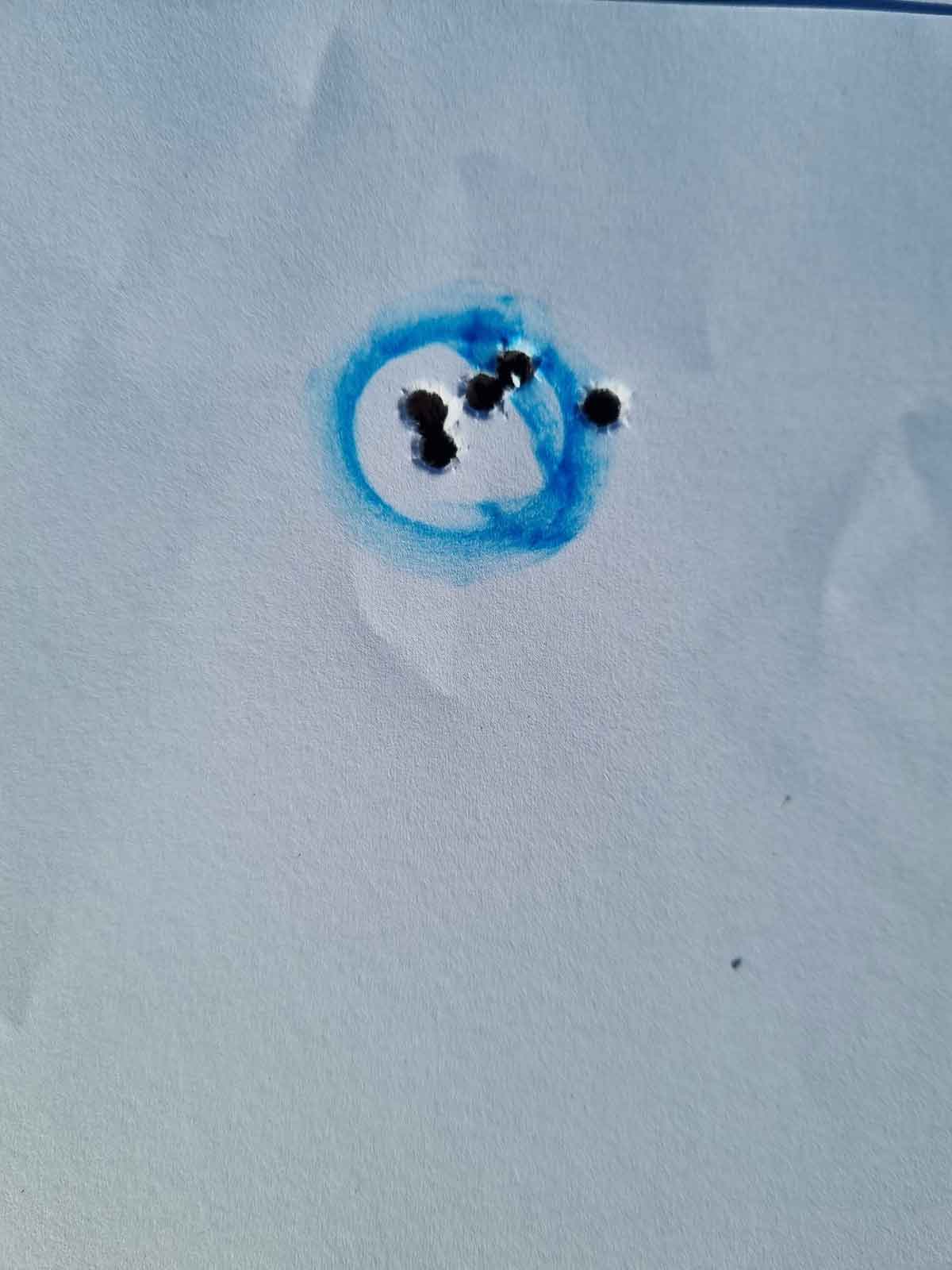

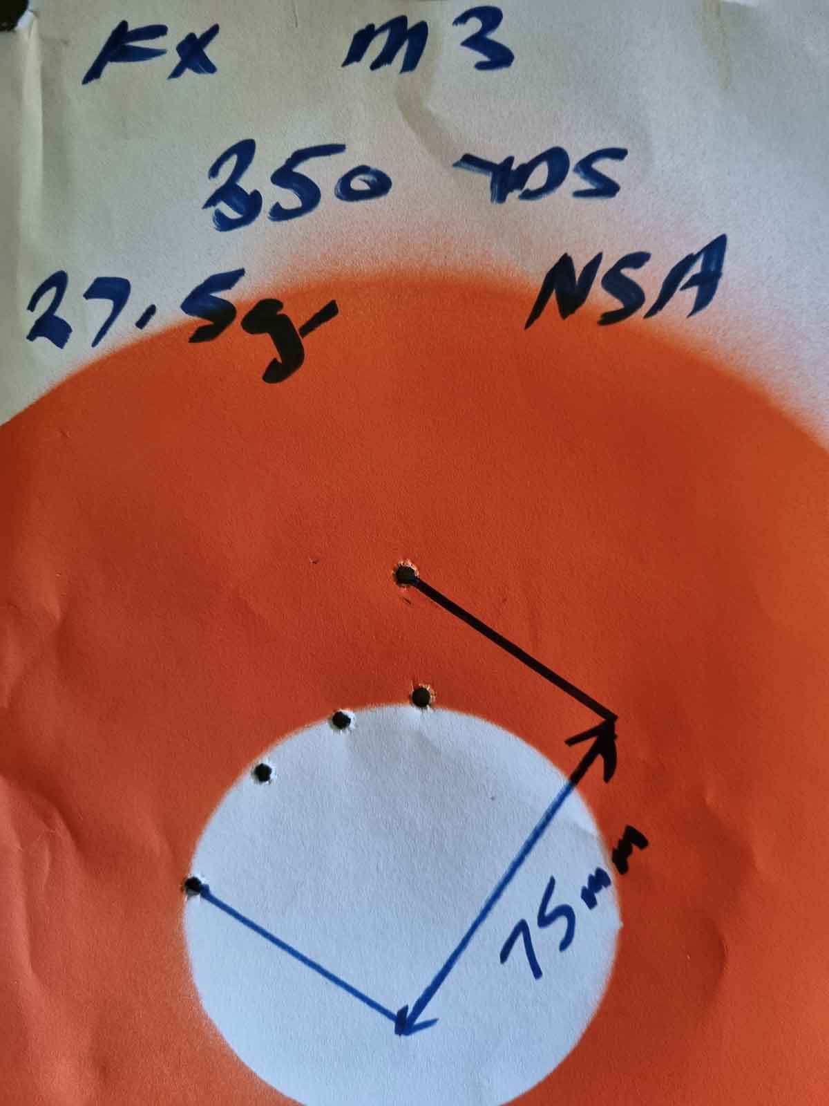

Using NSA 27.5 Slugs ...218" at circa 980fps... These will produce genuine 1/2moa at 100yds.. Also shoot very well out at 300yds..
1st reg at 180/ 2nd 140 Hammer @ 5...... Macro circa 3 ish..front valve circa line 3

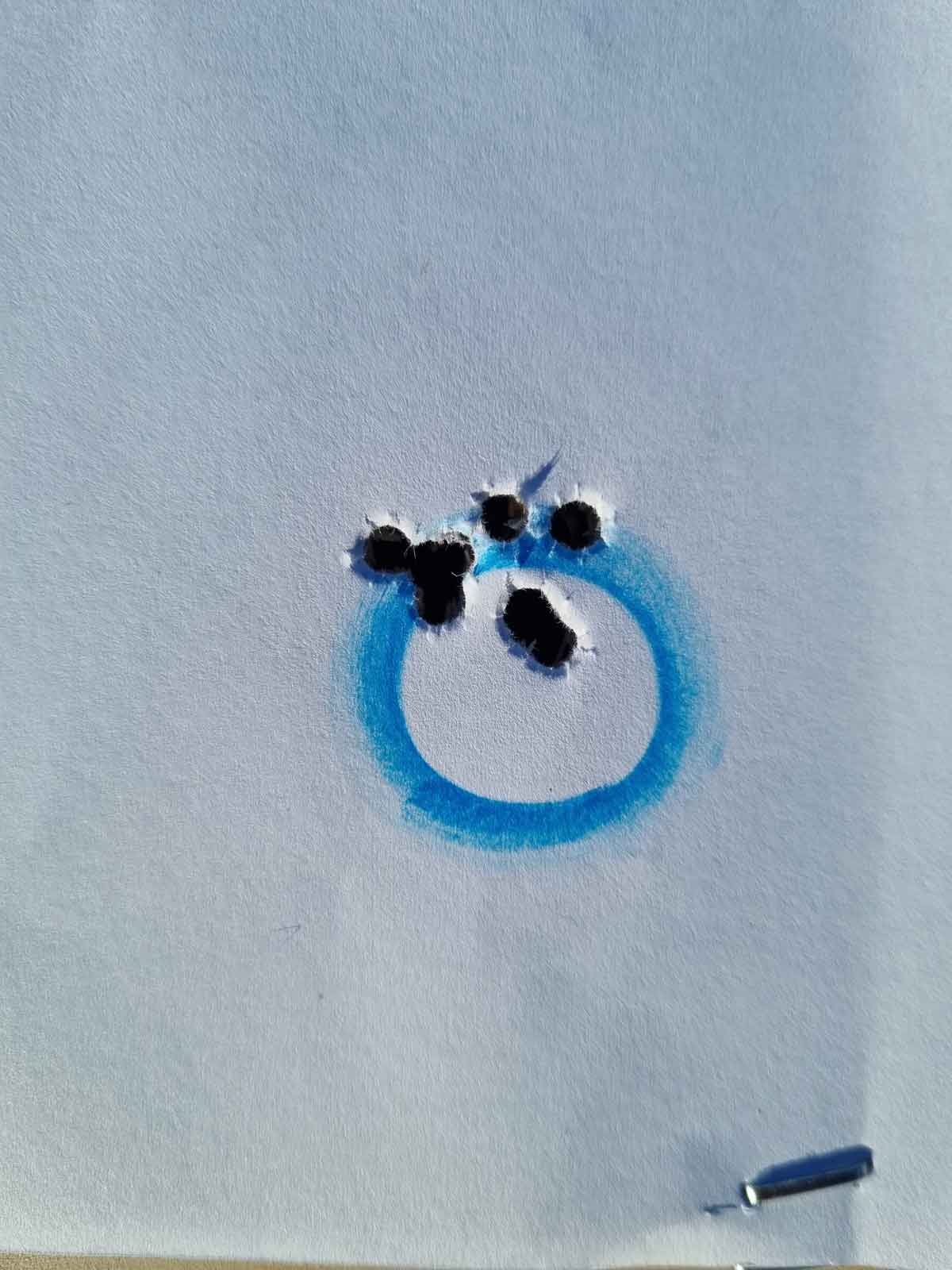

As i have said...group size is NOT an issue....just POI change..

Those are GREAT groups!
If it's only poi shift it would have to be (in what little I can guess), either something going on with the scope or mount or something to do with the barrel/liner loosening/moving.
That's frustrating for a rifle that accurate. I wish I could shoot groups that well at those ranges.
Question. What range did you zero the rifle? POI shifting at that range?
