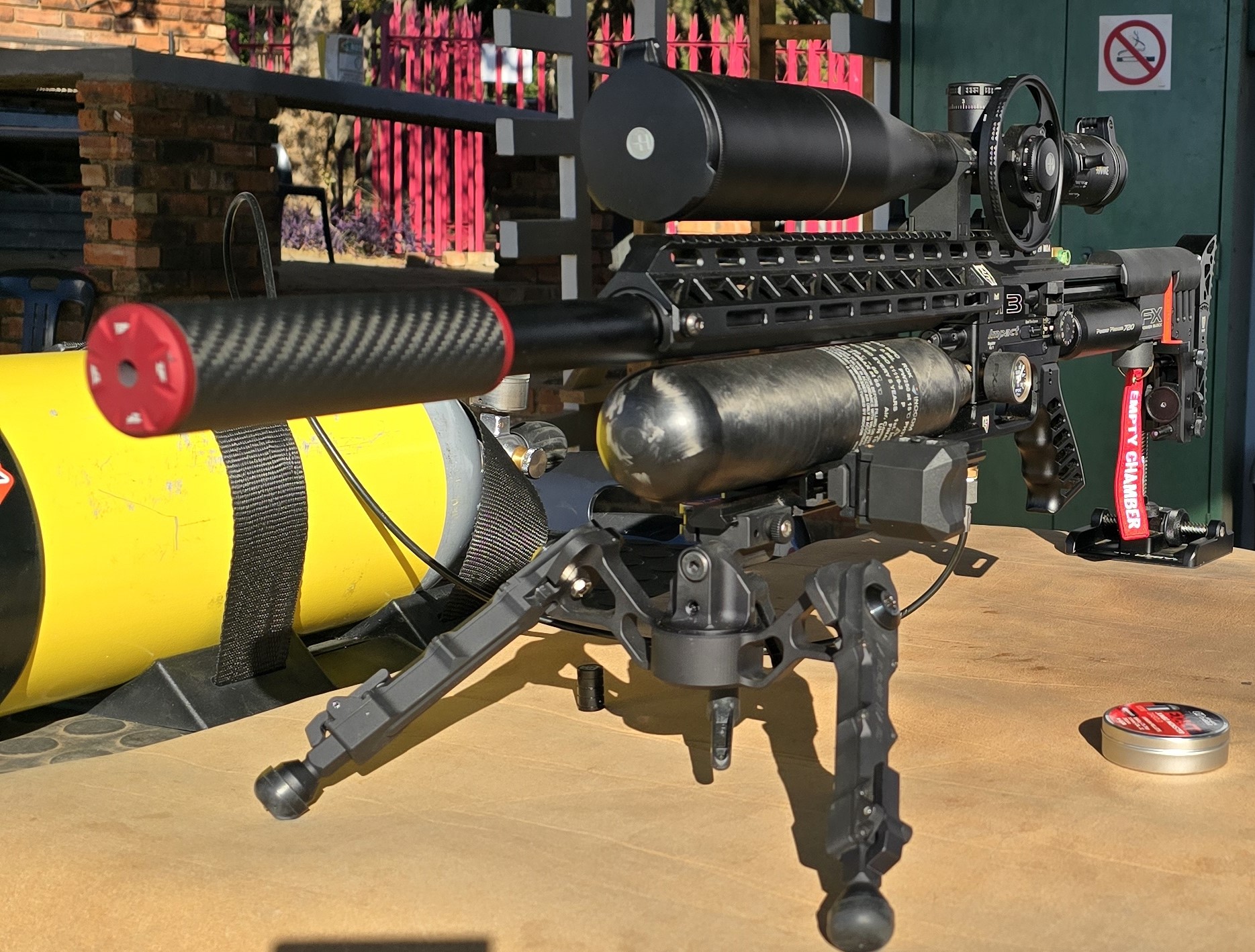

I had this same problem, and done everything that you have done, my first area of concern was the 3 bolts holding the Scope rail on, 2x 4mm tiny bolts and 1 x 5mm bolt this seems very weak, especially the first thing most Guys do is add a Sabre tactical front rail which puts even more stress on those tiny mounting bolt and to make it worse some use a top mounted Bipod such as the GRS one all stressing those tiny bolts, So fitting a Backbone rail thats one piece and held on with 8x 4mm bolts seems a very worthwhile upgrade.
the second area of concern was the barrel itself, this is how not to fit a barrel to a rifle, held in with one grub screw any a clamp if you have the barrel tensioning kit, I glued in the Carbon liner, then got a 16mm Id 20mm od carbon tube, then a 20mm Id 25mm od Carbon tube, I skimmed off the 20mm tube so it would fit tightly into the 25mm tube, so once it was all together then was no flexing anywhere, I refit the barrel to the action, then I Modified a 25mm Scope mount and made a bracket that connected the Barrel to the Backbone rail, tensioned the barrel, then tightened my modified barrel mount, so the barrel+ backbone rail fitted with a Spuhr single piece mount are all as one, tuned it to the smallest group I could achieve, then Zeroed for 65 Yards MPBR

Hi All!
I managed to sort my POI issues out. unfortunately, I did a few things all at once, so I'm not exactly sure what fixed it, but it's so insanely accurate, and I can take it straight from the case and shoot exactly where I left it, unlike before.
1. My barrel was under tension, i.e., when I removed the front bolt, it moved significantly. So, I ensured the barrel was inserted correctly and finger-tightened the bolt, keeping it in place.
2. I cleaned my barrel with JB Paste to remove any lead deposits stuck in the barrel.
3. I fitted a Saber Tactical / Delta Force top rail.
Absolutely love my setup now! .22 Shooting 25gr JSB redesign at 970fps (2.1 SD) 9 FPS Spread.
That's all it took ;)
