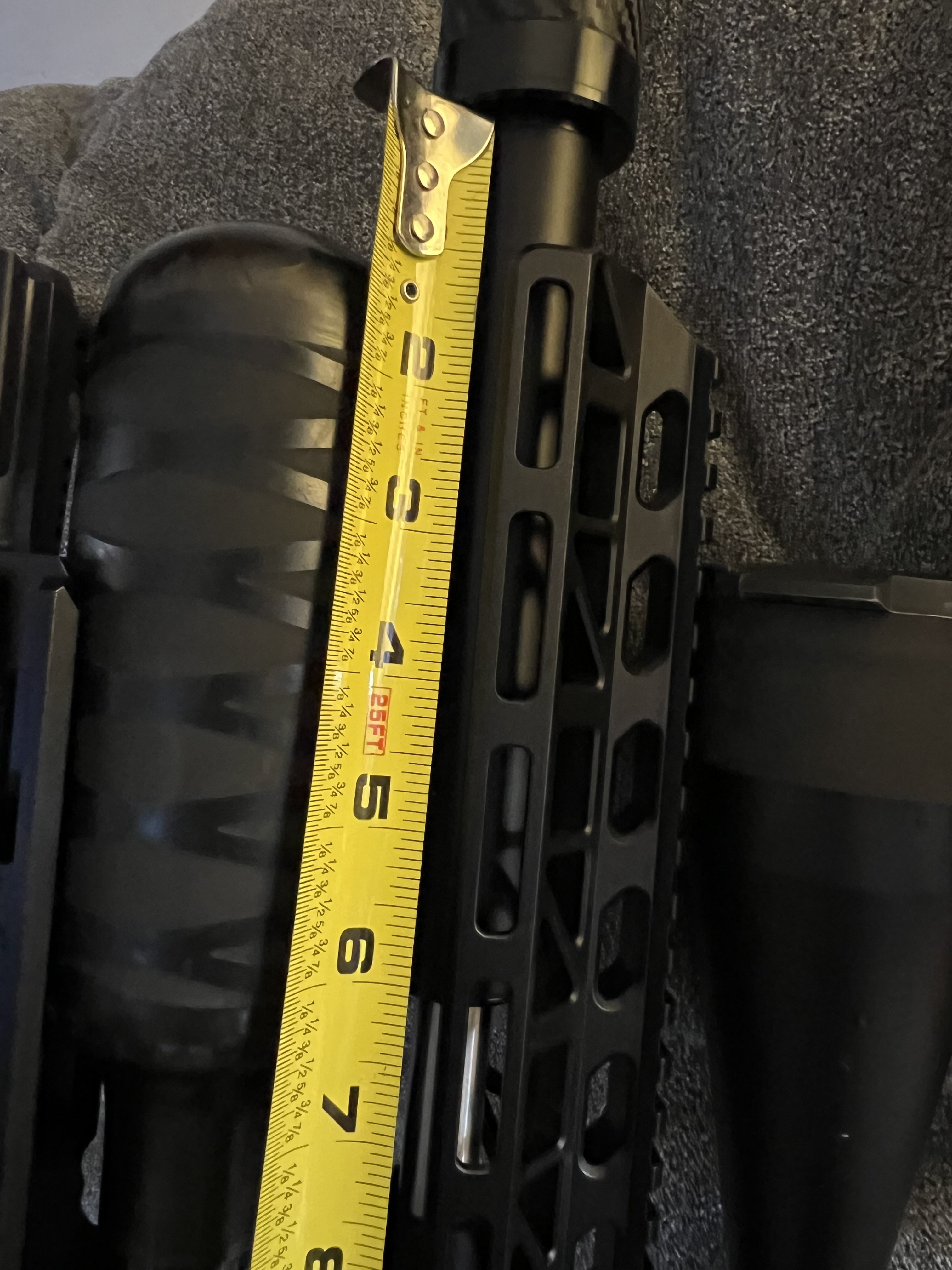

My shroud is exactly 6 5/16” long so that seems normal. I learned a lot more about the gun in the last few months and the easiest solution was to find some small washers and put them over my barrel lock nut against my barrel liner so when I screw in my shroud it would give me just a few extra mm of clearance so I could go out to at least the 4th line on my valve adjuster. Simple fix really, just needed some time and experience to figure it out. Will update with pictures later for anyone else who comes across this thread.
