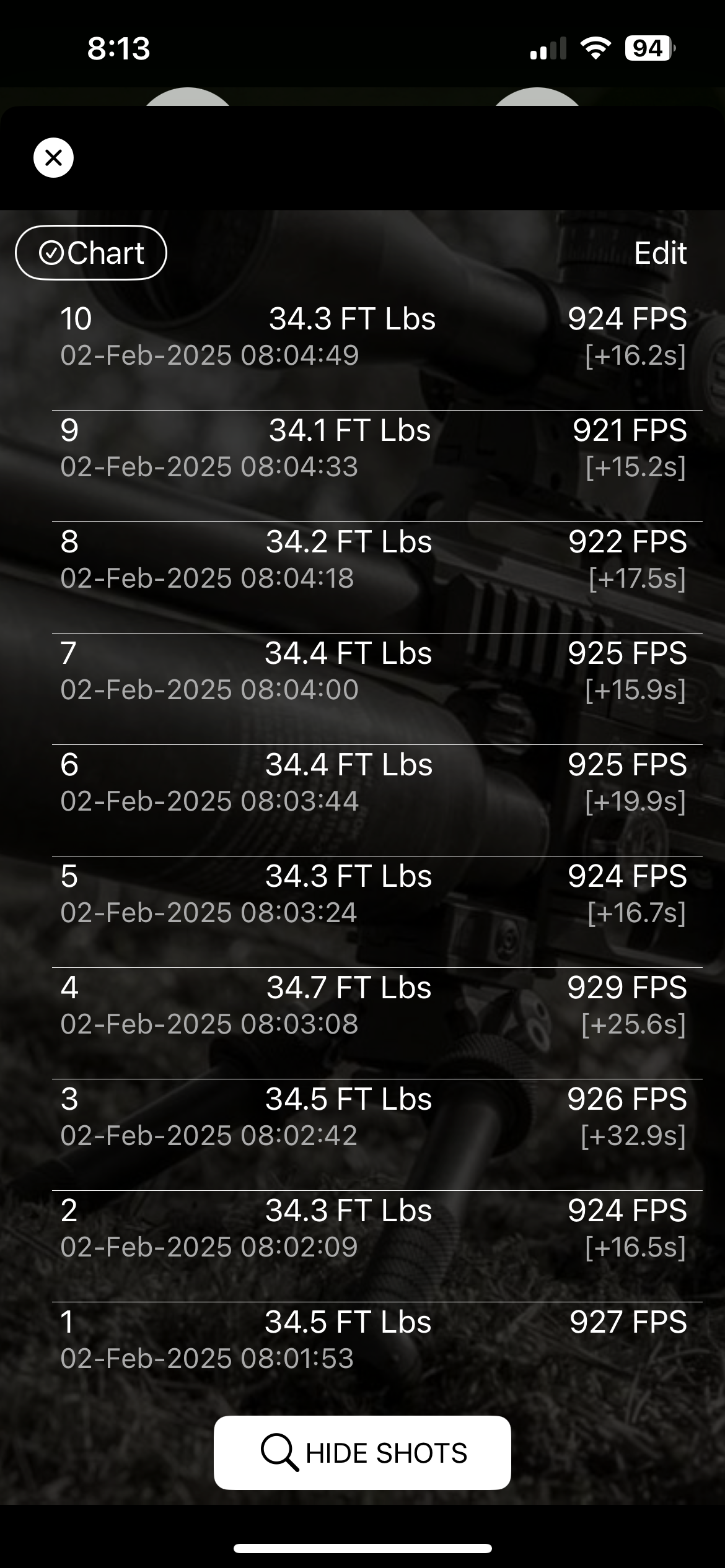

Yeah I’m gonna go the opposite direction. I’ll take chronograph reading with the VA as far out as it will go and then turn in 1/4 turn to see if speed drops and go from there.
Turns out it works fine for what I’m doing. I’m only shooting Hades 15.89g and the valve adjuster worked to pull my speed back from 940 down to around 925 just like I wanted. I guess if I was shooting slugs or heavier ammo I may need more adjustment on the valve, but slinging these Hades into iguana at 925 is right where I wanted to be 👍

Im at 105 bar on rear reg and get around 90+ shots per fill at 925 fps with the exact ammo I intended to use. It’s honestly a non issue for my use. If I wanted to shoot higher speeds or heavy slugs I’d get a barrel kit.
