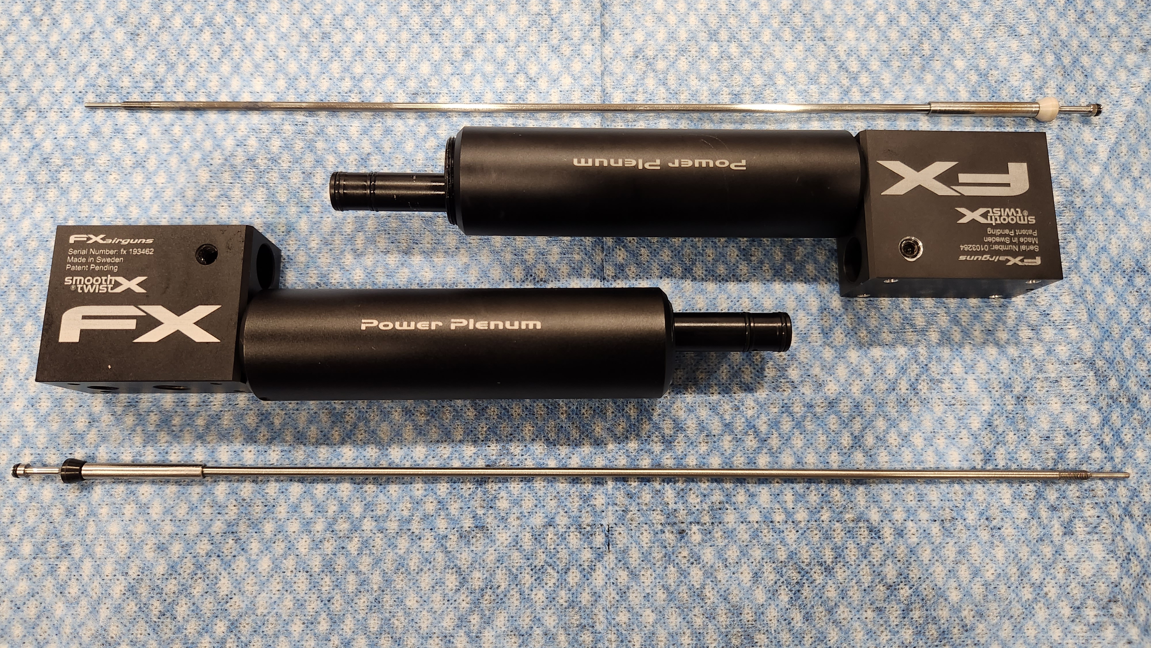

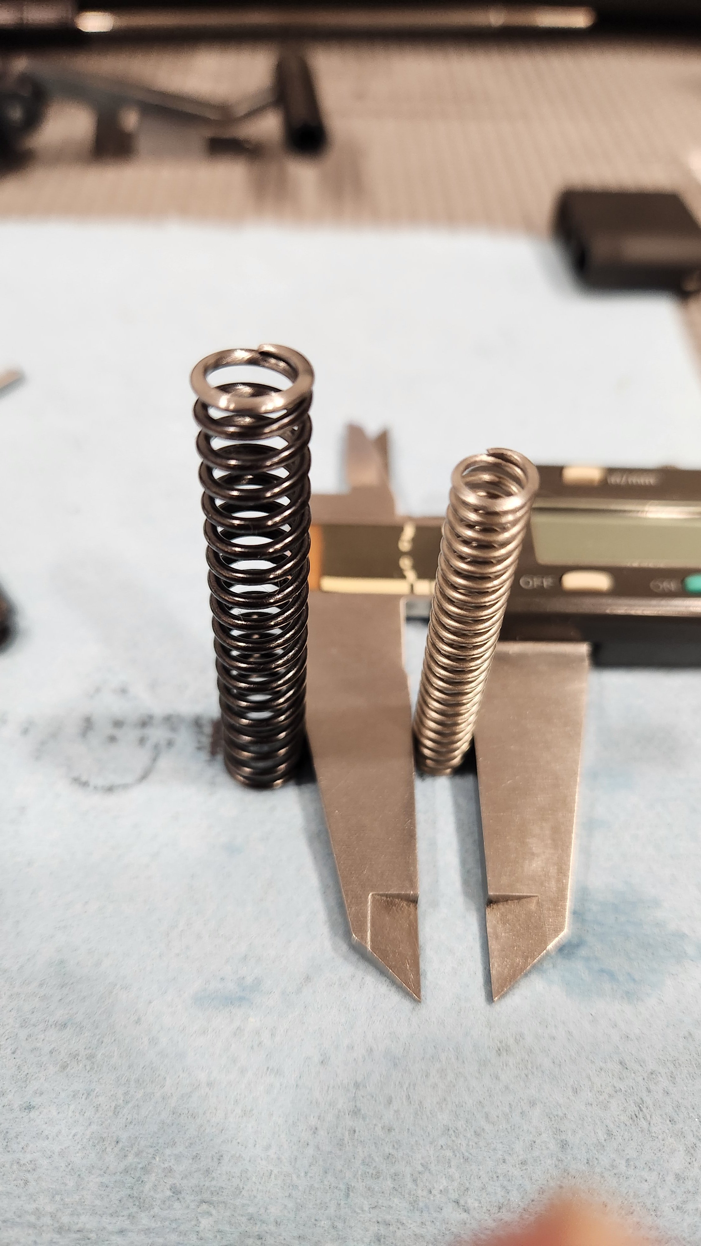

MK2 here
I have polished the Valve Rod to mirror finish, only the section about 20-30 mm where the orings travel. Also, polished both springs the ends to morph/twist easier. I am shooting BR, high Reg and short Dwell, and I am not noticing those extremes people talking about.
You can see in the picture how the upper rod is shiny? Also compare the spring ends:
Reactions: TheDaleness
That is superb custom work but not a solution that most of us can replicate.
Agreed: brilliant work mubhaur. Wish I had your skills and resources. When is FX going to hire you as a consultant?! I spend just as much time fixing my impact as I do shooting it! And through no fault of my own.

MK2 here
Awesome. Thank you for the detailed description and photos of your fix! bigHUN!
