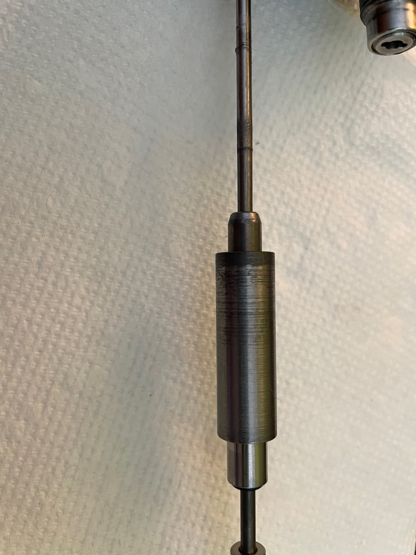

I disassembled the gun down to the valve rod and on the 2 inch section that slides in and out of the Valvetube End (part 10338) there was a grippy grey residue. This was from the o-ring (part 19768, O-ring 2.84x2.62 PUR90) in the valvetube wearing away onto the valve rod, perhaps due to just normal use, not enough lube being applied at the factory, o-ring shrinking overtime - likely multiple reasons.
I did several things to reduce valve rod friction. I did more than necessary. Most people experiencing valve rod friction could likely fix it by cleaning and lightly lubing the valve rod with silicone oil.

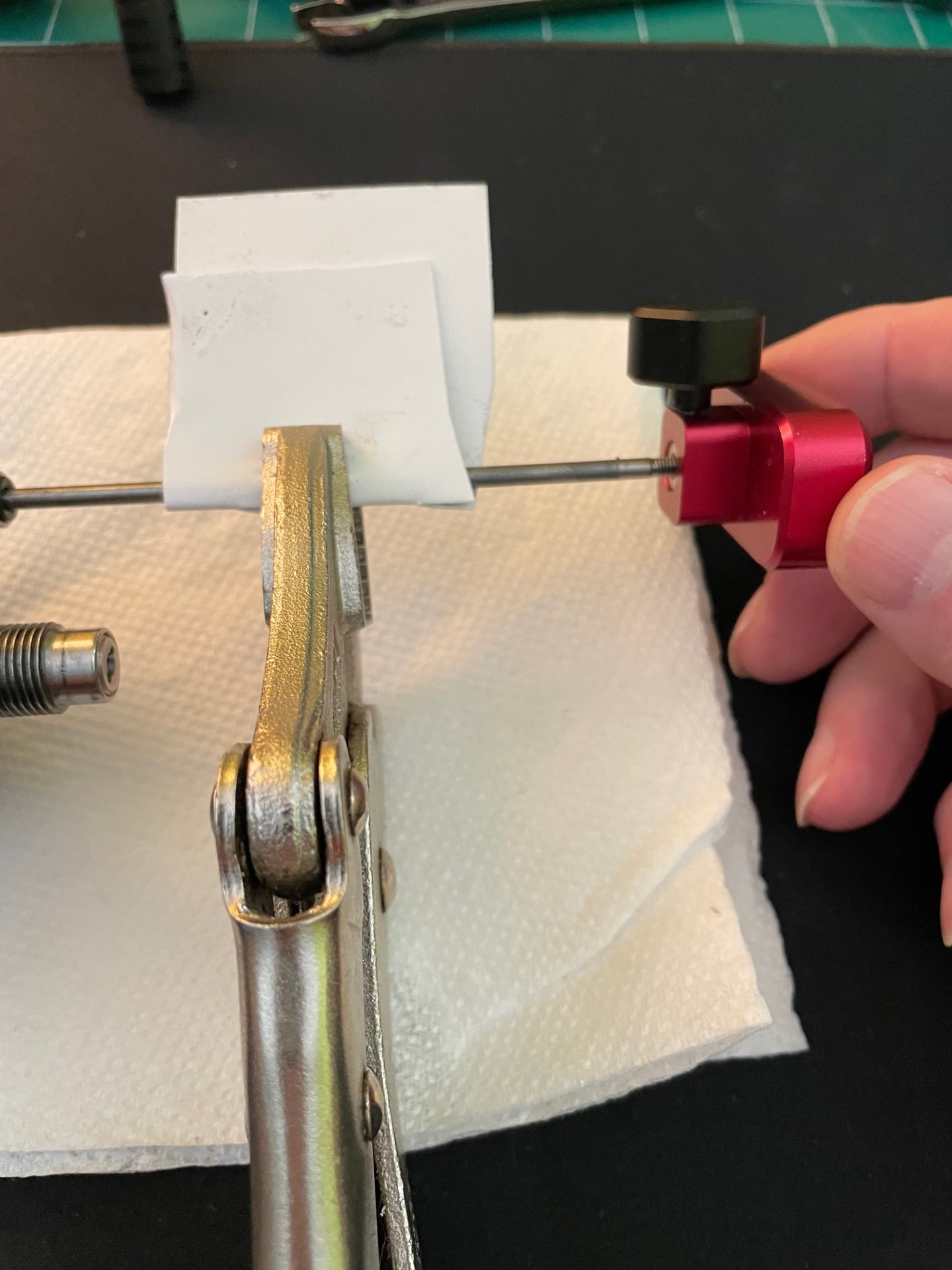

  • CLEANED the valve rod with rubbing alcohol
  • POLISHED the valve rod using a polishing compound and microfiber cloth to polish the valve rod until it had a shinny mirror-like finish. Took about 10 minutes. I used Flitz Multi-Purpose Polish and Cleaner, available on Amazon: https://www.amazon.com/gp/product/B000MUSOW4
  • LUBED the VALVE ROD with silicone oil.

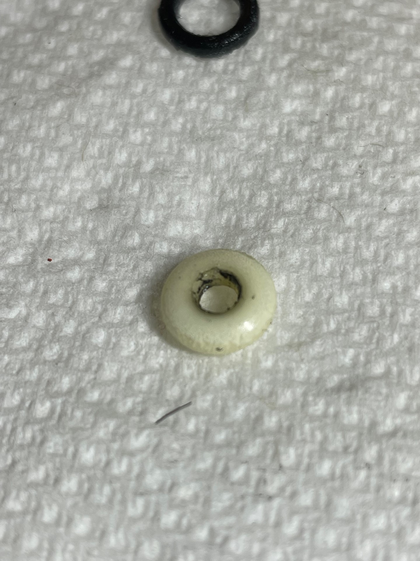

I took it apart to change the O-Ring and was amazed at how much grime built up on the valve stem rod. The O-Ring looks like it had better days for sure. I ordered some 3M polishing cloth and will give everything a good cleaning and polish.

It's working great!! Changed the O-Ring, cleaned and re-lubed everything and it has been shooting like new. Been doing random test shots since yesterday and no more issues. Just need to tweak the tune a little.
