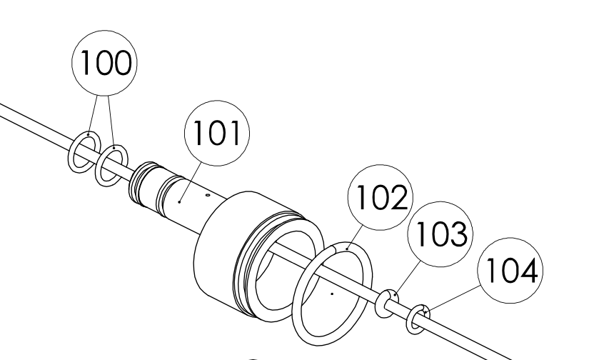

For reference here’s a link to the FX Impact M3 schematic:
https://fxairguns.com/wp-content/uploads/2021/04/F10370-Impact-M3.pdf

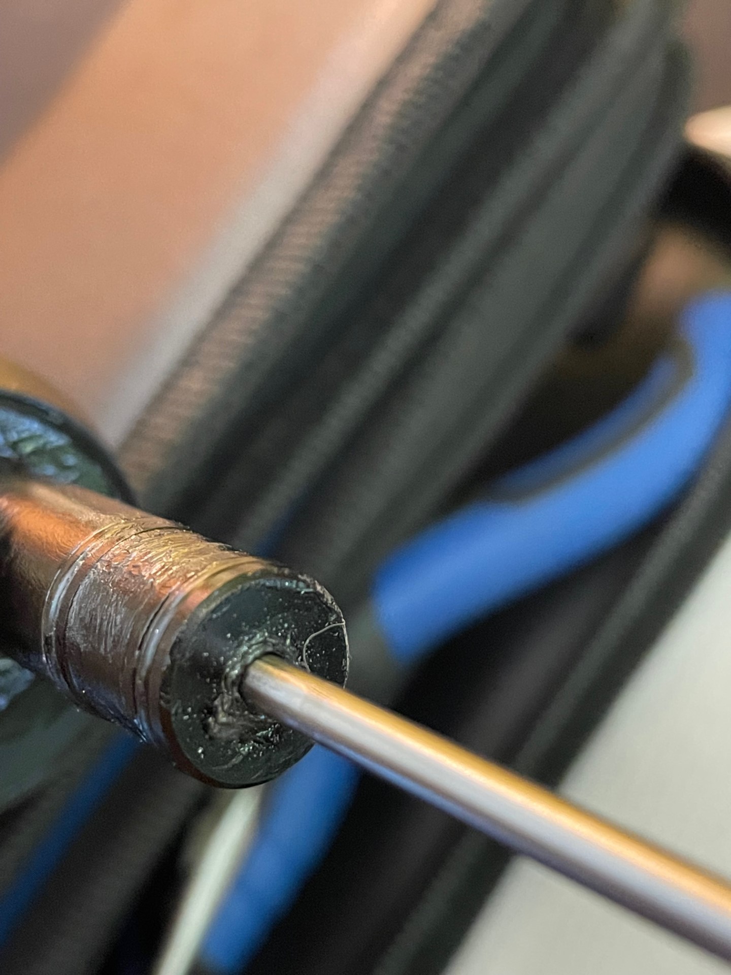

I disassembled the gun down to the valve rod and on the 2 inch section that slides in and out of the Valvetube End (part 10338) there was a grippy grey residue. This was from the o-ring (part 19768, O-ring 2.84x2.62 PUR90) in the valvetube wearing away onto the valve rod, perhaps due to just normal use, not enough lube being applied at the factory, o-ring shrinking overtime - likely multiple reasons.
I did several things to reduce valve rod friction. I did more than necessary. Most people experiencing valve rod friction could likely fix it by cleaning and lightly lubing the valve rod with silicone oil.

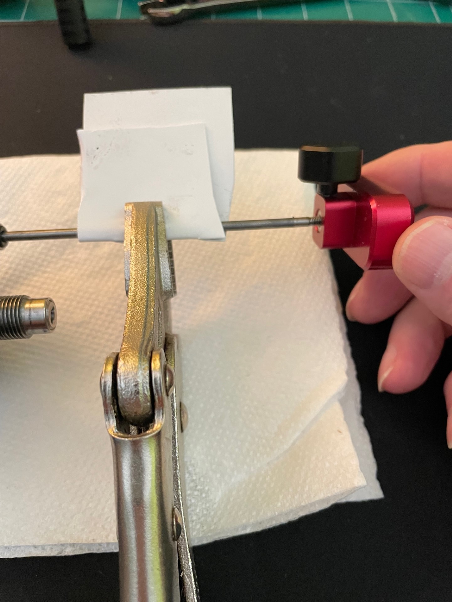

  • POLISHED the valve rod using a polishing compound and microfiber cloth to polish the valve rod until it had a shinny mirror-like finish. Took about 10 minutes. I used Flitz Multi-Purpose Polish and Cleaner, available on Amazon: https://www.amazon.com/gp/product/B000MUSOW4

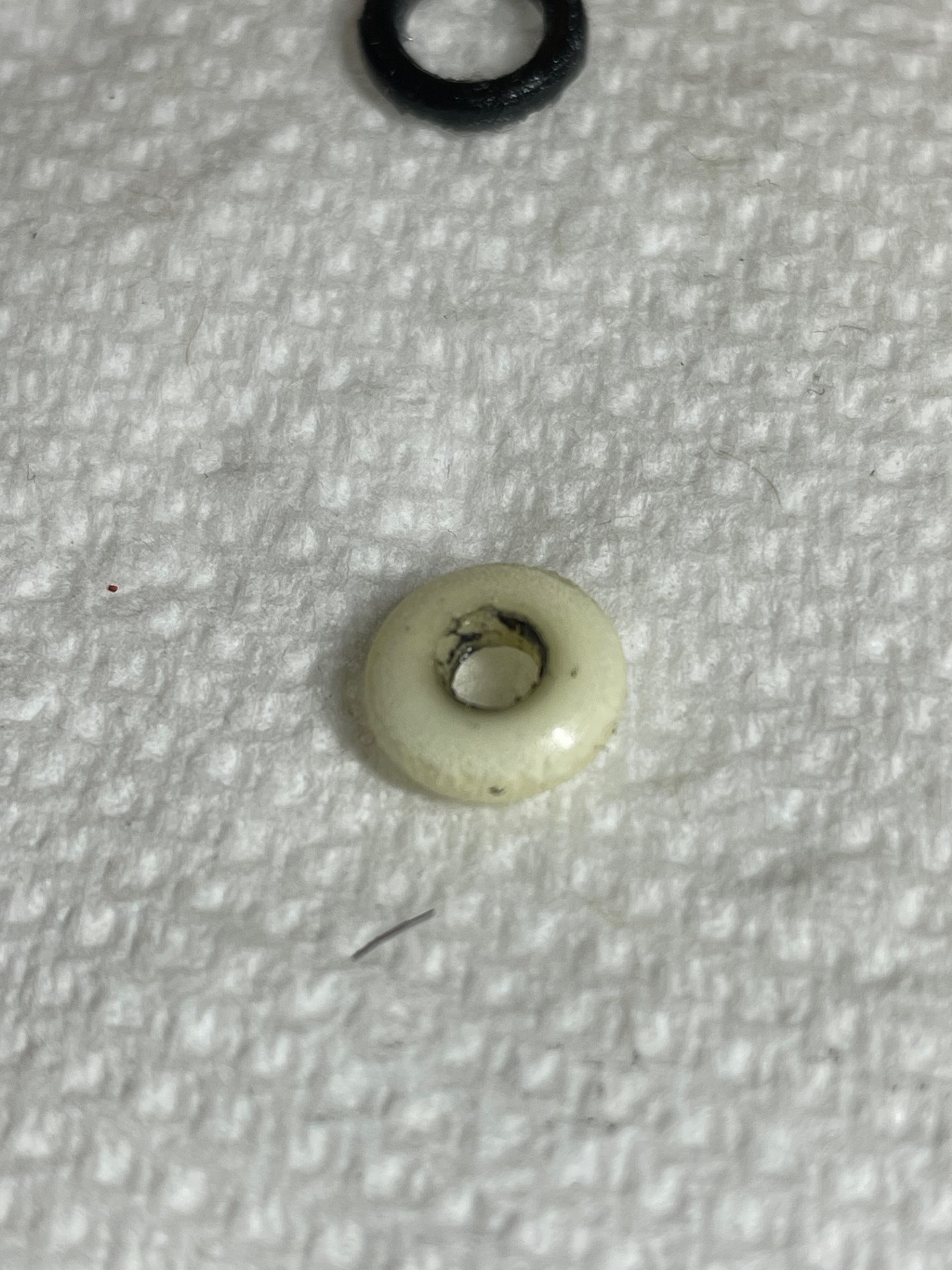

I took it apart to change the O-Ring and was amazed at how much grime built up on the valve stem rod. The O-Ring looks like it had better days for sure. I ordered some 3M polishing cloth and will give everything a good cleaning and polish.
View attachment 378522View attachment 378524View attachment 378525View attachment 378526

I disassembled the gun down to the valve rod and on the 2 inch section that slides in and out of the Valvetube End (part 10338) there was a grippy grey residue. This was from the two o-rings in the valvetube (part 19763, O-ring 9x1.5 NBR90) wearing away onto the valve rod, perhaps due to just normal use, not enough lube being applied at the factory, o-ring shrinking overtime, likely multiple reasons.
I did several things to reduce valve rod friction. I definitely did way more than necessary. Most people experiencing valve rod friction could fix it by cleaning and lubing both the valve rod and the two o-rings in the valvetube. Reassemble. Done.

  • POLISHED the valve rod. I used a polishing compound and microfiber cloth to polish the valve rod until it had a shinny mirror-like finish. Took about 10 minutes. I used Flitz Multi-Purpose Polish and Cleaner, which I also used to polish the inside of the barrel liner. Polish available on Amazon: https://www.amazon.com/gp/product/B000MUSOW4

I do not recommend any lube on the plenum oring as it may leak. What is more it can introduce inconsistency due to the fact it is impossible to keep the lube evenly distributed after each shot.
Which plenum o-ring/s are you referring to?
