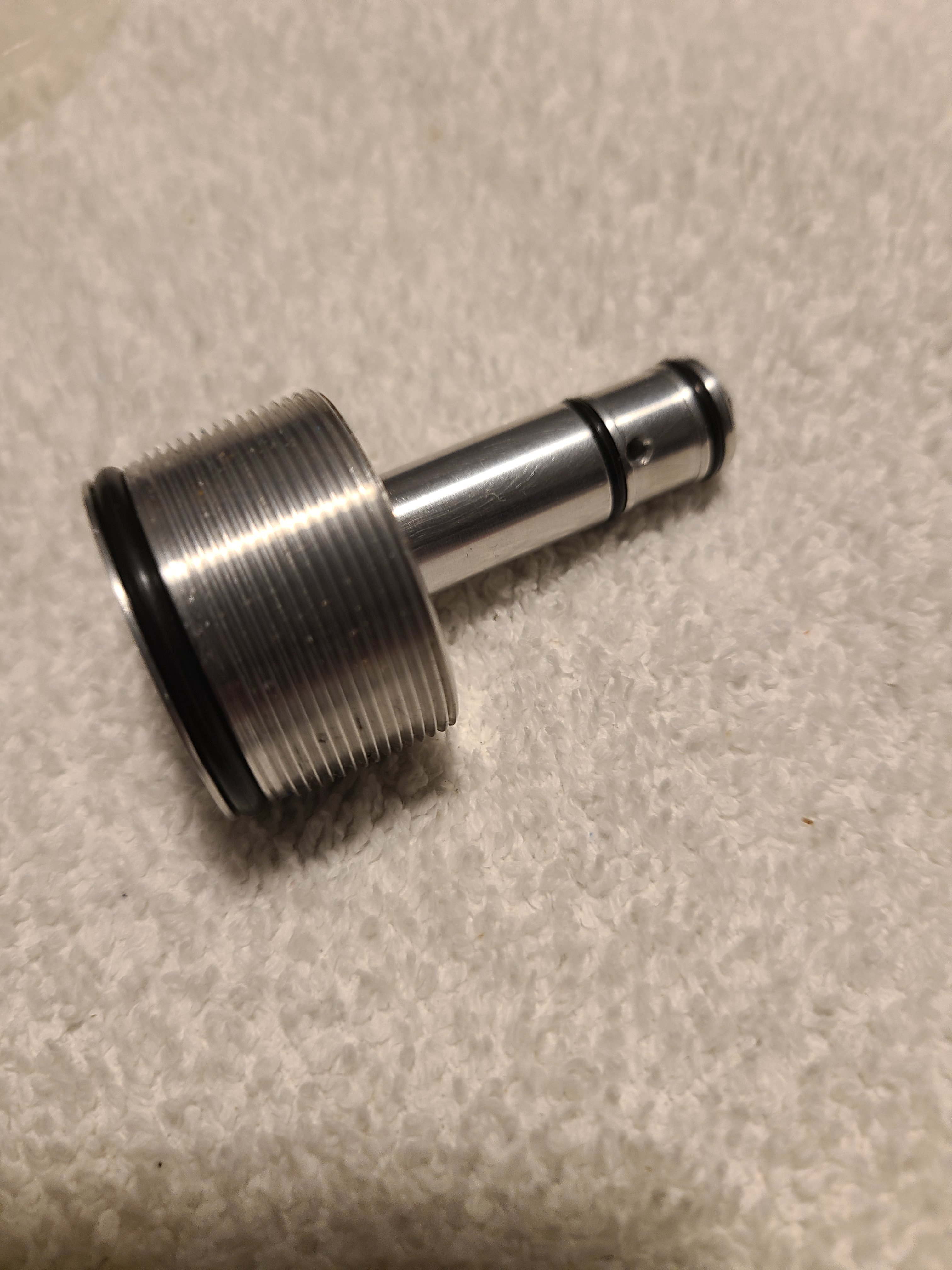

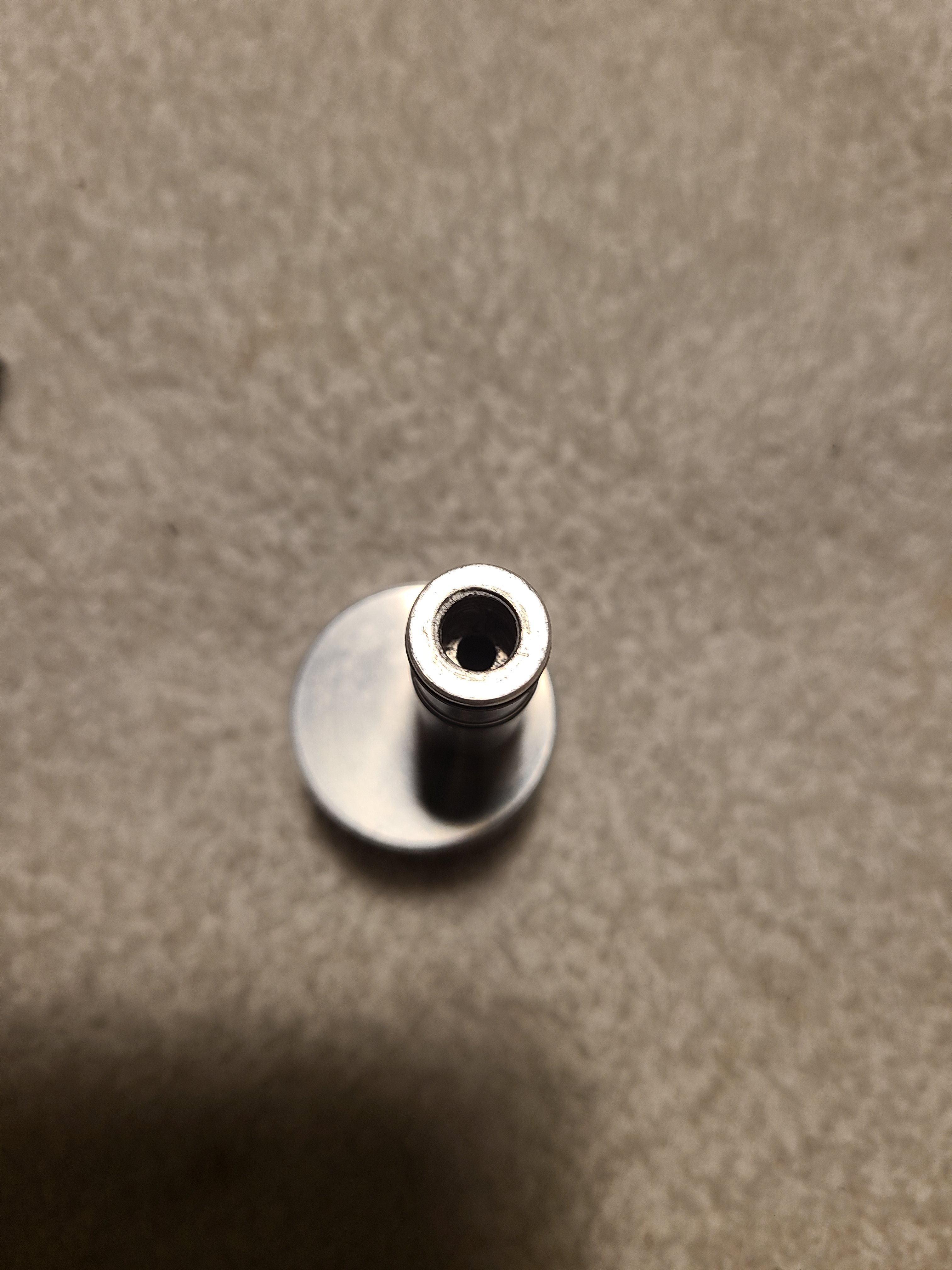

he also has a plenum like the one pictured above there being done on a 5-axis machine and have a round thumb tryp screw to remove the o ring
rather than a nut has a peek bushing inside the thumb screw that screws on the top really nice piece
he said about 4-5 weeks they will be ready i said put my name on one of those plenums and a valve rod and i will take a few plenum o rings for now.
he said try these o rings you may not need the plenum or rod but i want them anyways so i gave him a deposit.
long story short installed these new plenum o rings in my m3 and m4 using only a very little Supe lube multipurpose silicone grease.
all i can say is WOW 1st shot 890 the rest 901 902 right to the tune my 25 Cal same thing 1st shot is down maybe 8-10 fps
then its right on tune both guns very impressive, here is a pic of the plenum real nice guy definitely has fire under his butt
his o rings worked maybe some of you with this issue should get in touch with him fixed my guns that's all.
