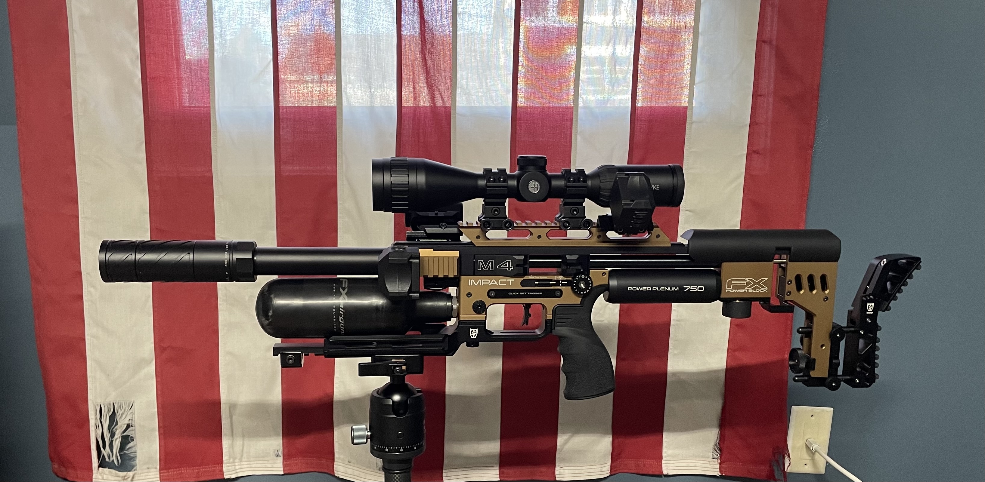

I bought m4 impact compact.
First off. Amazing air rifle.
Needs a lot of adding
Add in’s for me to be comfortable but that’s me.
Upon arrival I found the air rifle, cocking didn’t catch correctly and also wanting to jam right out of the box factory tune, and also it was touching a little bit to where it was kind of hard to cock. What I found was the barrel was not in the right position, it wasn’t even screwed down. I actually just lined the barrel up correctly and it slot making sure it was the correct way for pellets and tightened it ever since then it’s shot like butter. I mean it’s absolutely so smooth and amazing but yeah, the quality control was not great. I found several loose screws bolts
But with anything I kinda go over it all. Make sure it’s OK and everything is tight the way I like it , but it’s amazing. I highly recommend it. I do recommend the 600 mm barrel for the bottle size does not matter much but the 600 mm barrel on the compact tank is just an amazing hunting gun. I have 22 and 25 caliber.
