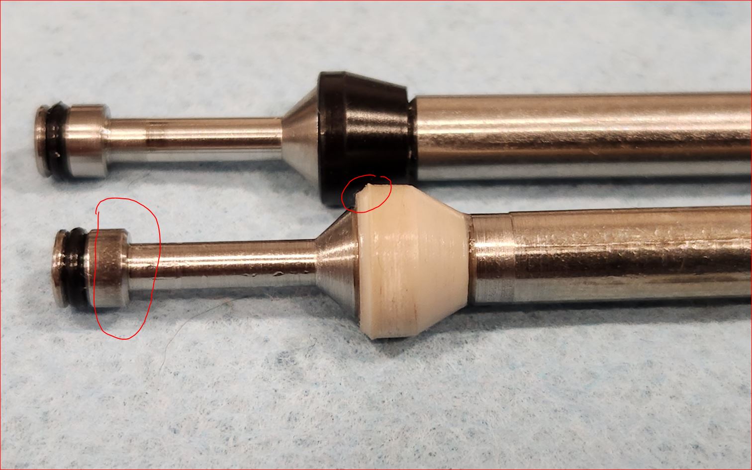

I really cannot remember when was it that I sourced to a friends shop to replace the black plastic to peek on the valve puppet. I am seeing my pictures taken early 2020, so that means two year full seasons this peek valve was working hard. That is roughly about 20K shots or more.
This is how it looks today...
I circled on the valve part the area where the peek started deforming, so that would need to replace.
But the cylindrical part beside the 2mm oring that shows wear, same inside the hole... I inspected with a high power jewellery loupe.

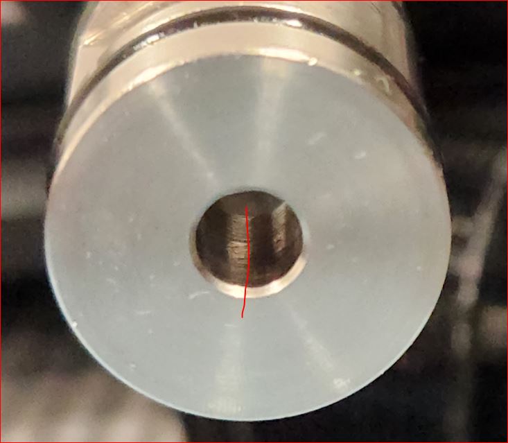

This hole is worn as well, not shiny anymore but visible that the two metal parts seize.
