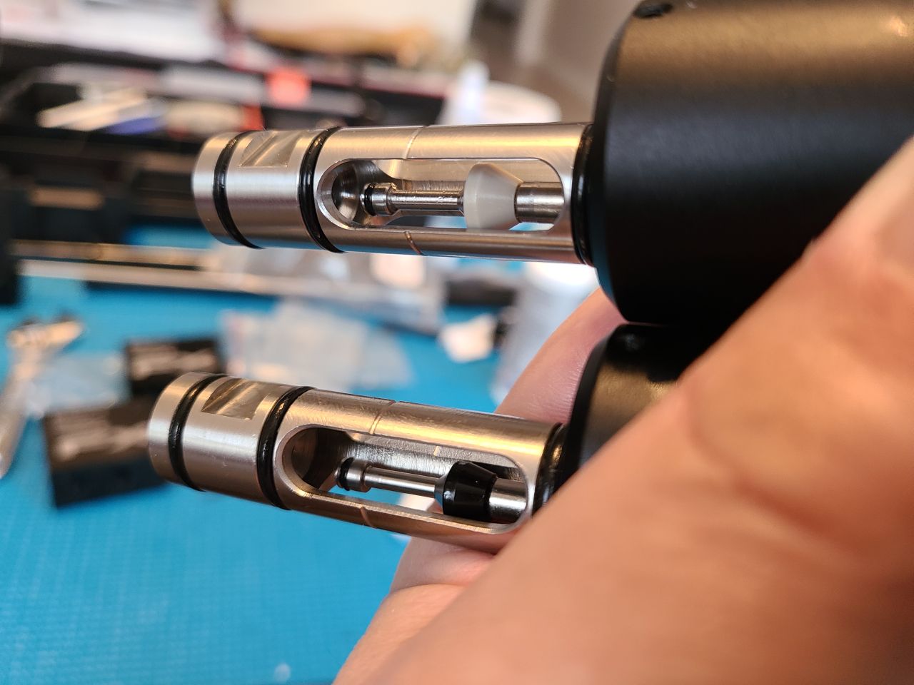

This what I did (w/o 720 plenum, I still have the original PP). I didn't wanted to alter the original parts so I ordered new parts everything to have a spare.

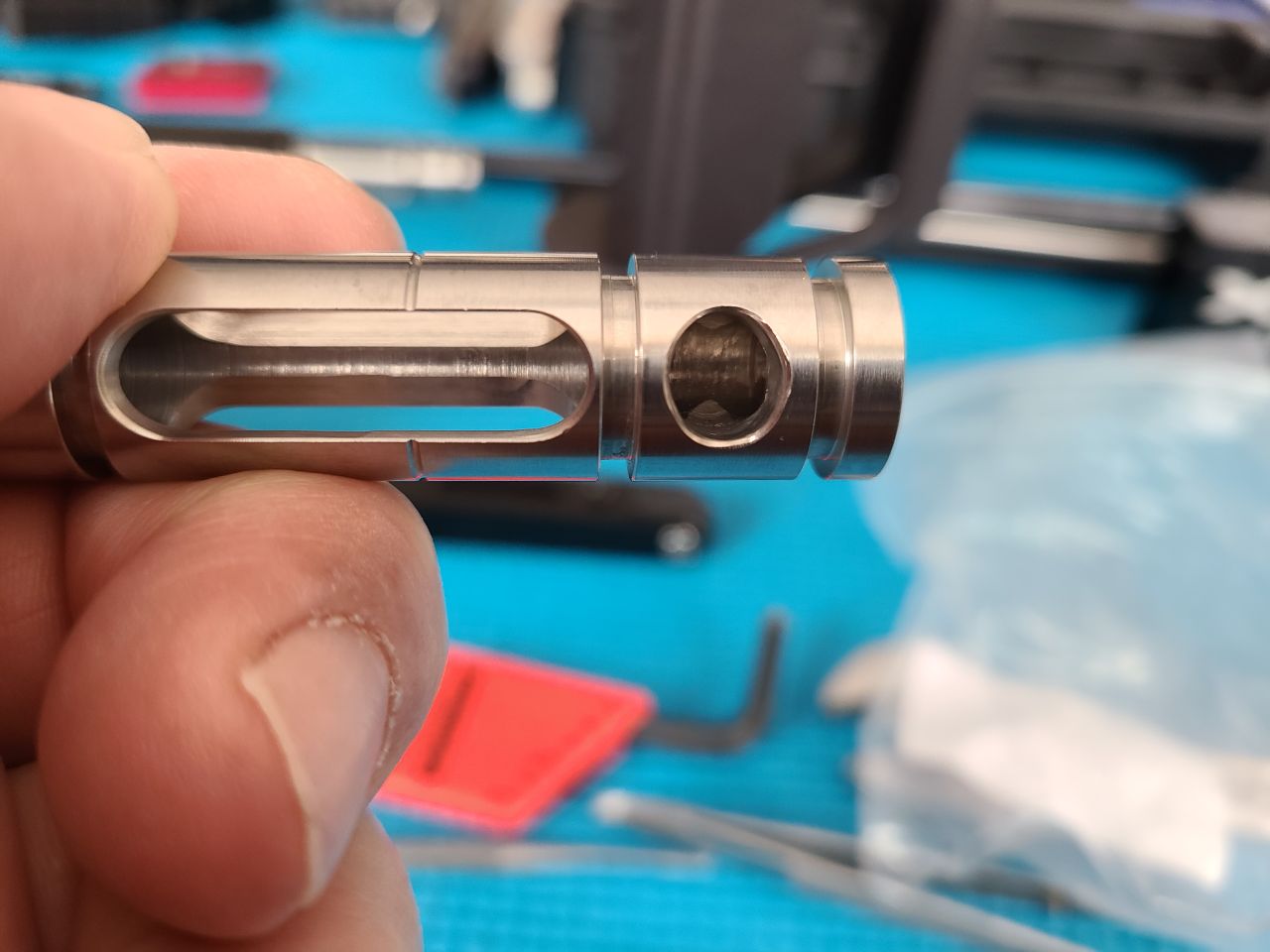

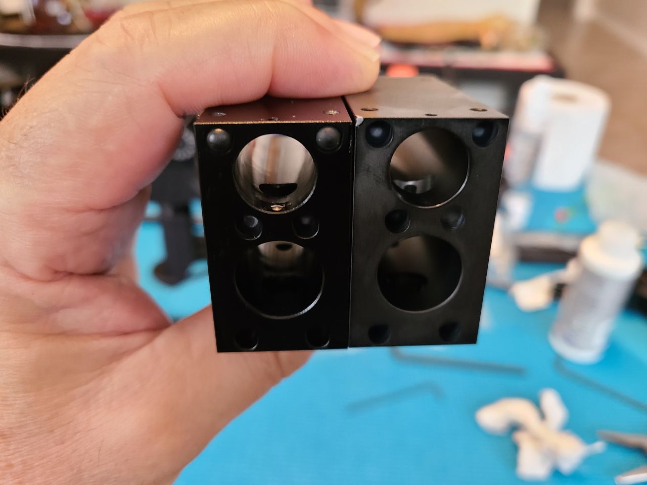

The grub screw at the bottom of the RearBlock is M8, so the drill hole before tapping is 6.8-70 mm.
I toke a cylindrical carbide bit I guess it was close to 8mm OD.
On my MiniMill I converted a 6.8 mm hole into a 8x9 mm slot.

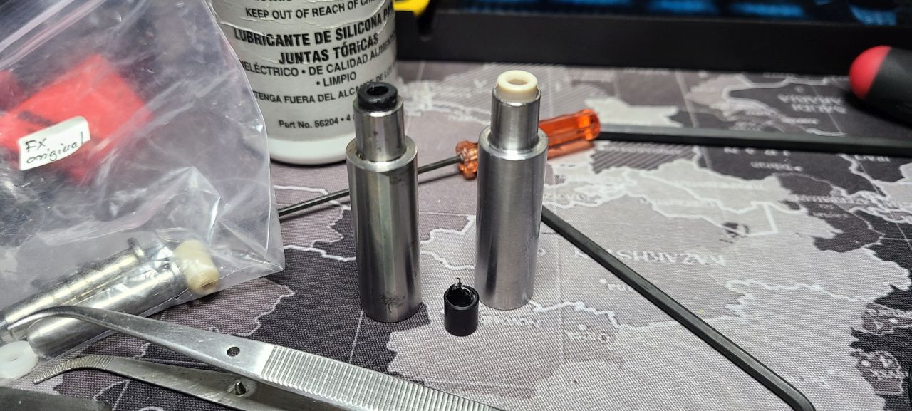

But ones I had the parts in my hand, I re-drilled the ValveHouse hole from 6.5mm to 7.3mm ID, also mirror polished the cone (you can see the shine in the picture). Also recut the transfer hole into the same slut as in the RearBlock.
A friend of my cut a peek poppet on a lathe for me.
Also, I replaced the delrin puck with a peek on the Hammer nose that hits the C1.
With these changes I have unrestricted the air path, the power increase is enormous:
.25x700 Superior Heavy, original PP, Heavy HammerSpring140 bars on the Reg propells the 44gr ZAN with 1020 fps, and still there is about 2mm travel on the HammerSpring slider. I never went into investigating how much really max power I can get.
