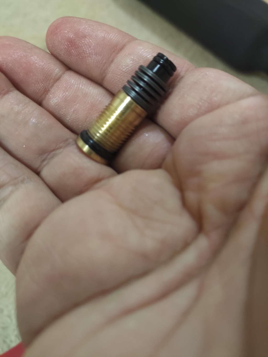

I decided to clean my impact and reseal the regulator. I found out that the washers are set different from pre power plenum impacts. I'm not sure if it supposed to be like this or is it a mistake made in assembly.
Thank you FX-USA. The regulator is working flawlessly, small creep when gun left for a while doesn't bother me. I just wanna know if washers has been set differently in latest variation of the impact.

I am going to extend the answer to your question a little more that what FX or any other company would do...
Power Plenums and MKII's have the same AMP regulators...There are normally 10 washers in this configuration: ()()()()() but keep in mind that the stack of washers needs to be of certain height to properly/efficiently move the piston, and NOT all Belleville washers come with the same thickness (We own a lab and use plenty of these washers and different batches slightly vary in thickness and in force).
Factories (this applies to all factories) pre-test the regulators outside of the gun and then a final test is done once installed in the gun; if the stack height is not met, the piston will not operate properly and the factory either adds a flat washer (Very common in Steyr guns) or they add another Belleville washer in the opposite direction of the last washer (Mostly all companies other that Steyr do this) so the compression force is basically not affected in practical terms.
Another fact is that not all regulators will be adjusted to the same pressures, and certain number of washers set in a particular configuration for the compression force required are used or certain BAR pressure settings...For example: HUMA uses 10 washers for their LOW pressure Gen III regulators that replace the FX AMP that you have in your gun, but then HUMA also uses 12 washers for the very same regulator when more power will be needed, and they call these regulators HIGH POWER...Same everything, just 2 more washers...Tip: Anyone wanting to buy a LOW pressure HUMA regulator will be better off buying the HIGH PRESSURE in order to get 12 washers and install 10...No price difference between high and low pressure HUMA regs.
Going back to the FX-AMP regulator... .177's will usually be set in between 80 and 100+ BAR, .22's from 80 to 110-120 BAR and .30's will usually go to`140-150 BAR and sometimes higher...So very likely the factory is using 10 washers for smaller calibers and 11 for high pressure in larger calibers set at 140-150+ BAR...There is no such thing as ONE REGULATOR FITS ALL BAR PRESSURES!. Of course, you can set a low power regulator to HP up to a certain point, but it will not be consistent/efficient and the same applies backwards: A HP regulator can be set to lower BAR pressures up to a certain point, but then getting out of the efficient operating range makes the regulators erratic and not efficient...
In conclusion: Your reg has 1 extra washer because of the thickness of the washers as explained above, or most likely because your gun is a caliber that will generally require higher BAR settings...You mention that your reg is working fine, so remember the old say: IF IT IS NOT BROKEN DON'T FIX IT! ...Just carefully clean it and lube it! 😉

You are absolutely right in everything you said. My question is why are these variations? Are they designed and tested? Which one should I follow when I rebuild these regulators?

The original design of the FX Impact did not contemplate the power/velocities that the current market demands...A MK1 originally was able to shoot competively (power/velocities) but after the last 2-3 years the velocity/power curve went exponential and this is why we have seen many iterations of the same gun...The market is changing rapidly towards more precise guns that can shoot at very high velocities/power...FX changed its regulator's piston to a longer one in order to get higher pressures (MKII) but then there were other guns shooting faster at the same pressures...FX reacted accordingly and introduced the larger Power Plenum at the end of last year.
Regulators are not tabu, they are simple valves that shut off with the force of a coil spring or Belleville washers, the later are more efficient (space/size vs. force) than coil springs and this is why they are the industry's prefefrence. If you assemble the washer stack (11 washers) like this: (()()()()() or like this: )()()()()() the difference in pressure will almost be negligible, the higher end will probably go 5-7 extra BAR and the lower end will stay the same or go slightly higher...Does it really matter if one regulator goes from 80 to 150 BAR and the other goes from 85 to 155-157? (rough estimate)...I really don't think so, adjust two identical HUMA high pressure regs and you will find anywhere from 3-6% discrepancies in the adjustability range.
Manufacturing companies are in constant R&D changing and trying new settings, systems, sub-systems and designs and if for example the second washer array above in combination with x.y.z changes/new components provided the best efficiency/power/precision, from there on the washers will be arranged in that manner...I have probably helped 10-14 friends shooting the Steyr LG-110 guns, I own 2 of those purchased 5-6 years apart...All I can tell you is that over the years their regulators have remained the very same design, but the washer configurations (number of washers/flat washers/force/and washer accomodation order) have changed at least 3-4 times...Same gun, same power levels and the only differences if any were different barrels...
What you found in your gun (reversed washer) is NORMAL for a dynamic company such as FX....And if it were a mistake, it will affect zero...So why pay attention to it or try to find the exact motive for the switch?
Can you turn around that last washer?...Of course you can!...Should you turn it around?, well, if the gun is working as intended, then why switch it?....I can assure you that you will get the same pressure you currently have and that you will not notice any difference in performance or precision...I machined several Titanium and Brass pistons for this FX amp regulator and the only difference other than the durability of brass and Titanium over synthetic is that given that the synthetic piston is lighter, the recuperation time in the original unmodified regulator is faster...Does it affect the shooter to use a brass or a titanium piston? Of course not, any of those materials will make the regulator recuperate faster than the anyone can shoot...You are talking a few milliseconds.
Our guns have evolved much in technology, but some shooters complicate the technological advances by looking for ghosts and things that don't exist...I know very few people that after messing around with their guns are honest enough to say: "I screw up the gun, it is my fault and not the manufacturer's" ...But then I constantly read shooters saying: "FX regulators creep", "FX regulators are not good for a $2,000 gun", etc...The truth of the matter is that ANY regulator will creep if you don't know what you are doing and mess it up...Regulators are not designed for setting them up-down-up-mid point, etc...Regulators should be set from low to high and should be left alone!...If you need to re-set it to a much lower pressure, the regulator will most likely creep and you will have to rebuild it (specially the set screw back pressure seal).
I don't know of any company that produces 100% perfection, guns are machines and machines are succeptible to fail regarding price, but I can assure you that 90-95% of the issues are ignorance or stupidity on the shooter's side. I have been shooting air guns, rimfire and shotguns internationally at very high levels since 1967 and in more than 50 years and hundreds of guns, I have never ever had a high end gun that came defective or with major issues...I dissassemble each and every gun up to the last pin/screw and put them back together...In the precess I learn how they work and improve or modify whatever is needed to suit my needs...But the difference is that I KNOW WHAT I AM DOING and I don't look for ghosts.
In conclusion: Get your gun, shoot it 2-3-5,000 pellets, learn it thoroughly while it settles down and then consider making changes to how you received it from the factory...The factory knows better than most shooters...Before making your changes STUDY what needs to be done and how it would affect the rest of the sub-systems, and don't forget to take notes/photos so you can reverse what you did. As simple as that!

Thank you AZ. In my experience, most recent impacts with amp regulator come with 11 washers and set like )()()()()() . If you can see mine it's set like (()()()()(). And you are right first 2 stacks from the right are usually thick washers.
I had regulator creep so I polished the piston and screw pressure adjuster and it's fixed the problem but I assembled the washer like
()()()()()( And it was very slow recovering I tried a lot of stacking i found this
(()()()()() The most efficient quick recovery regulator pressure set to 130
