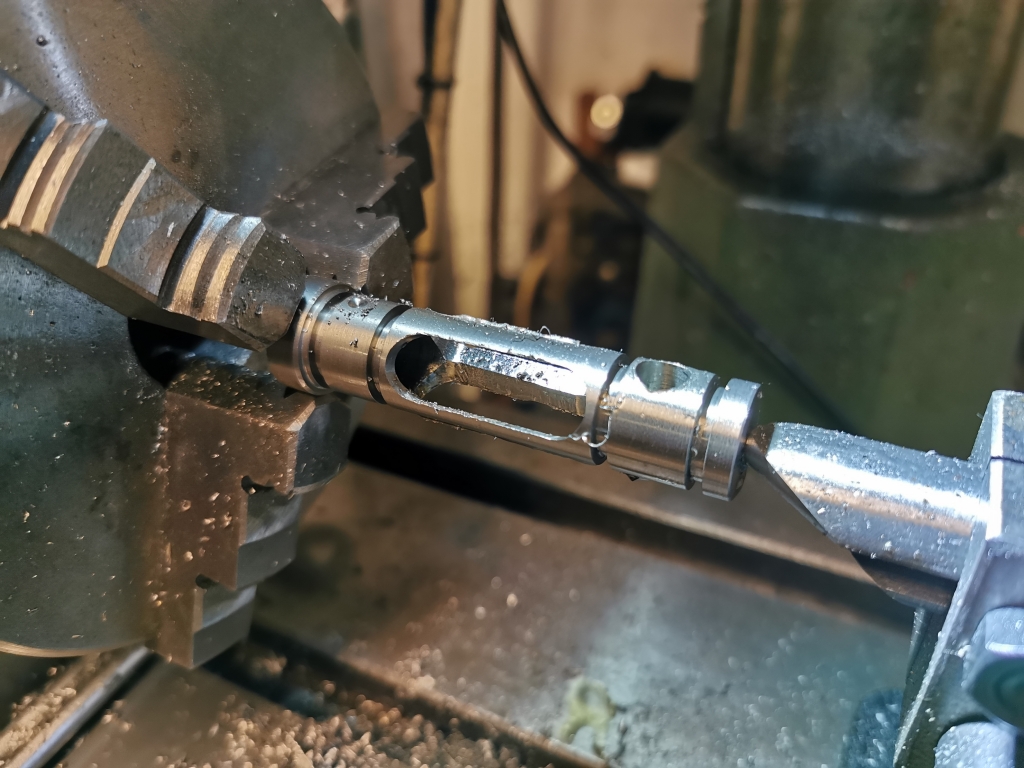

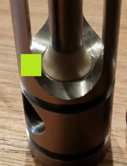

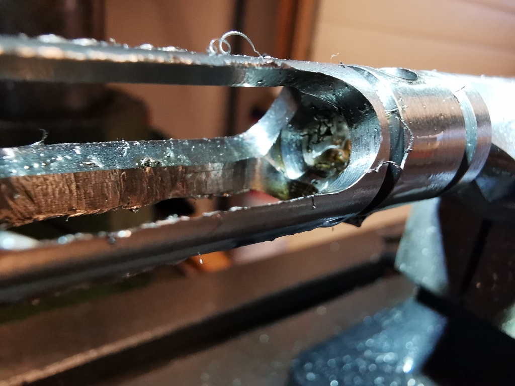

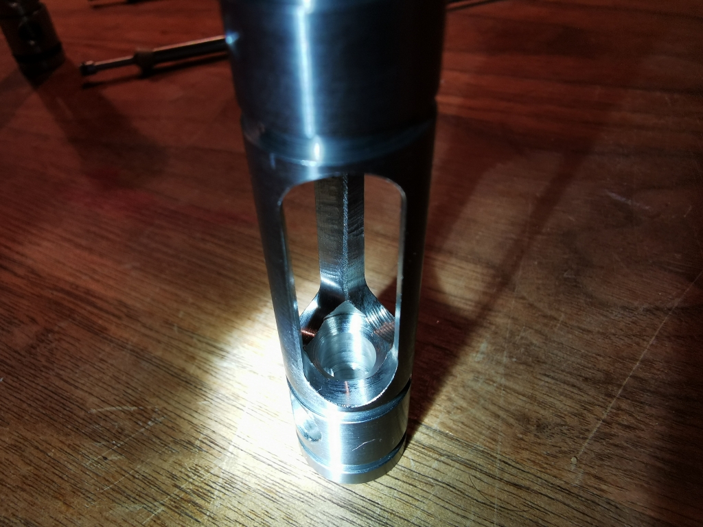

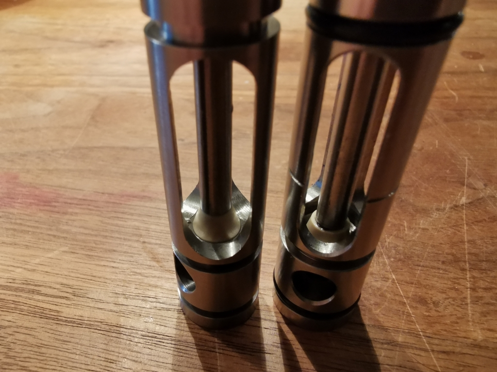

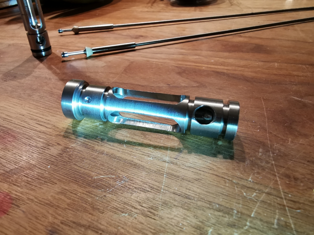

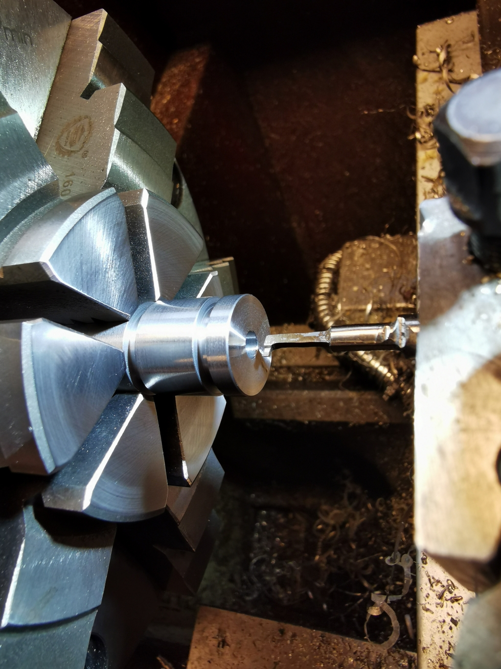

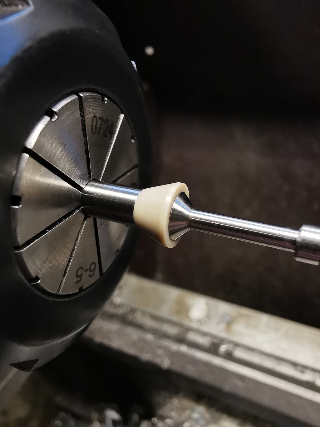

Did some more modifications to the 7mm valve housing, set the valve seat about 1mm deeper (I've ground a dedicated 10mm drill into a 90 degree angle with my drill bit grinder for the valve seat), and I also removed some more excessive material around the valve seat as well.
With this combo, I've hit 103 joules (76 ft/lbs) in 22 caliber with JSB Beasts, but I am looking for more. (nothing new here
I was happy to see that I got 294m/s with 34 grain beasts at 140 bar reg pressure, so the performance at low reg pressure is pretty decent. (95 joules or 70 ft/lbs)
