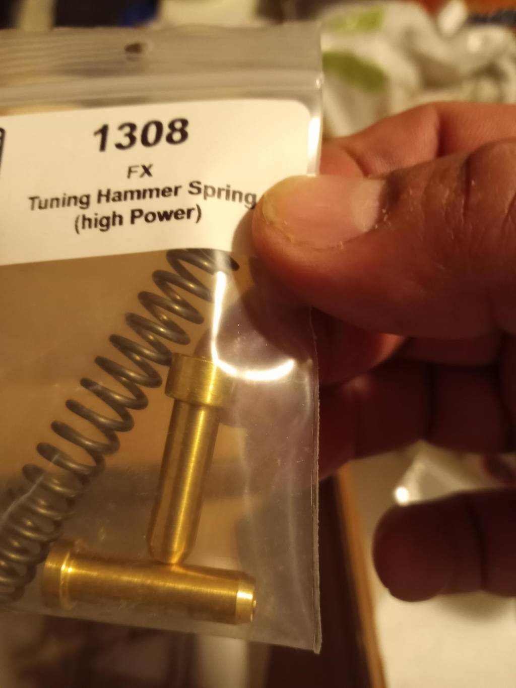

Has anyone tried putting huma 35 power kit on their 30. Man the spring I can barely compress the spring. Currently not messing my setups. But I'm thinking maby after spring season.
Any idea how much that top one weighs? I’ve made a lot of those and by the size of the head on that sucker, she is real heavy? 14-18 grams maybe? Wow and you get the spring shim from that also! That would probably open the valve at 170 bar+? Guessing.
