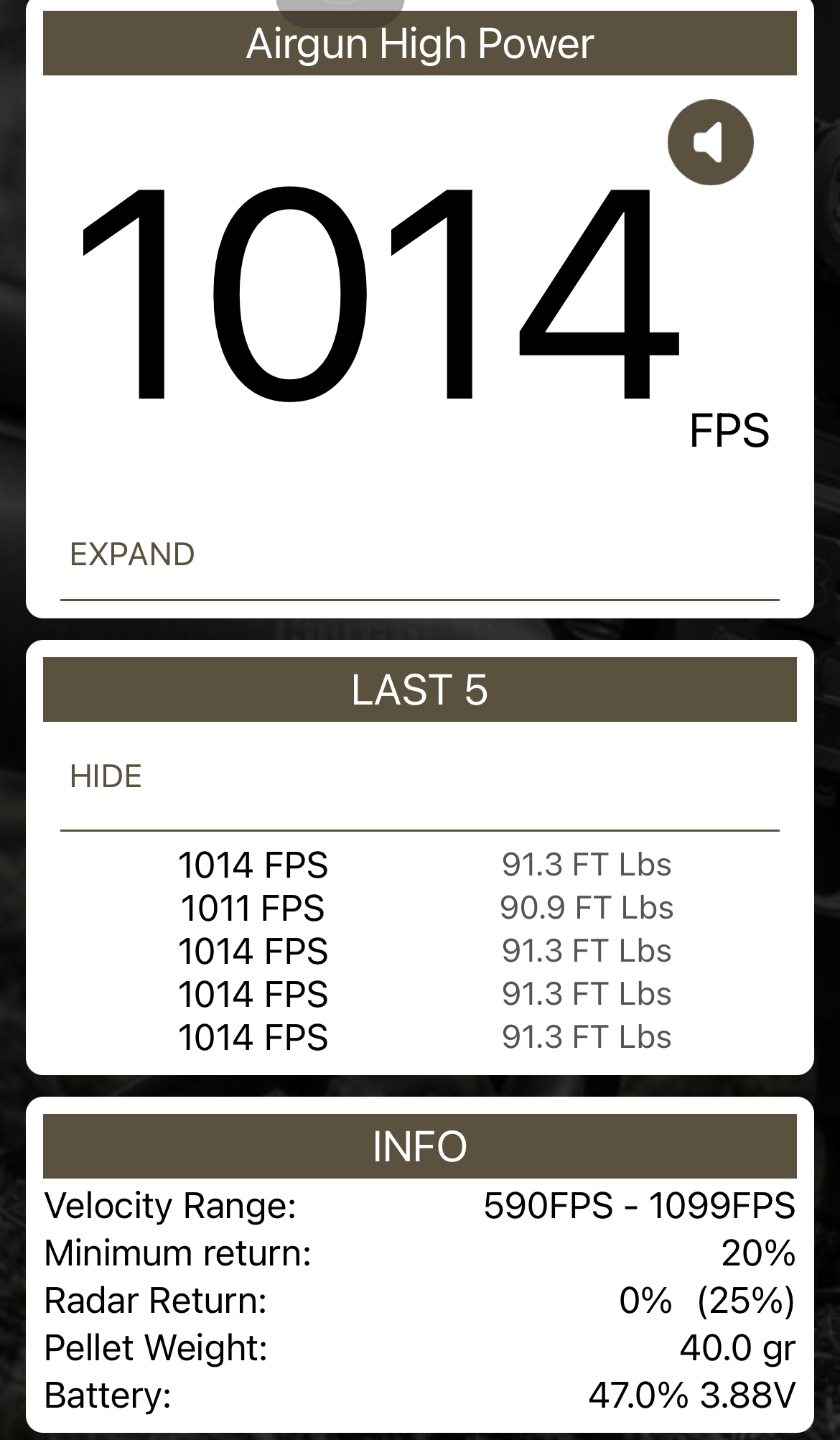

Testing all the bolt ons, 800mm barrel, power block, hammer, etc,today but don’t have improved regulators so setting rear close to 165 - 170 and getting 1014 fps, there is a long wait between shots b4 the rear is back on pressure. These are the speeds for 40gr .22 at the moment. Will test accuracy in the morning and post

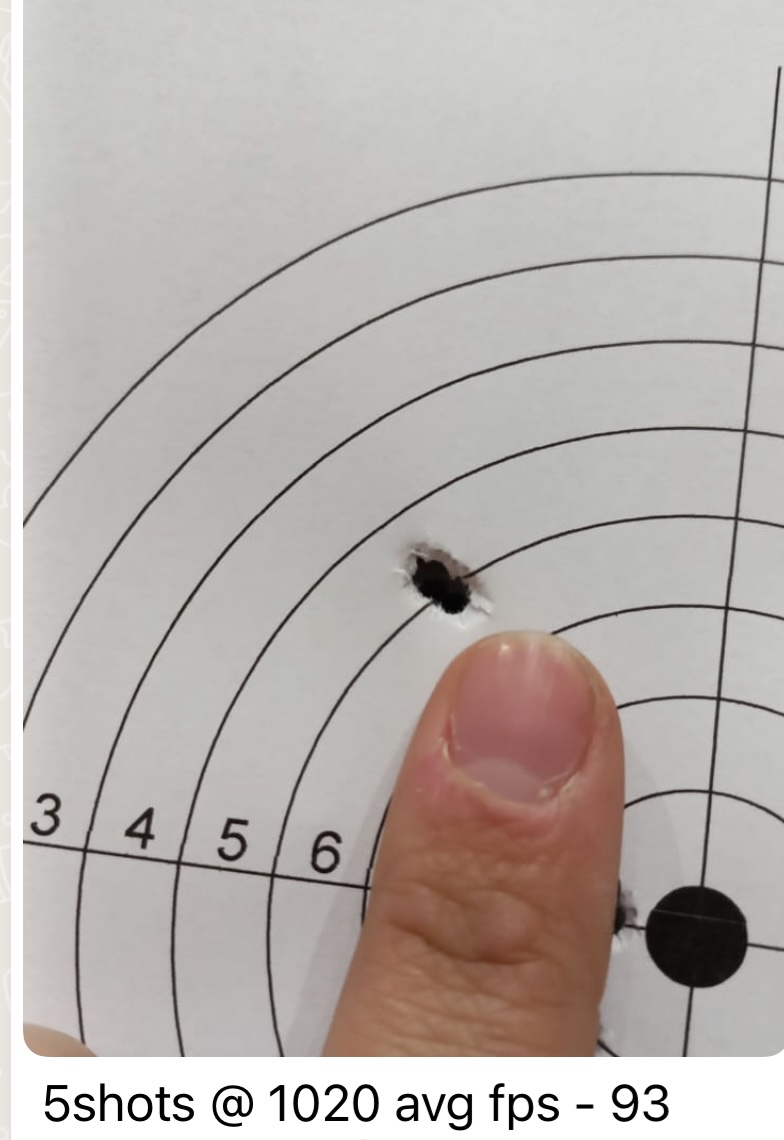

Not a .22 but a .25 x700 Superior Heavy. @ 141 bar on Reg 44gr ZAN 1050 fps and still about 2mm play on the HS tensioner. 46 ZAN 1020+.
And finally I decided going back to pellets, not happy with slugs POI at all @ 100 meters. These days reversed the power and the re-tunning for pellets is scheduled for a weekend. My dream was wrong, I wanted the slug shooting machine badly, and just a disappointment after a half a year and $$$ spent trying.

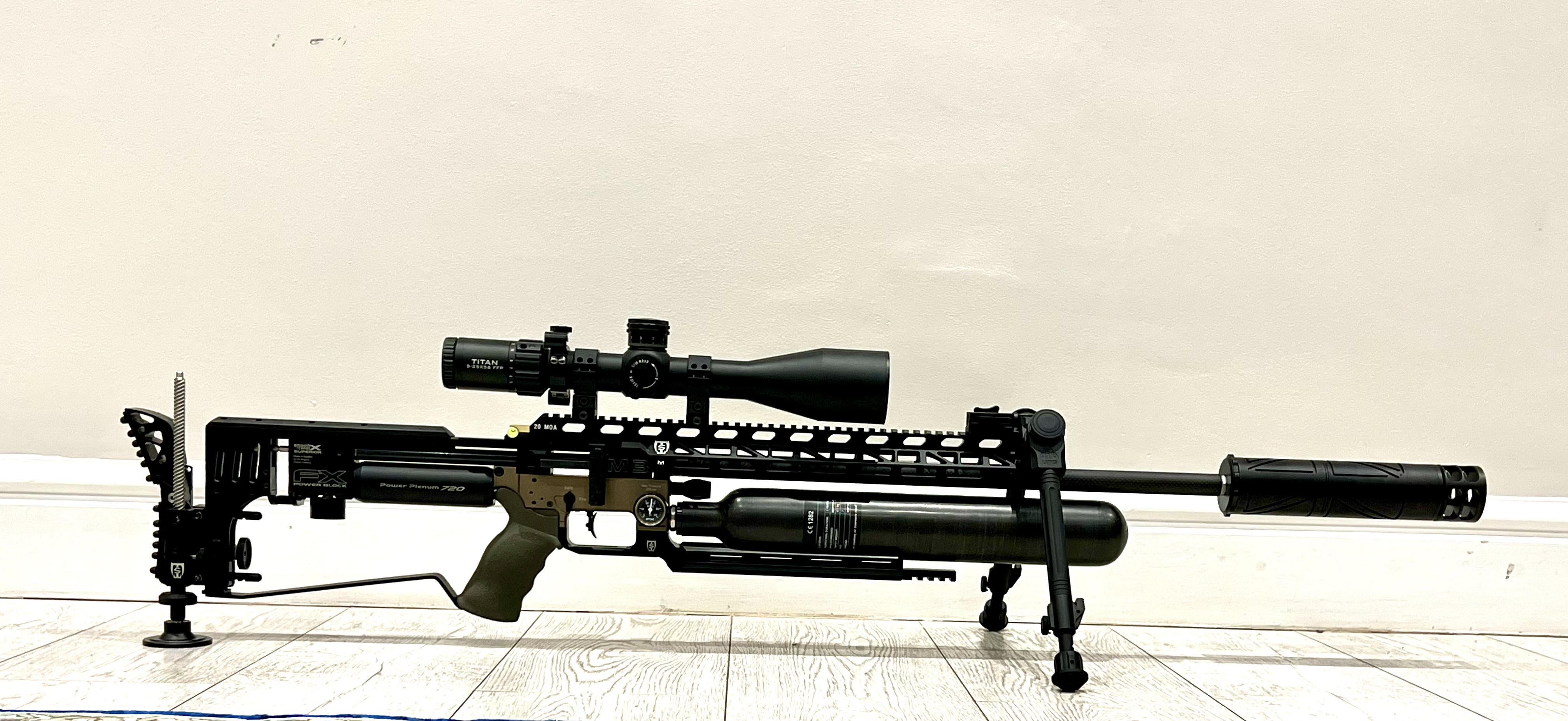

Hey, I found that with the barrel tensioner, power block and hammer u can get the gun pretty accurate, I was shooting 40gr Javlins at average 1000 fps to make this 200meter shot in wind, attached video. But since then I added the clamp that goes with the top rail, the clamp is supplied by Saber Tactical as the clamp is different on the 800mm barrel. Also went for a rear Huma reg and with the pressure at 180 on the rear reg I’m getting 1020 and it’s grouping in the same hole at 40meter with 40gr Slugs, attached pic
