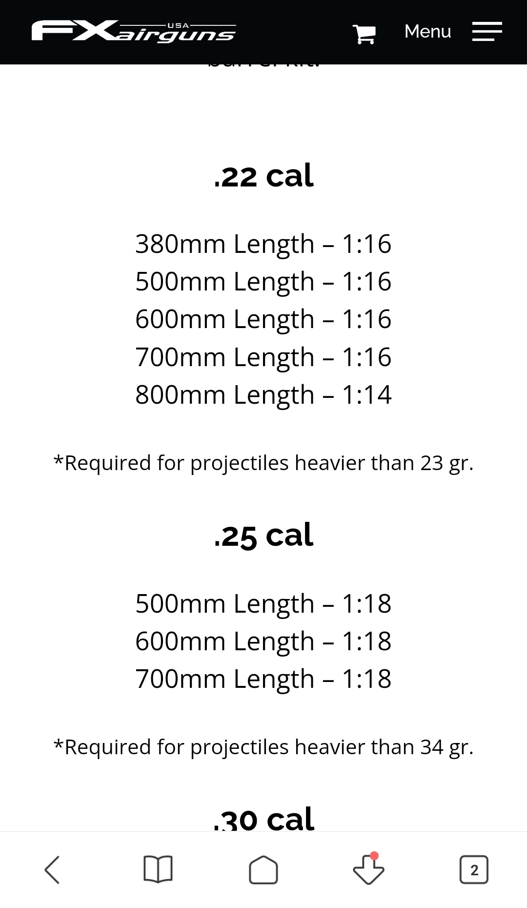

I'm sticking to pellets, if you want 22 rimfire performance, it's cheaper to just get a case of stingers, pay for a tax stamp and get a supressor. my 2 cents. Slug guns get way costly, their finicky, and usually on the brink of broke down or already there.Well said! Especially with the vapor ware prototype stuff they use. I went from a marauder mk1 to an impact m3 thinking it would have the power potential advertised and precision right out of the box. Days of tuning tinkering and finding the root of inconsistencies later im close. The marketing on slug liners is over stated too. You can shoot 150 yards with a pellet liner and light slugs all day long.
As my shooting buddy and i are learning, a 500mm maverick with a heavier hammer weight will do exactly what a box stock 700mm impact will do cranked up when both are harmonically tuned (energy and accuracy) and the mav is way easier to swap a hammer weight.
Im beginning to suspect hammer weight increase and harmonic barrel tuners are the best money spent. I shouldve known better with my experience in harmonic tuning powder burners.
