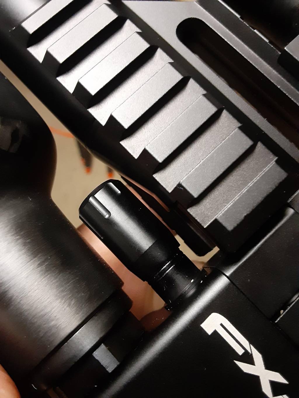

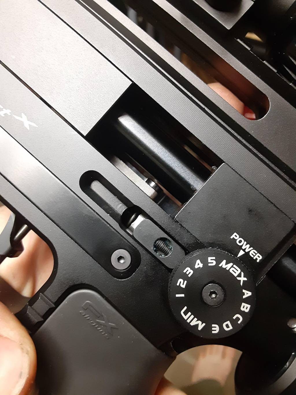

I did use the light spring that came with the kit. Here are my settings:
After I installed the high flow port and the slug kit, the gun was still setup for my original tune of the same 33.5 NSA at 940. Hammer was maxed and valve was at 3.5. First shot was 1015fps. I backed the hammer down until the velocity started to drop. I kept it right at the dropoff point then started turning the valve adjuster in firing 3 to 4 times between changes to let it settle. Valve dropoff point was where you see it in the pic above. I am very happy with this gun. It is sighted for 50 yards right now. But it is hole in hole at that distance. Practically speaking MOA is more than sufficient for me to take small game at any ranges it would be ethical for me to take them at.
