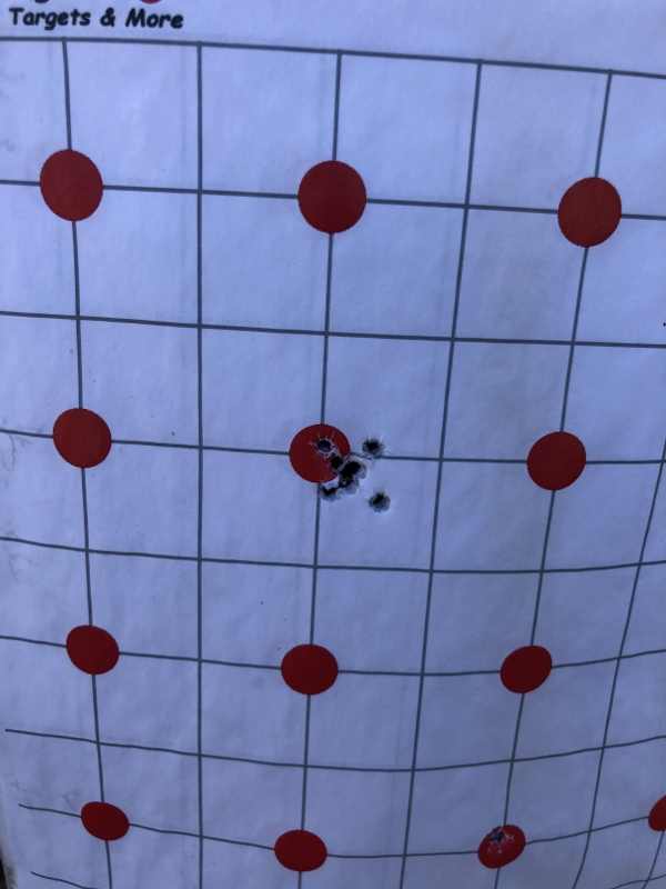

This is one group of 6 with the 23gr .218 slugs with slug liner and (4) five shot groups with JSB18gr with the pellet liner. One inch squares at 20 yards
