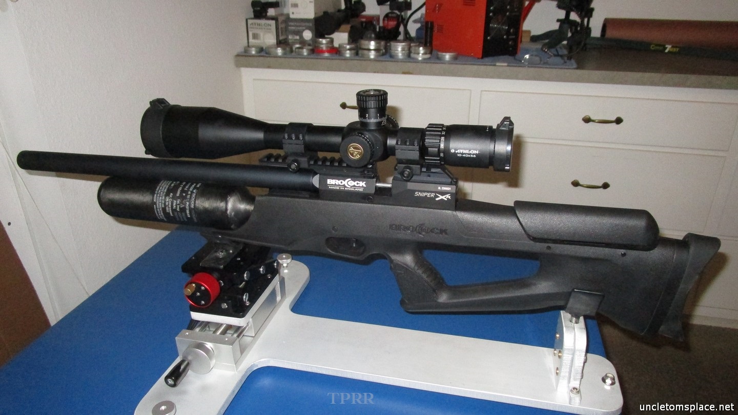

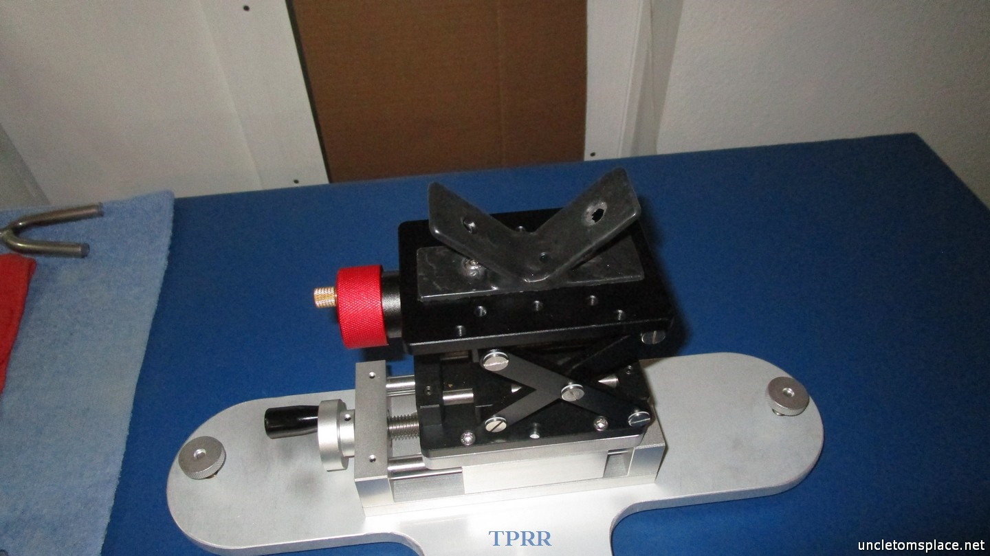

I made a couple of nice improvements to the Rifle Rest that I made last year. For the front and rear “Yokes” that cradle the rifle, I originally used some 3/8" stainless round rod bent to shape. I slipped some soft plastic tubing over to rods to secure and protect the rifle.
Today I used some 1-1/4" wide stainless flat bar bent to shape to replace the rod giving a lot more surface for support and securing. After welding the flat bar to the mounting plate or rod I applied three coats of liquid rubber to protect the rifle.
Last photo shows a rifle on the Rest and with this improved rubber surface area to “grip”, it is like the gun is glued in place. There is almost no movement of the rifle even when I cock it. I shot some paper targets this morning and this thing is rock solid.

Wonderful rest, i would like to try it sometime , looks like 1/2 inch AL plate ?
Hello @beerthief
Thank you, it is 1/2" thick aluminum and here is a link to the thread where I posted my build.
