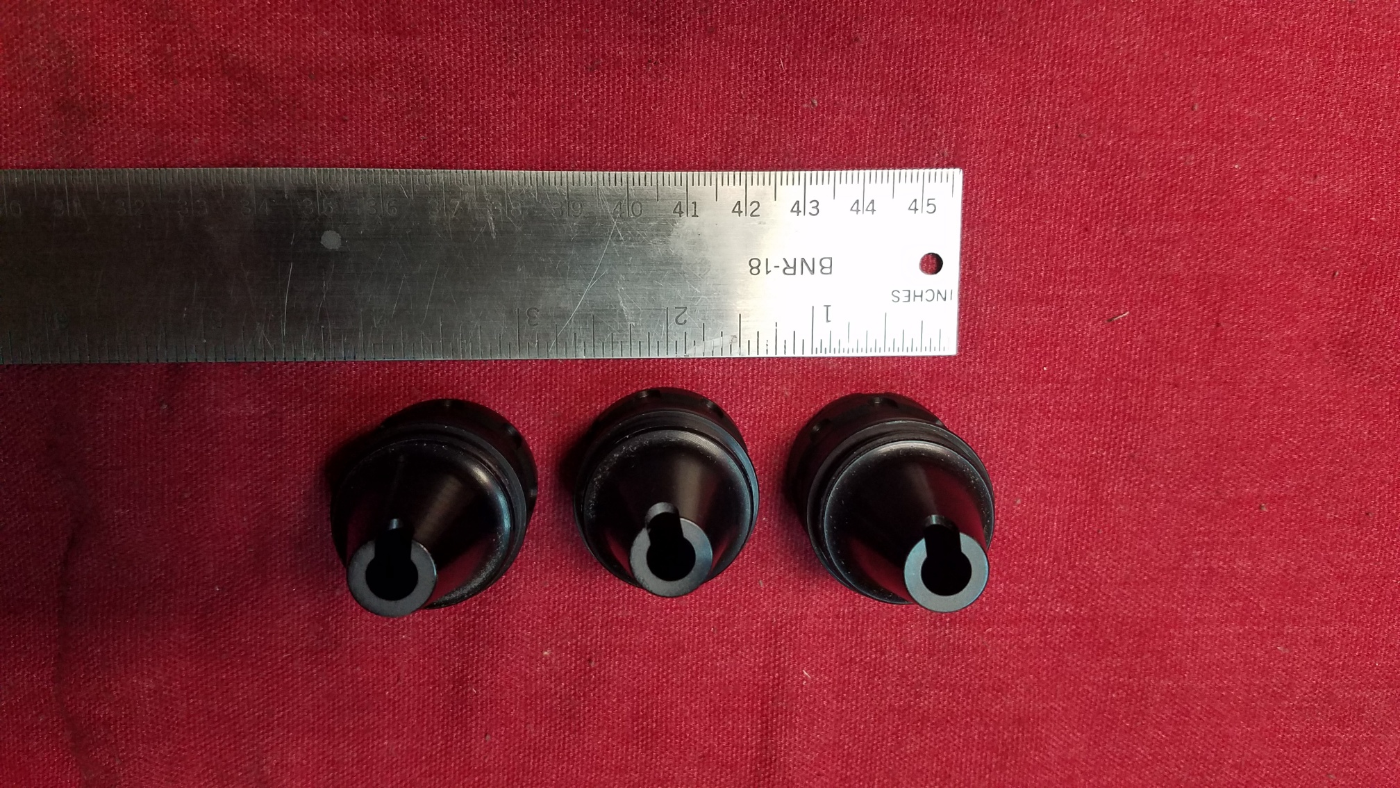

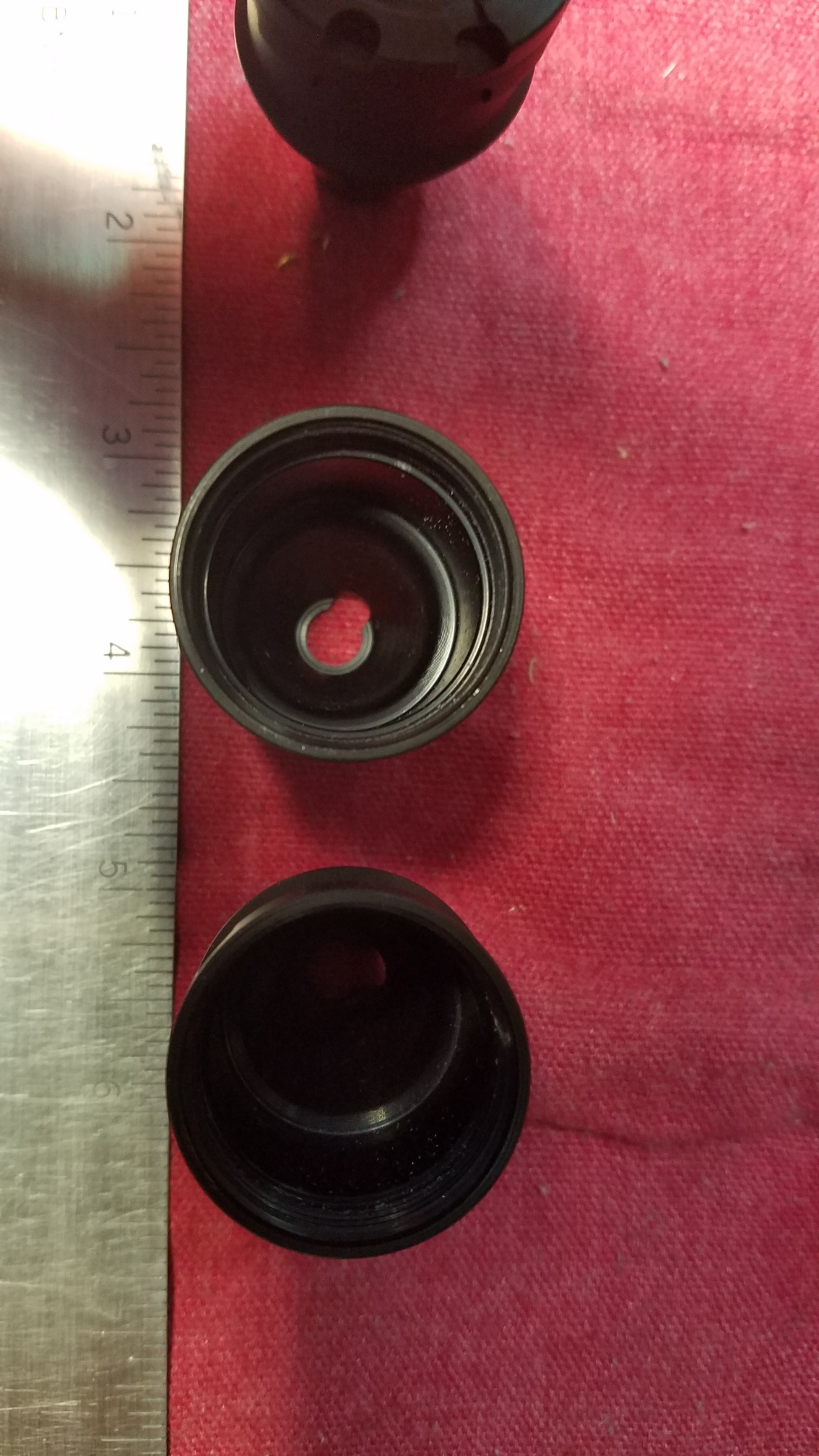

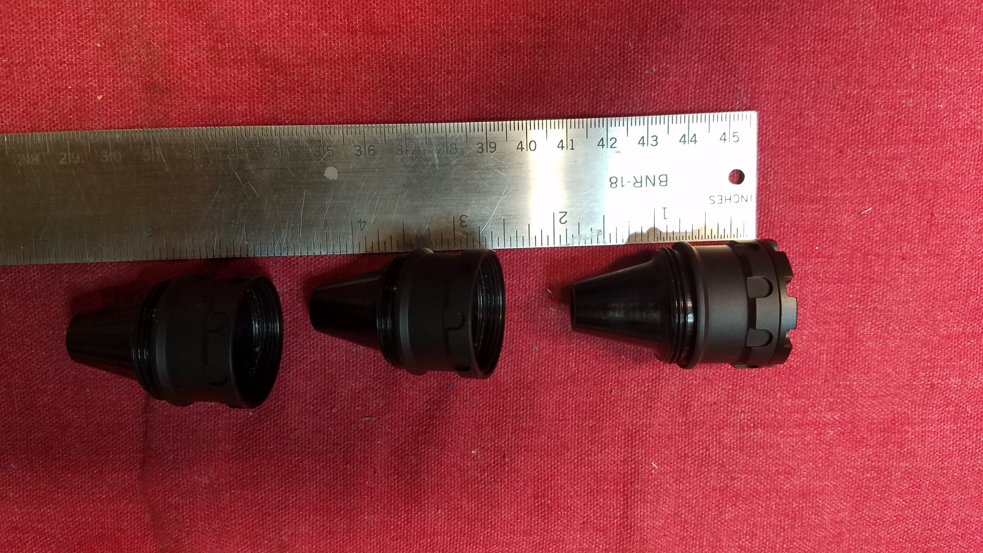

OAL is 4.75 inches. The rear of one cone to the rear of the next is .725. Machining and fit is excellent. I will let you know on Sunday how it sounds, I do not have a DB meter so will just be my opinion but I will compare to my suppressed CZ.

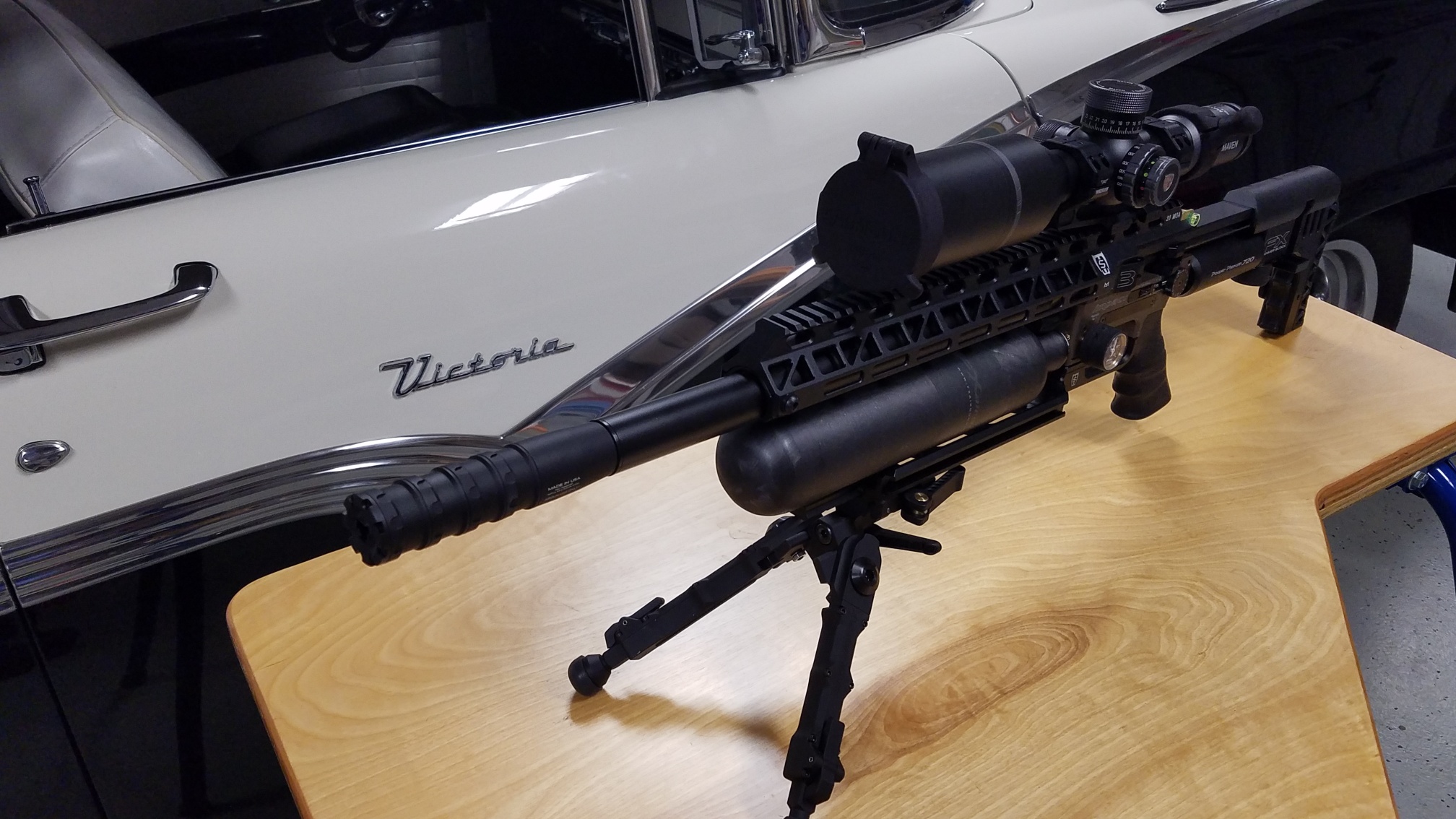

Take these results with a grain of salt as this was with one of those $20/30 db meters. But this was all done in the same session and the rifle to meter distance never changed.
Ronin - avg 80.6
Sumo - avg 84.6
Fatboy with muzzle break - avg 84.8
Koi - avg 83.5
Ia1350 - 86.6
Now given the size (volume) difference between the impulse and the dfl's, the impulse holds up pretty well imo. If I could put 7 or 8 baffles on it to make it Koi length, there'd be a shift in the results. Keep in mind, the Donny's get a lot of their silencing ability from their volume and the felt wrap. Whereas the impulse is solid aluminum.
From a fit/finish perspective, the impulse hands down. The machining quality is next level. The threading is absolutely spot on with no wiggle. This is definitely an example where the usa made product outshines the Chinese machining of the donnys. It feels like it should cost what it does whereas with the others I felt like I was buying an overpriced 'oil filter', if ya know what i mean--buying the 'oil filters' direct from china is $20-$30, to put it into perspective. Then consider the cost to bring donnys to the US and the markup needed to put money in pockets...they are $20-$30 moderators that we pay quadruple or more.
But I digress, to each their own. I still use both. The impulse is on my nrl rig as it doesn't need to be hush hush quiet and in my use, the impulse for me has shown more favorable/tighter groupings--believe this may be the baffle/air stripper design.
