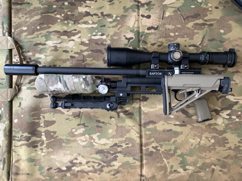

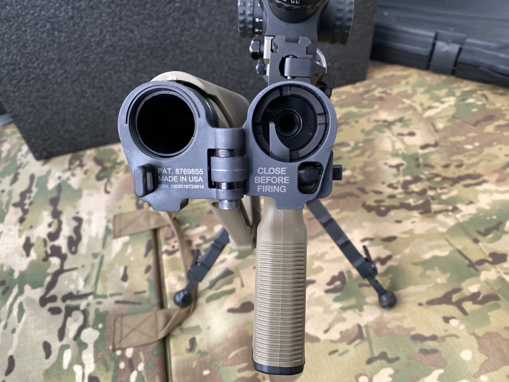

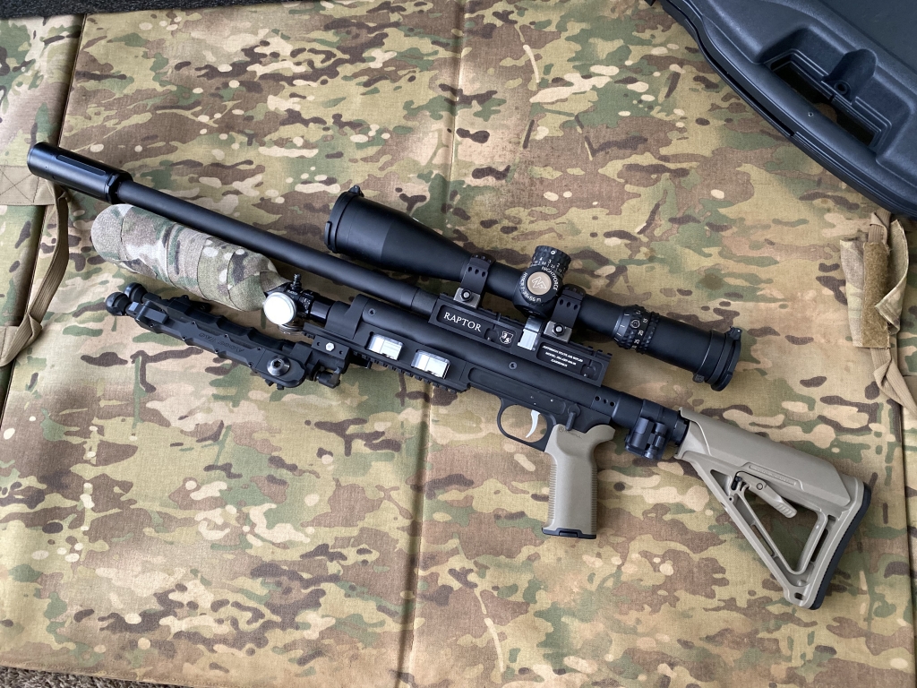

I ordered a Law Tactical folding adapter so I can keep it short and have quicker access to the hammer settings. Putting a little Magpul MOE (also have a CTR) on it as well, so the weight should even out to about what it is with this UTG. I'm putting a Magpul grip on it too, because this grip gets COLD and my circulation sucks so I'm a little crybaby shooting with cold hands 😂
