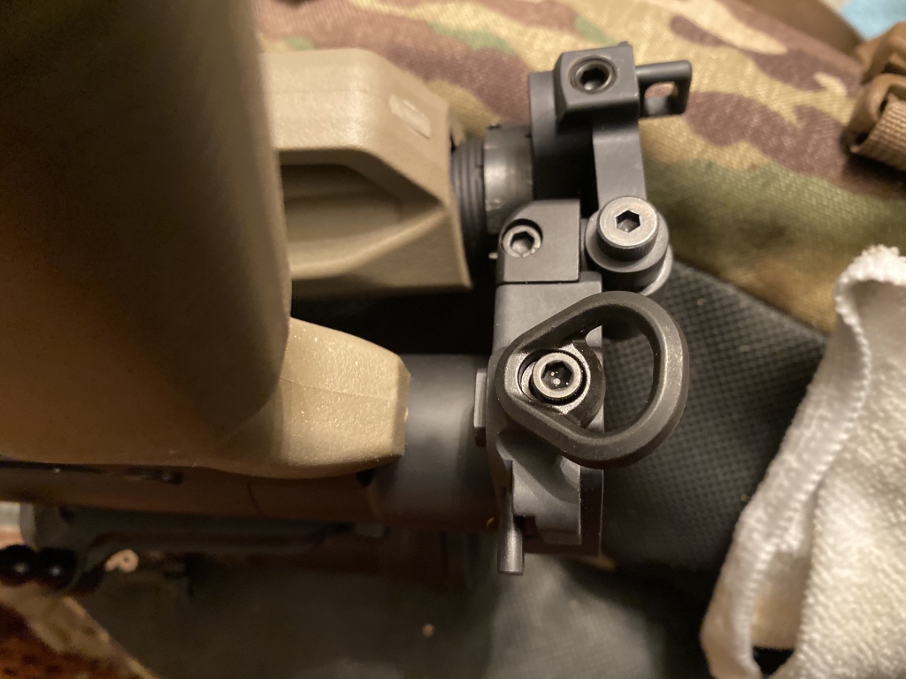

Can you put a standard buffer tube for fixed stocks on that folding adapter?
Yes sir. As long as it's mil-spec it will screw right in. I'm just using the tube I had from an old AR build right now, but anything will work.

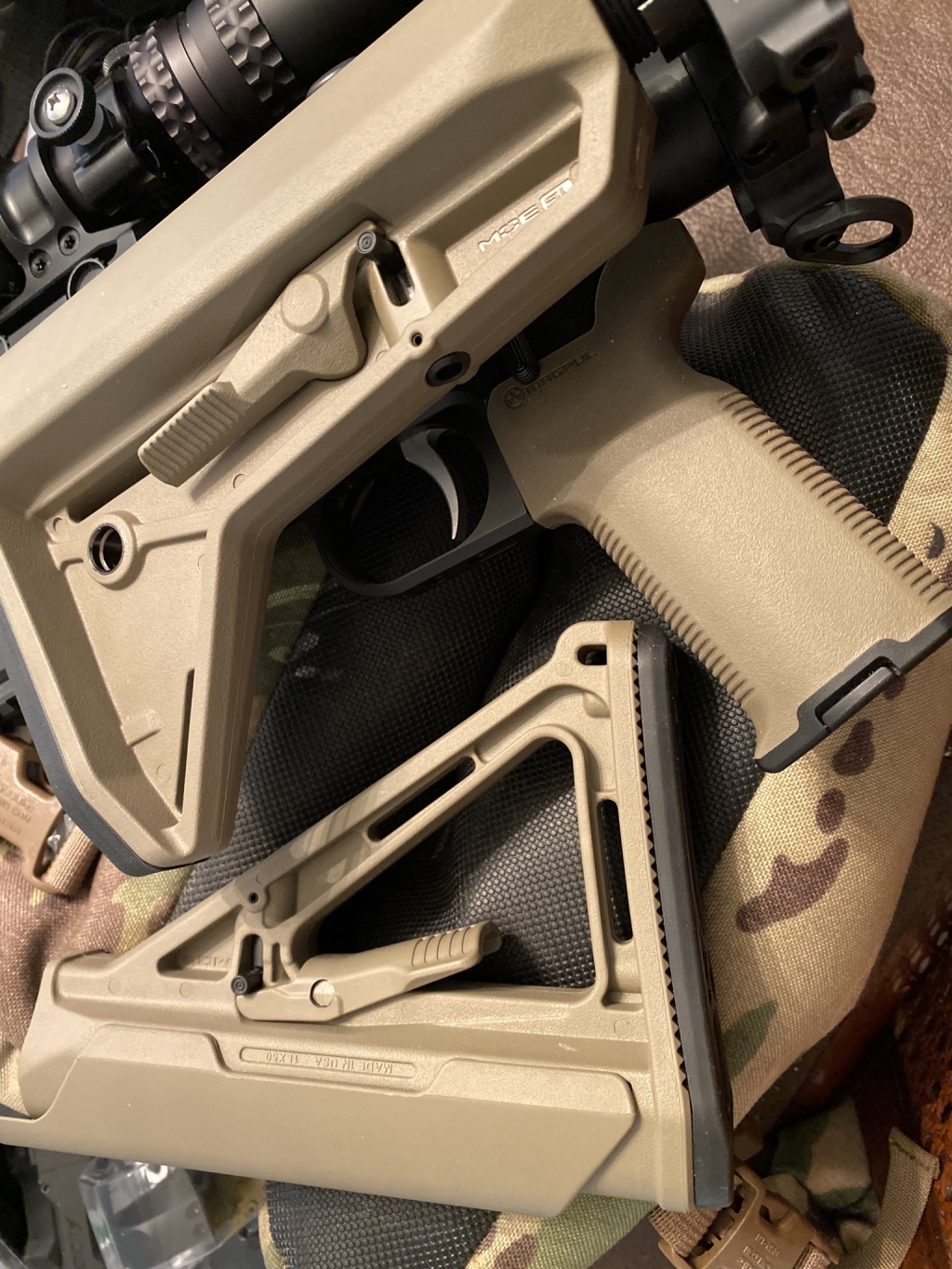

Something that's been bugging the hell out of me has been figuring out how I wanted to setup this Mini with a sling. I'm partial to my padded Blue Force single point sling for airgun hunting. So today I changed out the stock for a Magpul SL (weighs less than the previous stock I had on with the add-on cheek riser), but the cool thing about these LT folding adapters is that they have a sling mount port underneath. Threw on a a little QD sling mount today and I'm super happy with it:
