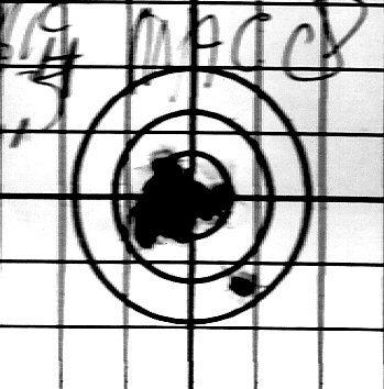

I recently bought an Fx impact m4. It seems to be shooting inconsistently on a double stand setup (no I wasn’t holding it) when I was zeroing it. Would anyone know the reason?
Hello, I'm shooting at the moment with JSB Heavy .22 18,13 Grain at 50m
FX Impact M4 Extended 800mm 5,5mm on Pellet port (there's also a Slugs port )
75Bar
4 ringen zichtbaar
8 Macro wiel
2,5 Micro wiel
10 shots, 9 between 265 m/s en 268 m/s en 1 at 261 m/s at a temp. around 6 graden celcius
the square's are 1 by 1 cm .4 inch
