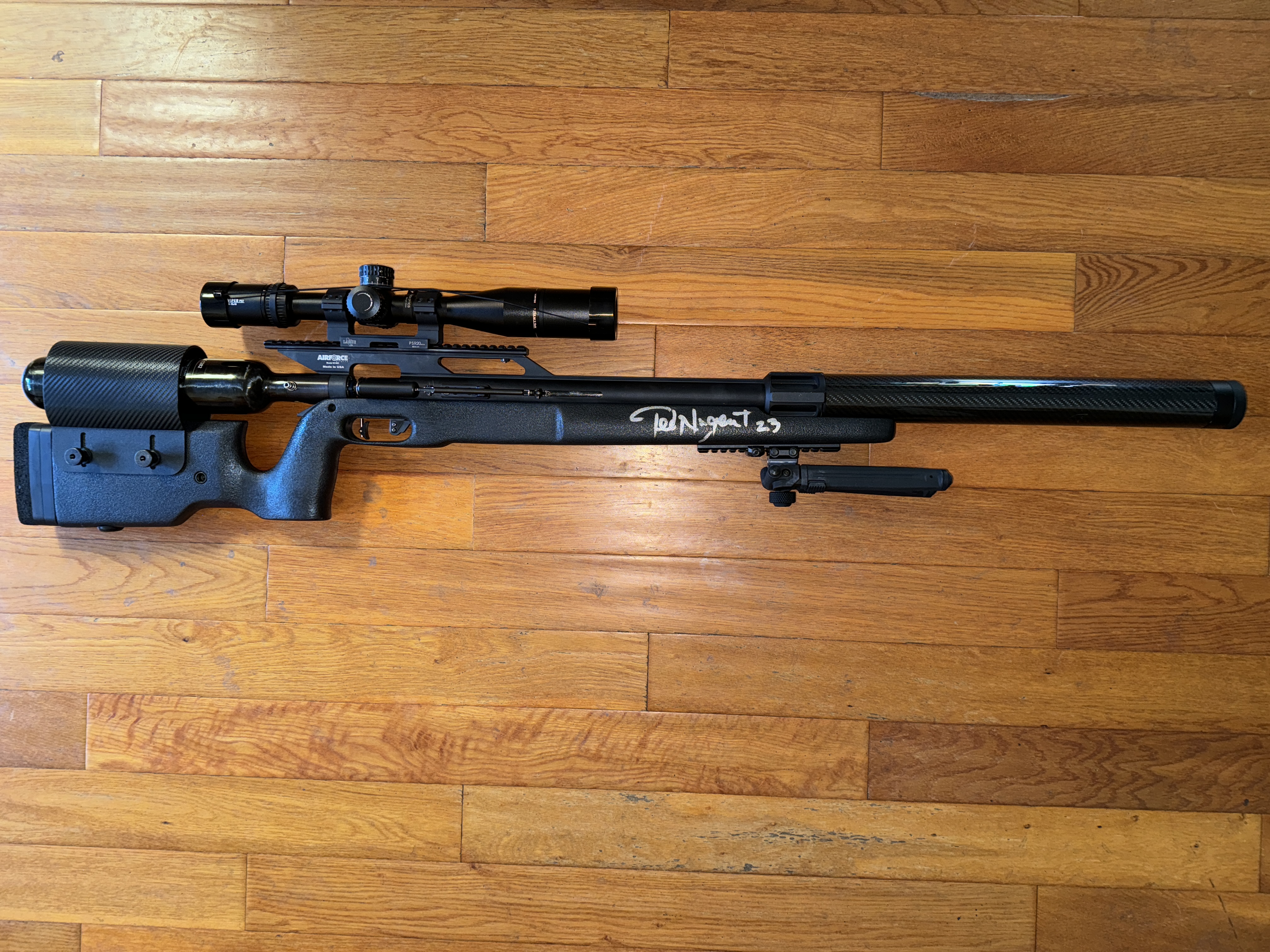

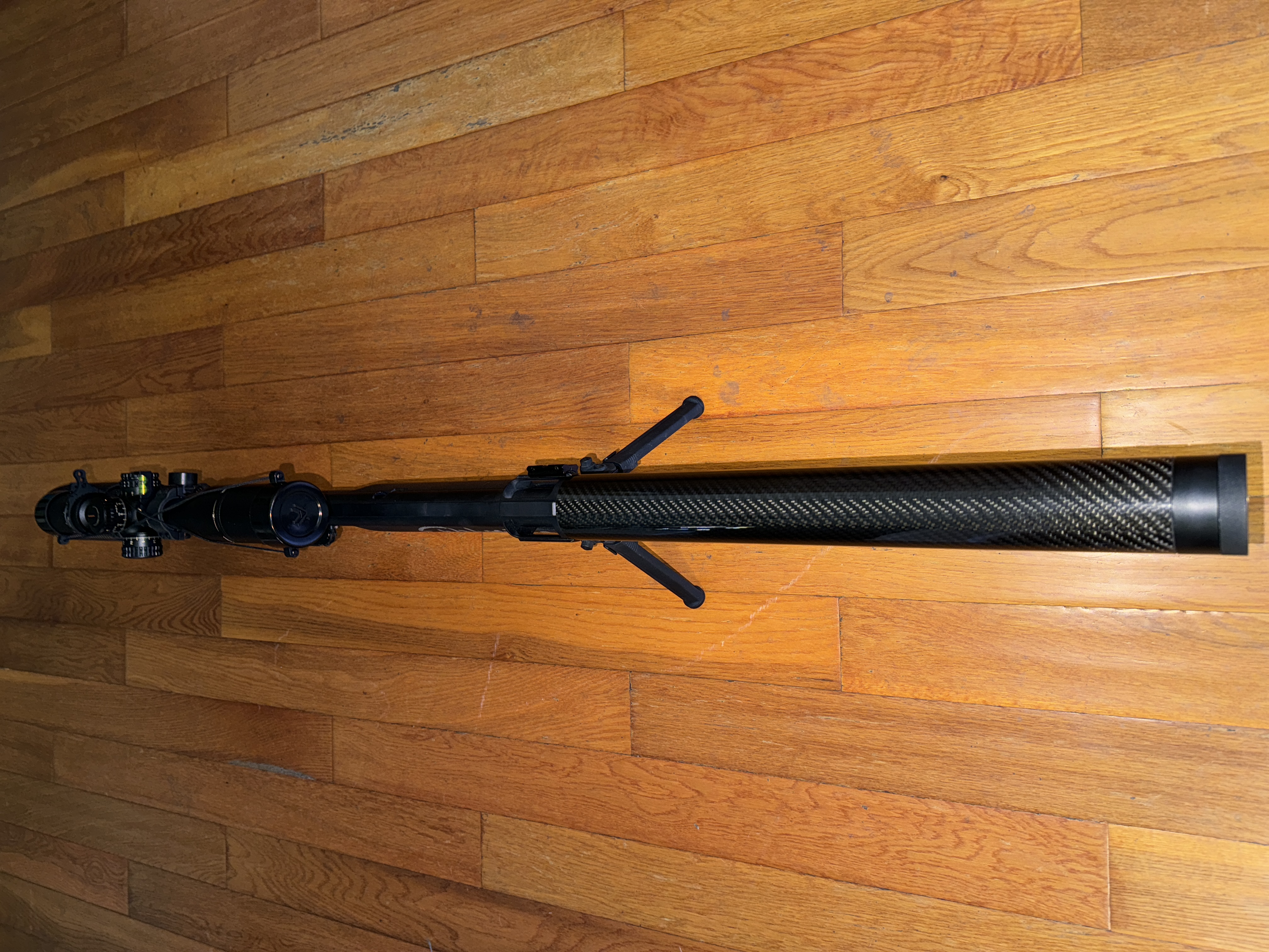

Have you considered the idea of adding both light weight and stiffness, while keeping the overall length and sound to a minimum?
This rifle with carbon fiber shroud is quiet, very stiff, and shoots 1 MOA groups at 100 yards all day long. Occasionally… it will shoot 1/2 MOA groups but I still call it a 1 MOA rifle because it never shoots a larger than 1 MOA group at 100.
This rifle with carbon fiber shroud is quiet, very stiff, and shoots 1” MOA groups at 100 yards all day long. Occasionally… it will shoot 1/2 MOA groups but I still call is a 1”MOA rifle because it never shoots a larger group at 100.
100yards/untethered.
Every rifle will have its own individual seeet spot for the pressure and power wheel.
