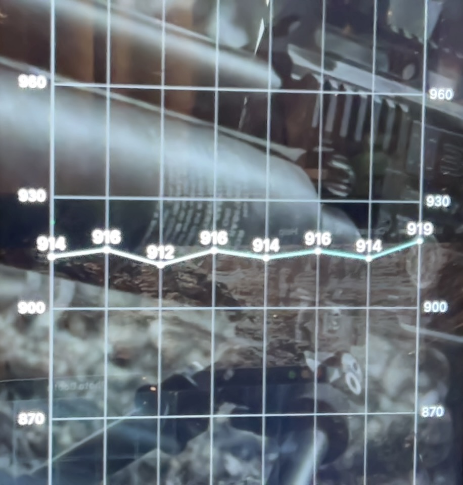

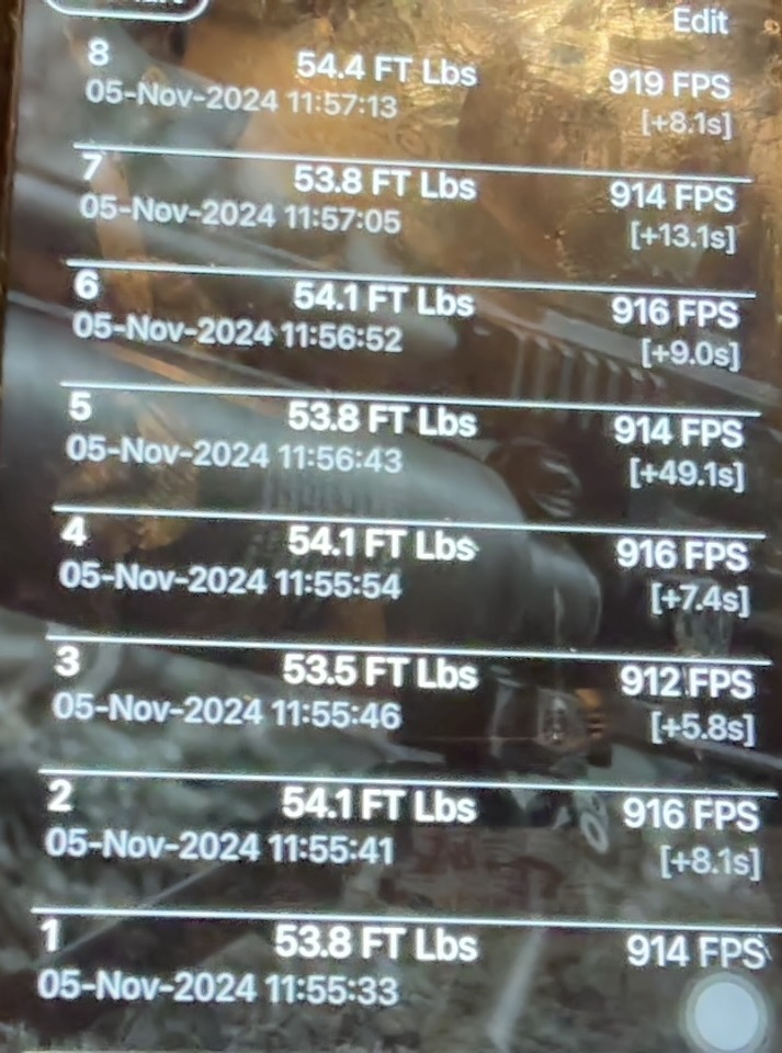

I swapped the heavy hammer out for stock. Slowed down NSA 29 dished from 950 to 915 fps. M4 is happy sounding. Been shooting NSA 26.8, 29, H&N 30. This is a Compact so your longer barrel will do better. Reg 120, Macro 8, Micro one click pass 3.5 VA just pass 4
Is that using the pellet or slug port? What’s your shot count per fill like with that tune?
