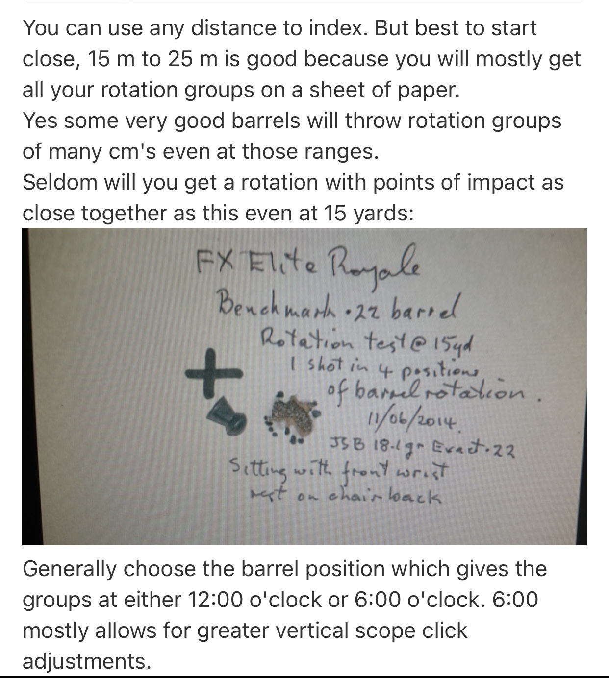

Index and zero at 6 o’clock or 12 o’clock
We're going to Disagree ...
Or at least the parameter of the statement made :cautious:
If one CLOCKS the barrels rotation so that if any run out exists, the barrel is placed to be at it's highest point at 12:00 towards scope .... It could be seen similar to using some amount of MOA correction in a scope mount which would gain you a tad more elevation adjustment overall.
If one optically Pre-centers there scope and DOES NOT TOUCH IT. Goes and plays with barrel clocking while shooting ( No matter where impacting for this exercise )
If barrel is clocked to 6:00 ( POI wise ) you would likely need to use / need VERTICAL adjustment on the scope to get zero'ed .. Leaving LESS vertical adjustment in the turret mechanics for long distance work.
If barrel is clocked to 12:00 ( POI wise ) you will be shooting higher from the get go and scope would use less vertical adjustment overall for the same POI. Leaving more vertical adjustment for long range work.
Again just talking / thinking here ...

It can get confusing for sure!
Let’s say you have a mechanically centred scope with 10 clicks of upward adjustment and 10 clicks of downward adjustment.
To zero your scope to the 12 o’clock index position you adjust your point of aim up on your scope 5 clicks.
You now only have 5 clicks of upward adjustment left.
To adjust your point of aim to the 6 o’clock point of impact you adjust your scope down 5 clicks.
You now have 15 clicks of upward adjustment.
