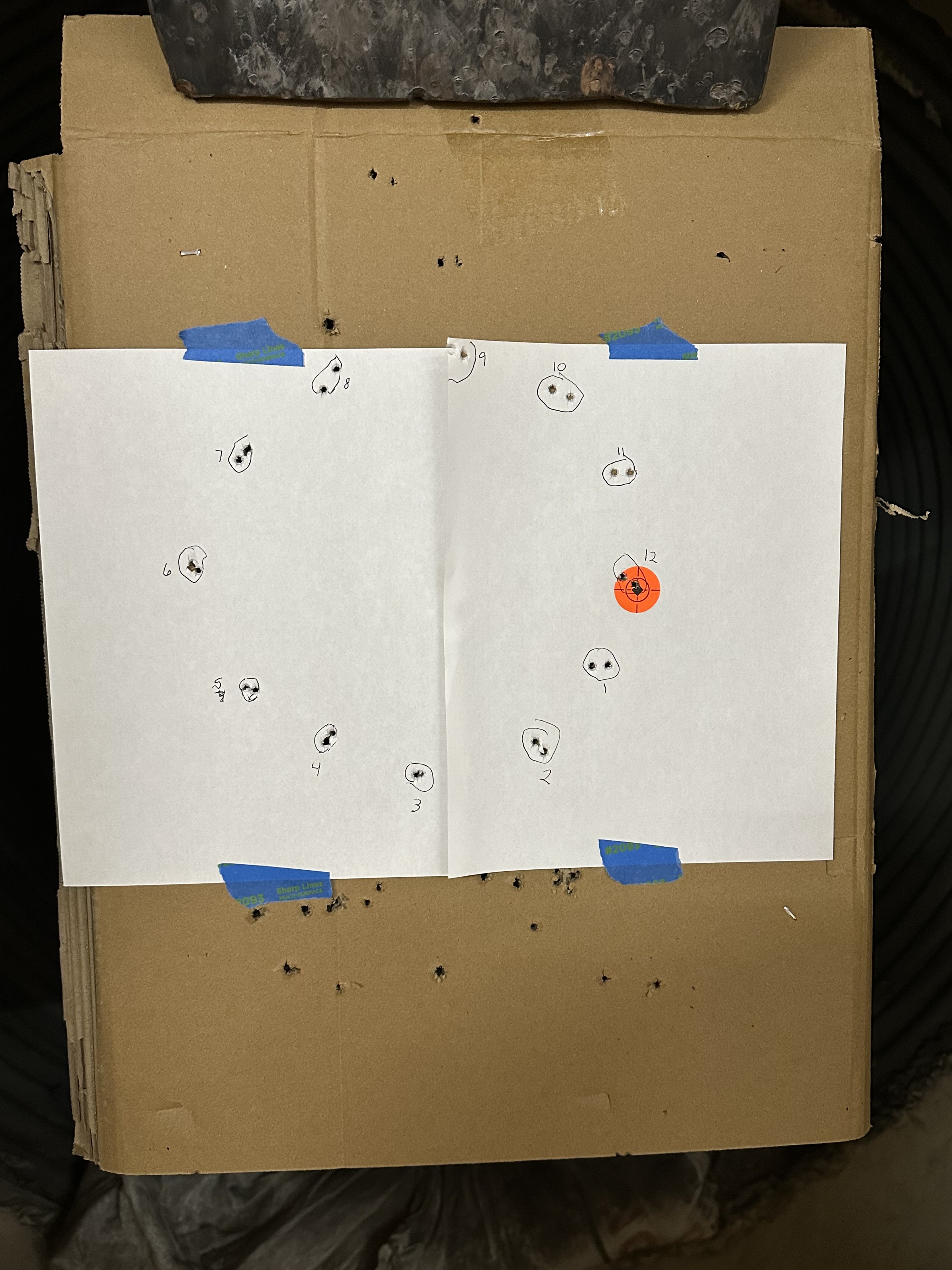

So before too long, and once the holiday ruckus is over; I'll begin setting up my new EVO. One of the features this gun has, that my other PCPs does not, is the easy barrel indexing feature. Now the question becomes "how to make proper use of it"?
Should one just center their scope, then indexing the barrels POI to closest point of natural center of the scope, and adjust the scope from there? Or, is there more to it?
Here are results from indexing my barrel on my EVO. This was done at 50 yards. The gun is roughly tuned but I wanted to play around with indexing. From the results you can see that 9 is where I want to be so I tweaked it a bit to get it perfectly at 12 o’clock. Very easy to do with the Skout.
Thanks for showing your results.
If you would please do so, shoot some group"s" at 50Y at setting 3 and at setting 9 because it seemed 3 was more precise. I'm just curious as 3 through 6 are more precise as well. Also opposite of that - 10 to 1 going clockwise seem less precise.
All that is to say I'd rather be clocked away from 9 if I can get twice the precision. The problem is it takes quite a bit of trial and error shooting groups in calm conditions to make a fruitful decision.
These were shot indoors at 50 yards. From my understanding you want your barrel at the top of the indexing. Don’t take the group size into consideration as I was limited at my time on the bench and was shooting fairly quickly to get through all 12 positions. I Thought it was interesting that the circle was that large at 50 yards.
