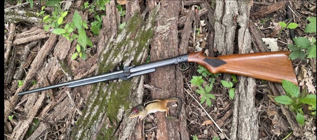

yes i am interested , I started in Airguns with a top line PCP and am working my way back to the beginning .
My next gun i am looking for
Yeah, I really like those old springers, too!
