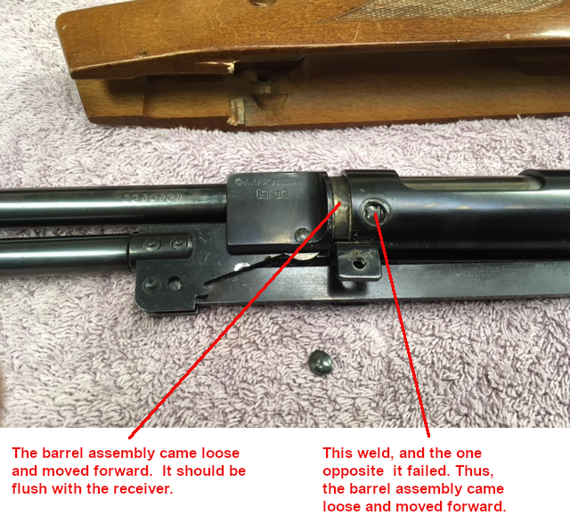

Oh, yeah, I'm quite well aware of that. HW97K's have a horrible design element. Ours has been a complete lemon from day one.
One of the biggest problems is the way they attach the barrel assembly to the receiver tube. Two spot welds. If those come loose, or were bad in the first place, you will have very erratic POI. Trust me. Been there!
I'm on my third repair of this now.

And yes, they are aware of their lousy barrel assembly to receiver tube design as well.
I really think a lot of what people describe as "springer" problems are really either bad welds, ever so slight lockup problems, etc.
