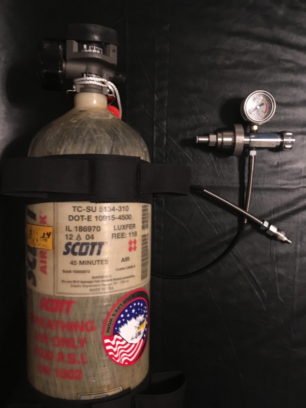

Just wanted to mention that you don't need to spend over $550 for a new 4500 psi carbon fiber air tank. I wanted to get a second tank to go along with the AoA tank that I have had for a while. Looking for an alternative, I decided to go the used SCBA route. Purchased a used in good condition Scott SCBA 45 minute air bottle from a reputable eBay dealer. The price was $75 plus $35 shipping, total $110. The bottle has over 2 years service life, and even has a current hydro good for almost two years. In addition, I bought an SCBA rig with gage and hose off eBay for $54. So, for a total of $164, I have an additional air tank that will last me until 12/19. Photo of rig posted above. Links listed below in follow on post.
Centercut, congrats you actually scored a Navy DOT-E 10915 certified tank. Here is the good news, because this DOT 10915 was approved to be part of the SP-16320/15720 MAE life expectancy extension re-certification permit granted to Digital Wave. According to the permit, you can get your tank recertified every 5 years if it passes the MAE (Modal Acoustic Emission) upto a total extension of 15 years beyond the MFG date. If you contact https://www.digitalwavecorp.com/ they can tell you what you need to do and when, and the cost of testing. After it gets tested and passes they will apply a new DOT SP label that represents this tank has passed the new certification requirements.

Give them a call, I did. It was very interesting to see what they are doing in the industry in support of non-destructive testing in the compressed gas industry. They will work with you to get your CF tank certified in the Life Extension program under DOT SP 16320. Which can extend the usable life of the tank up to 15 additional years from the mfg date, provided it still gets MAE testing every 5 years. That could give you 30 years of life out of a CF tank. Not all tanks are going pass for that long, and not all CF tanks are built originally to an approved DOT specification that would be a candidate for this procedure, but your specific tank appears to be a candidate based on the DOT number on the tank.

Thanks. I looked, and the DOT-E 10945 is also eligible for the same extensions (link for nice bottle below). Here's one I ordered that looks pretty much new, although it was manufactured 4-2004. That will give me three total, two CGA347 Fire Bottles and one regular DIN300 bottle from AoA. If I'm going to drive to get them filled, I might as well bring 3 with me. Thanks again...
