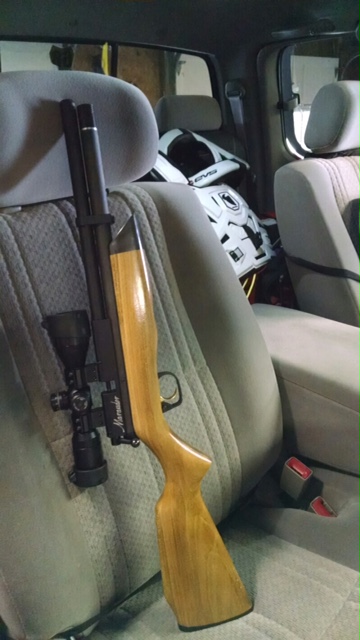

Thanks Jim. There is not a lot of room to work with in a Prod so a short stiff spring or dual springs present quite a task. I didn’t want anything sticking out the back of my gun like a conventional SSG does when the gun is cocked. My Prod, which i call a Weerod is in a rifle stock. So I went with I guess what is referred to as a FFH. A free flight hammer. My spring is attached to my hammer. You don’t need much free flight to stop hammer bounce thankfully because like I said, there is limited space in there.
Oh man that is nice! What stock is that? Update:
