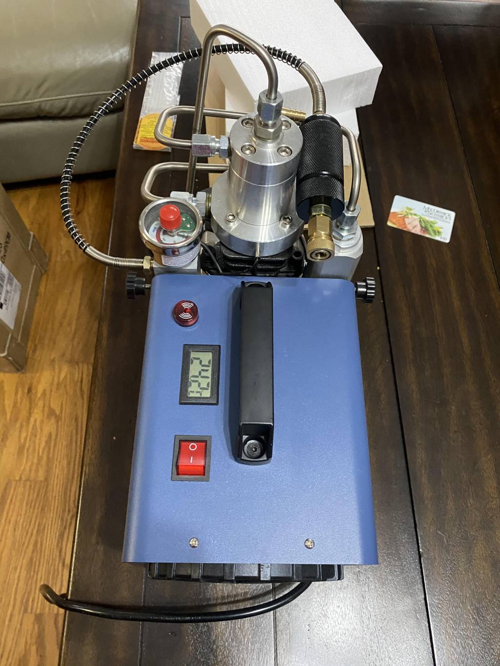

Welcome...from the sound of it, you have everything you need to get started (unless you need pellets too). Did you get instructions with the compressor? There are many brands out there, and they all require some "care & feeding" of sorts. You should be able to find out how to care for your compressor and rifle here on the site. From what I have learned here, one of the more important things is to make sure that you are putting dry air in your rifle. There could be an in-line filter on either or both sides of the compressor (low pressure air drier and/or high pressure air drier). The forums here should help you figure that out.

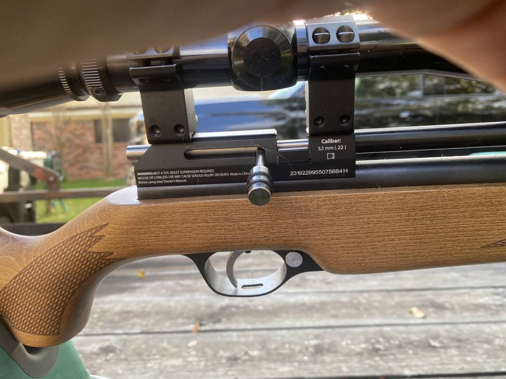

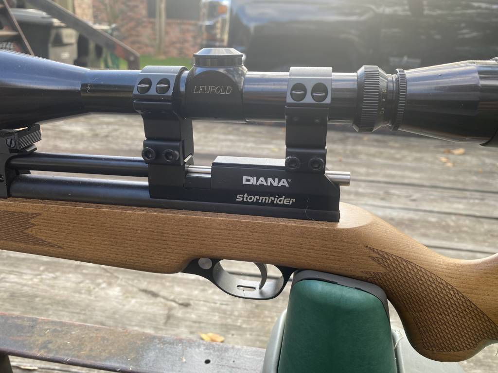

I don't know if you have a GEN 1 or GEN 2 Stormrider, but here is a link to the manual for the GEN 1 from Pyramyd Air:
https://www.pyramydair.com/airgun-resources/manuals/Anleitung_Stormrider-manual.pdf
You can also get to the GEN 2 manual at the same dealer website. Did that Leupold scope come with the rifle? That scope could be the real gem of the entire gift. They make very sturdy scopes. The compressor you posted pictures of looks like it might be one of the many Chinese imports (such as a Yong Heng). I don't know much about those, but people seem to have pretty good luck with them. Maybe post a better picture of the brand name/model number and someone on the forum that owns the same one can link you to a user manual. The black cylinder on the fill probe is a type of in-line water filter, but I don't see any other desicant filter in the setup. That doesn't mean the system doesn't filter moisture using some other means in the early compression stage(s). I just don't know about the one you posted pictures of. Just remember to be careful working with high pressure air. Ask questions, they are free.

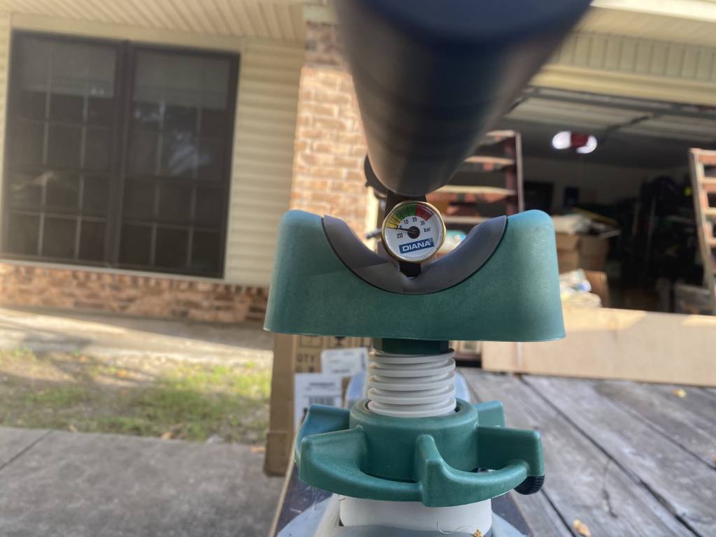

Two gauges means your gun is regulated so you can fill it all the way up to it's max fill pressure.
A bunch of info on how to treat your compressor here and a how to fill a tank link at the bottom.
Yong Heng post link;
https://www.airgunnation.com/topic/a-dedicated-yong-heng-subforum/#post-1127767
A how to fill your gun with the Yong Heng link is here;
https://www.youtube.com/watch?v=Vytcl9pE9E4&ab_channel=BigBoreAirguns
Oh, and your water pump goes to the bottom fitting on the compressor the top is the return line.
Always remember to purge the compressor high pressure valve before you try to remove fill valve from the gun or foster fitting from the fill valve.
This should get you started safely and shooting the thing without destroying anything anyway.
