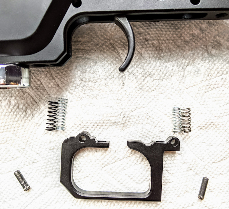

Trigger break is clean and crisp but very heavy. Didn't measure but I'd guess up in the 4+ lb range. Probably an opportunity to improve it by swapping springs. There is an pop/over-center feel even when not cocked...perhaps an opportunity to work on the profile.

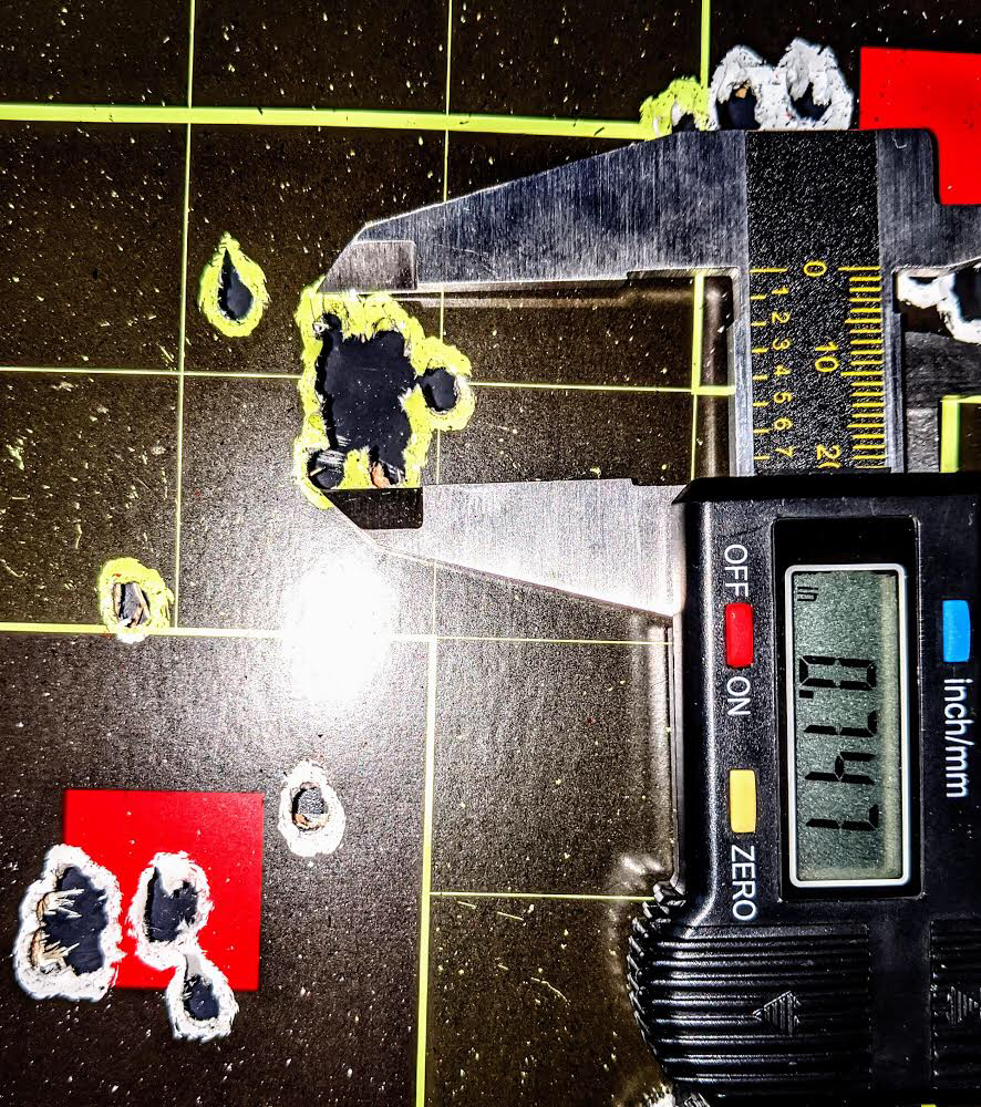

I shot groups at 41 yards (the length of my backyard range.). I still need to get used to the heavy trigger and the cold didn’t help me get comfortable so I think there is room for improvement. That, and I did not prep yet...not even a quick barrel cleaning. All groups were shot from the magazine, 12 at a time.
The Hades and Predator group sizes weren’t anything to brag about...1.2-1.5 inches. Probably need to try something heavier like JSB Kings to get velocities in a more pellet friendly range.
Given the power it was generating I tried some NSA .2165-.217 slugs in 17.5, 20.2 and 23 gr. They all did fairly well...in fact they tightened up from the pellets. There were some ragged one hole groups with a weird flyer here and there messing up the group.

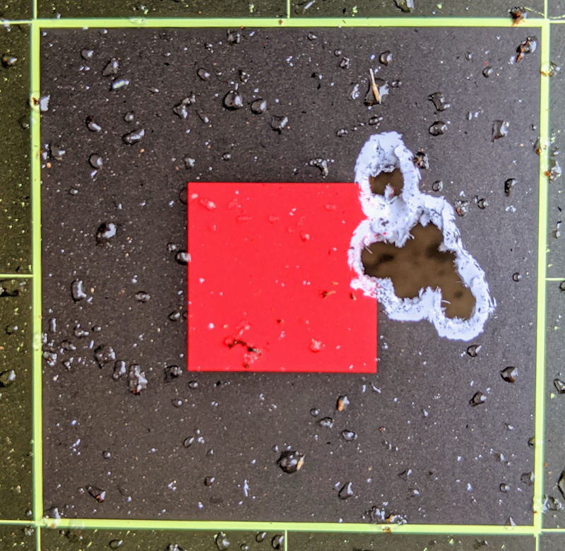

Here is the last group of the day (23 gr.) which was under ¾.” Note an example of a tight group with flyers below to the left. If I recall, there are 6-7 shots in that one ragged hole below. The other holes are various sighting in holes. Didn’t have time to change targets.
This gun has the potential to be a long range slug launcher.
