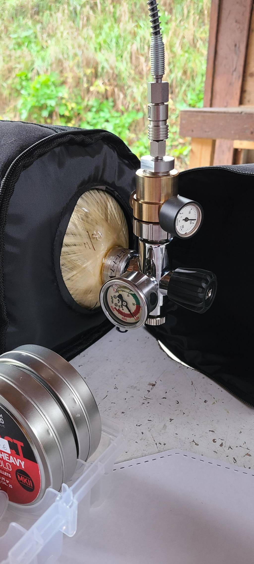

Speaking of size, I got the one off ebay yesterday
That's my actual hat I wear next to it lol
