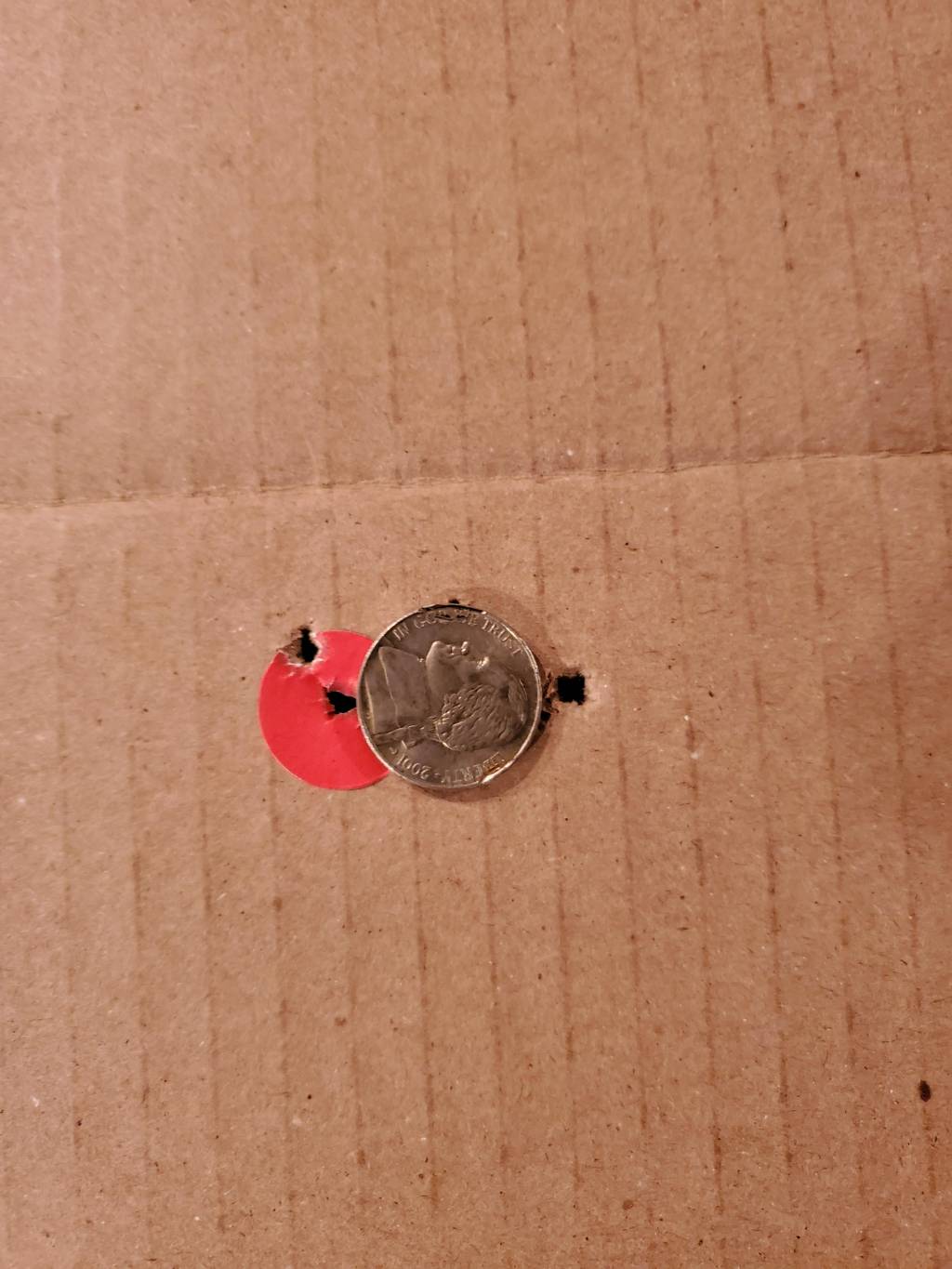

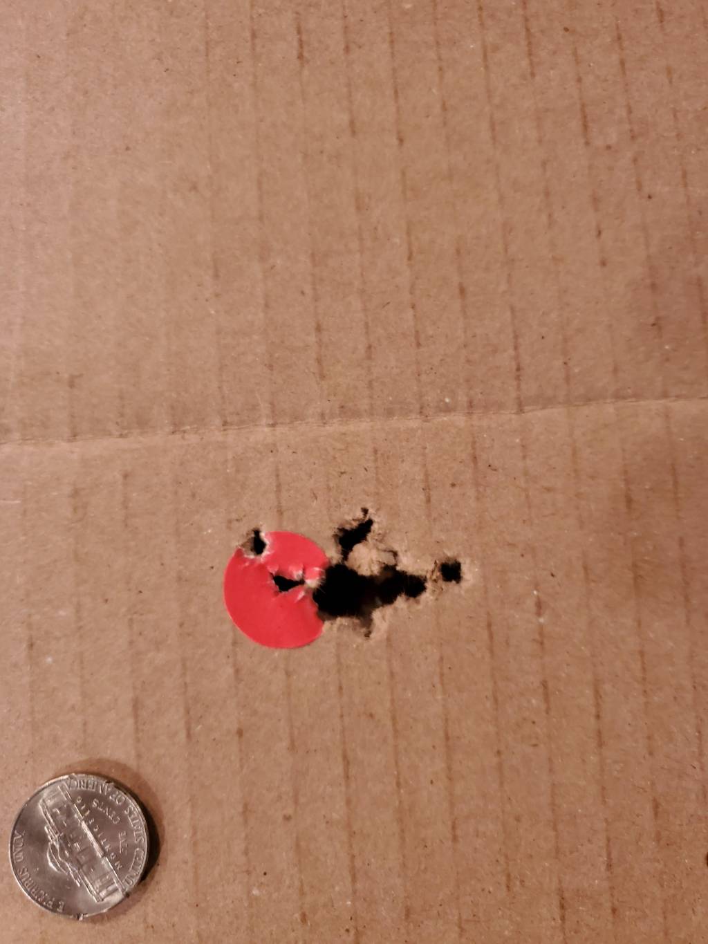

16 out of 19 inside a nickle at 53 yards with 18gr jsbs at 960fps. I recently got the gun a few weeks ago from kelly and only adjusted the power wheel up 1 click from how he sent it to me. Have around 300 pellets thru it and the reg is starting to get real consistent. Thought I would jump right to slugs but have over 5000 jsbs and since they shoot so good might be awhile before I get to them. Awsome gun
