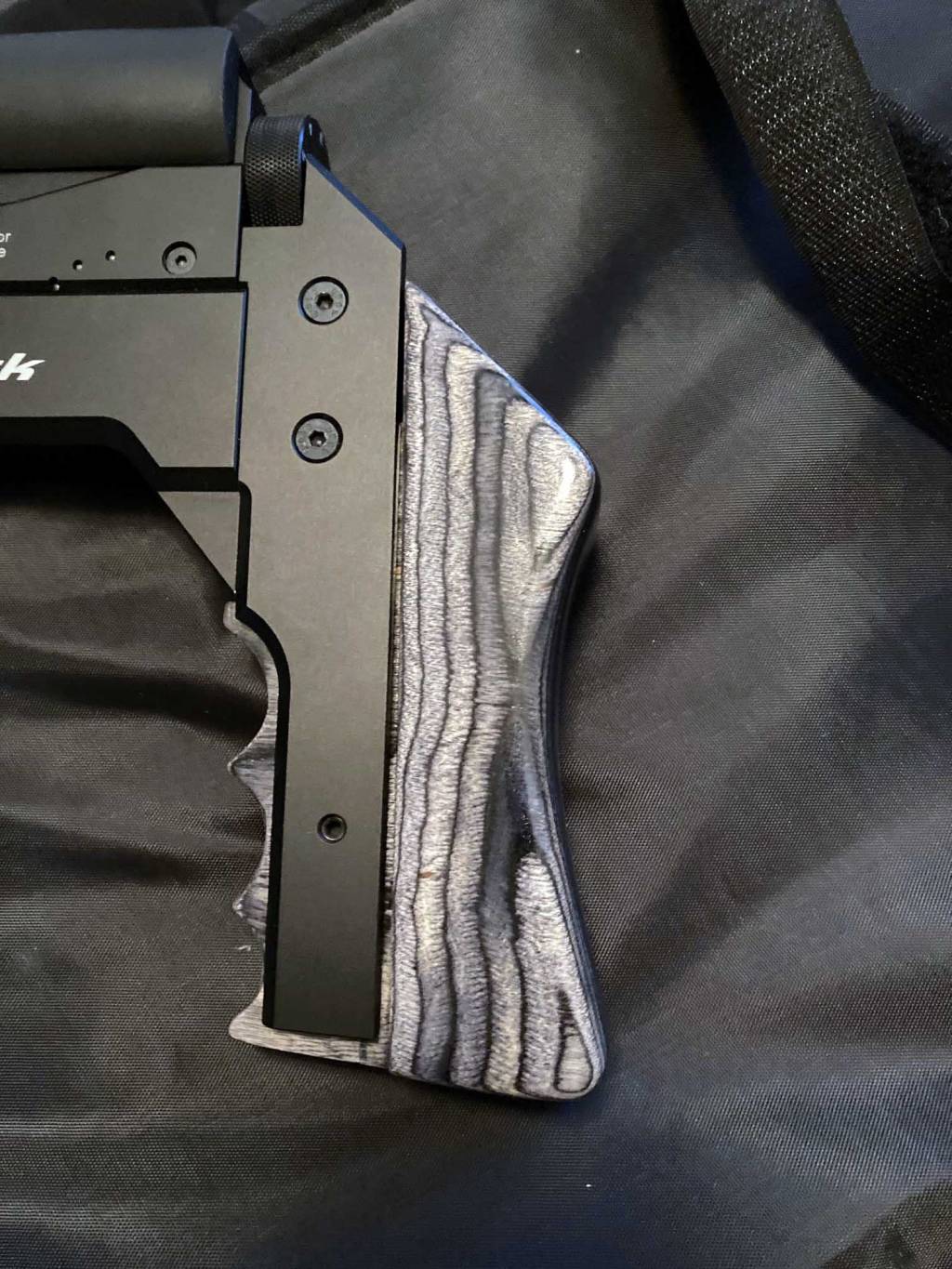

Installed new laminate furniture on FX Maverick

The grip is indeed very comfy. I'm shooting slugs at steel spinners tomorrow, so I'm excited to actually shoot with the new grip.

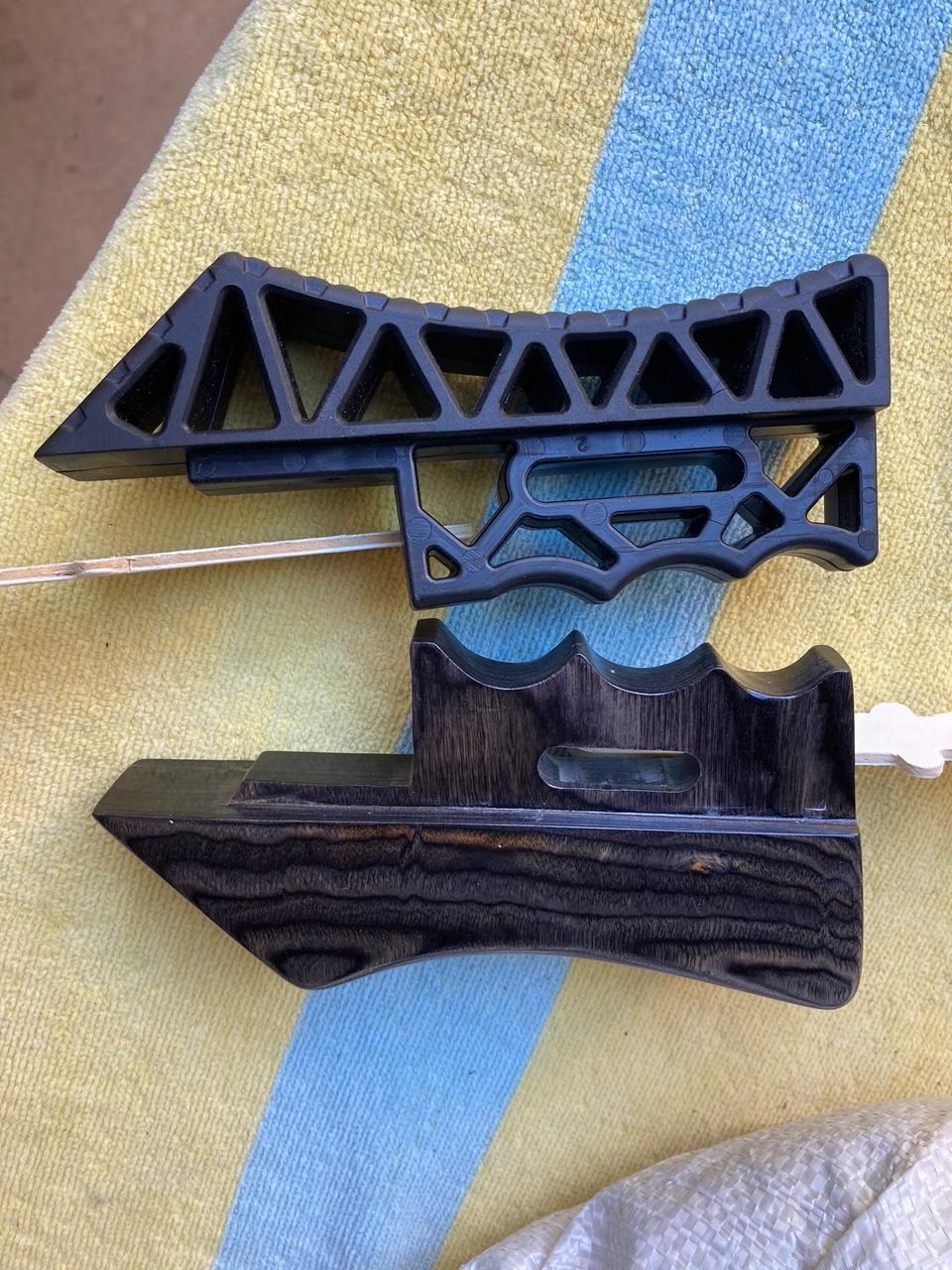

The OEM screws won’t work?
M4x10 socket head screws?
The OEM screws are M4x6mm, because the plastic cheek has less material under the counterbore than the laminate (the laminate would snap if it was that thin). M4x8mm might actually be a better fit; 10mm looked pretty close to bottoming out. On mine, the counterbores were also VERY tight, so the screw squeaked the whole way in. But the holes were perfectly lined up, so the tight clearances weren't a problem.

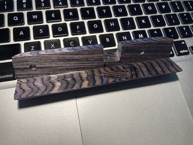

My colleague Marc told me there is an issue with the butt stock/ fitting of your Maverick grip set.
He showed me the pictures and we are very sorry about this.
We are currently in contact with our supplier in Indonesia to find out what happened, and more important, how we can solve it.
In the meantime, we took the sets off the website so other people won’t have the same issue.

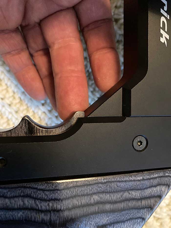

I even had my OEM butt pad lowered a bit, so I didn't even notice that the laminate butt pad won't go all the way up. Seems like it would be a quick Dremel job on a non-visible portion of the laminate butt stock to fix (I know, no one wants to Dremel a new+expensive piece of wood to make it fit, but even expensive GRS stocks usually need some inletting to fit).
@Goldwing, did you have any issues with fitment of the cheek piece? Other than the longer screw issue I mentioned, mine seems to fit fine.
I never put them on or modified them, there sitting in a box, waiting on Huma to send me replacements
