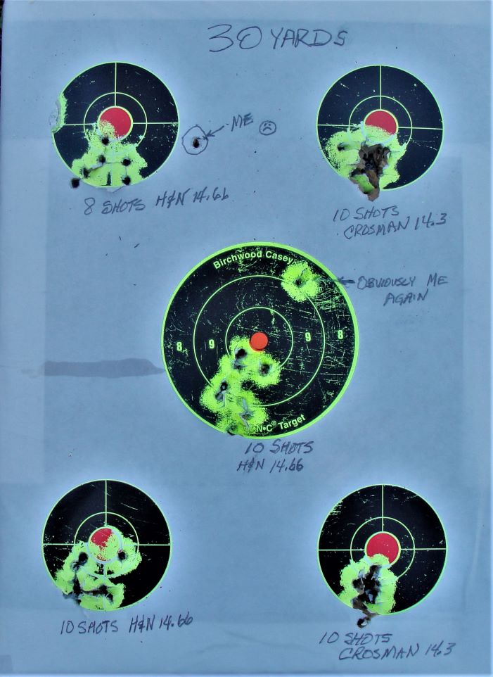

I have had my TX200 MKIII for a little over a month and although I liked the way it shot, I decided to install the new steel PG4 Vortek high output tune kit. I shot the gun after installing it yesterday and have been shooting it today. I have decided now I really love the way it shoots. I can tell the gun no longer has the spring twang sound and slight vibration feel after the shot. I think the cocking effort stayed about the same, maybe even slightly more, but not much. Here is a photo of todays shooting from 30 yards using H&N Barracuda round nose 14.66 gr. and the inexpensive Crosman 14.3 gr. pellet you can buy at Walmart. After shooting today I ordered 4 more tins of the Crosman pellets.
A good tool made even better. Right on! I've had good luck with the Crosman Premier Domed and Hollow Point 14.3s. I'll get better results with other pellets, but not by much.
After reading a few postings on members using the PG4 kits from Vortek, I decided to put one in my HW95. Its on it's way. Its got a Maccari kit in currently but want to see the back to back results. Ive used the PG2 and PG3 in a couple Diana's with good results.
Thats some fine shooting to boot!
I am guessing you have the .22 cal from the pellet weight, may I ask what velocity the rifle is shooting with the Vortek kit?
AirShot, Yes it is a .22. I am sorry but I do not have a chronograph so I don't know the velocity. It seems to be shooting a little harder over the stock spring I had in but I can't tell for certain. I wish I did have a chronograph so I could see the deviation in 10 consecutive shots.
rwsmike, It was quite simple to put in. As I have read and seen the TX200 is perhaps the easiest springer gun to work on. The kit comes with a few simple instructions so just read them and follow them. Be sure and tap out the stock steel top piece that sits on top of the stock spring in the piston as the gun will not cock if you leave it in. Some will just drop right out but mine required I tap the piston stem in my hand and jar it out. It was stuck in the piston by the lubricant.

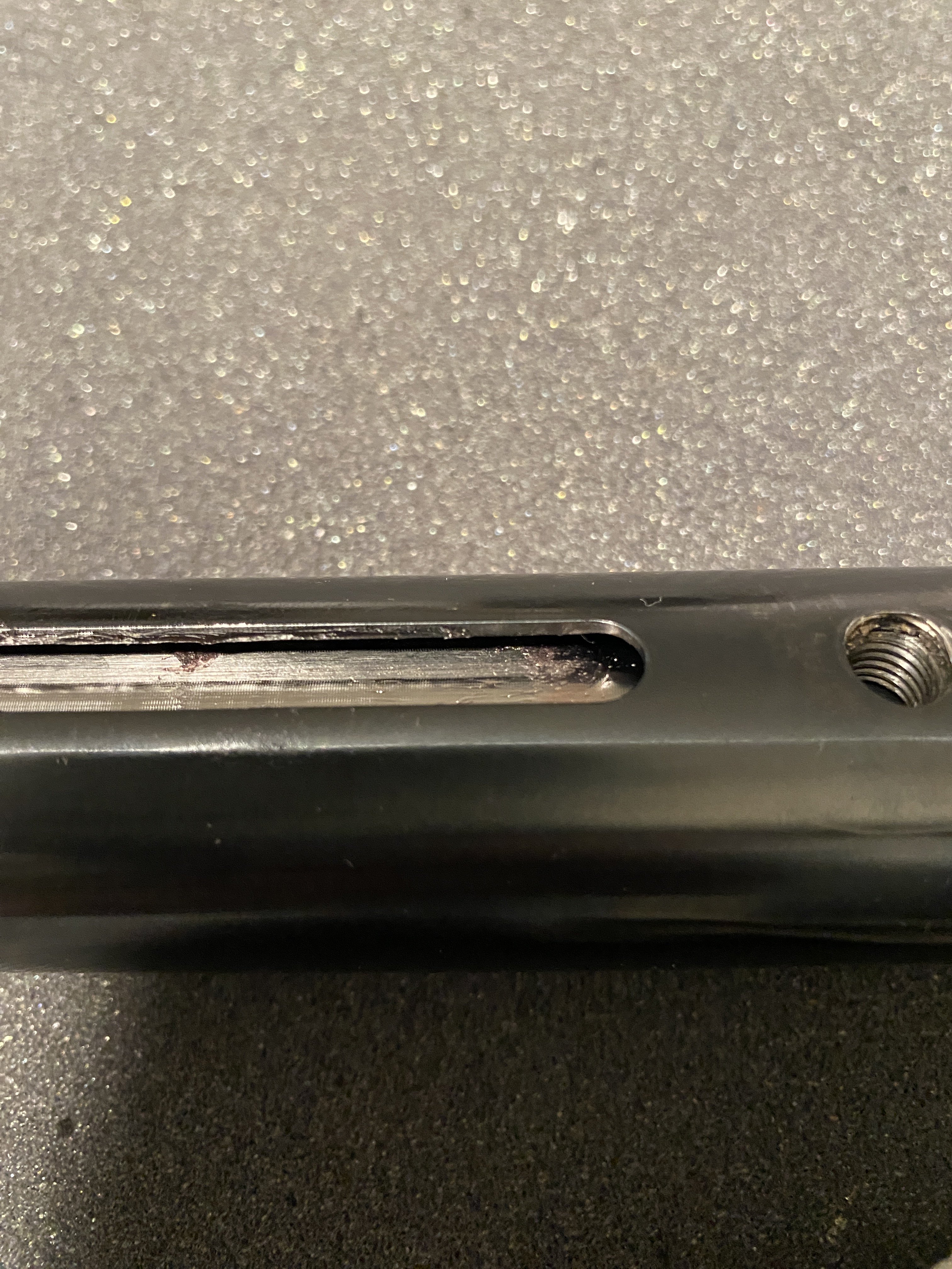

Vortek pg4 ruined my hw95. The cocking shoe damage the spring guide that is obviously too big. Other people mentioned making sure you have the new cocking shoe. Mine already had the new cocking shoe still didn’t clear it . Grinding was so bad it destroyed the kit. I tried 4 different attempts to remedy the issue and nothing worked. Wasted over $100 and now after talking it completely apart so many times the gun ended up with scratches in the blueing. Never going to buy vortek crap again.
You had a grinding issue and kept using it until it damaged something, had you stopped and contacted Vortek, they could have offered a solution. You failed to stop when a problem occured, so why does this make Vortek stuff crap??
And I obviously didn’t keep using it. The damage happened pretty quick.
The damage was an immediate did I ever say I kept using it.
