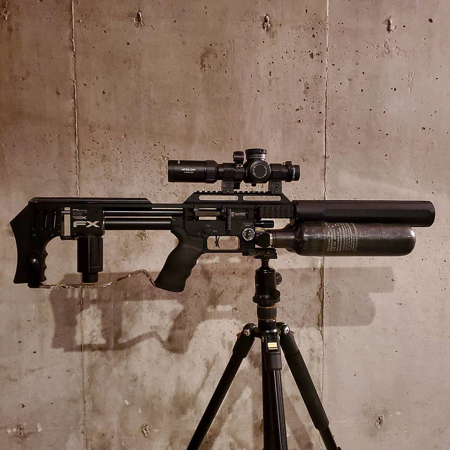

Howdy All,
Looking for advise and things to look out for when installing the new 720 Power Penum on a MK2 (Pre Power Plenum) Impact.
I have read on another thread that guys were having trouble with fitment issues when trying to get the new Plenum Tube to fit in the Frame Housing?
Others have had issues with getting the correct velocity after installing and some say it's the new springs that come with the kit.
The kit I purchase is the while kit made for upgrading the MK1 and MK2. The kit also includes the new Power Block.
Any and All information is much appreciated!
Thanks in advance!
(Image of the rifle I will be upgrading)

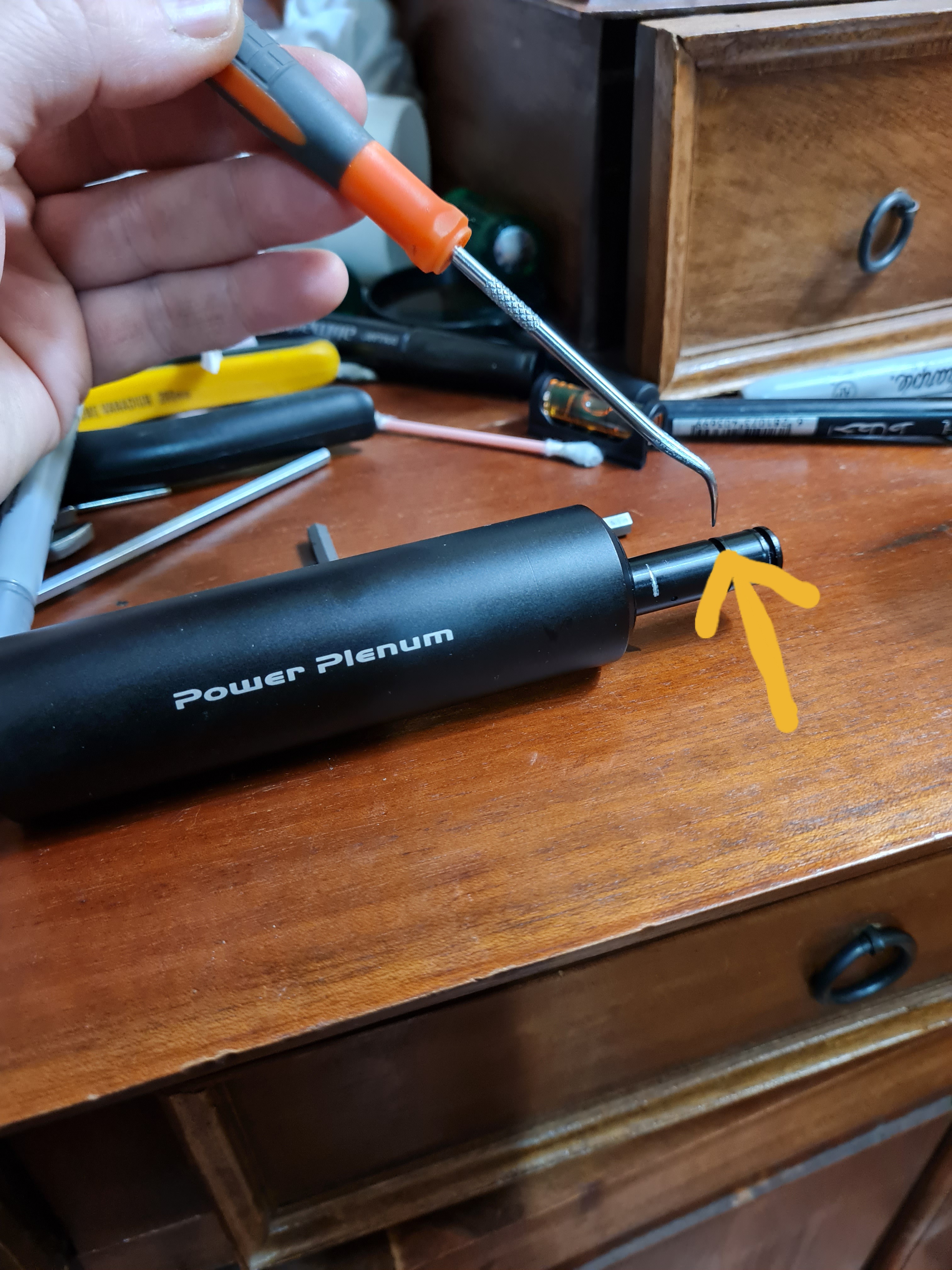

The most common problem in older model impacts is to manage to insert the front part of power plenum in the action.
Me I didnt manage to insert this part from 2 new power block kits even when I remove the 2 orings .
I thought it was a fail from factory and there was
a small difference in diameter.
Check this video I posted from Europe airguns and will solve this problem . Language is in Spanish but doesn't matter . You will understand easily what he is doing .
Before I watch this video I paid enough money to gunsmith to modify my new power kit .
I hope I helped !
