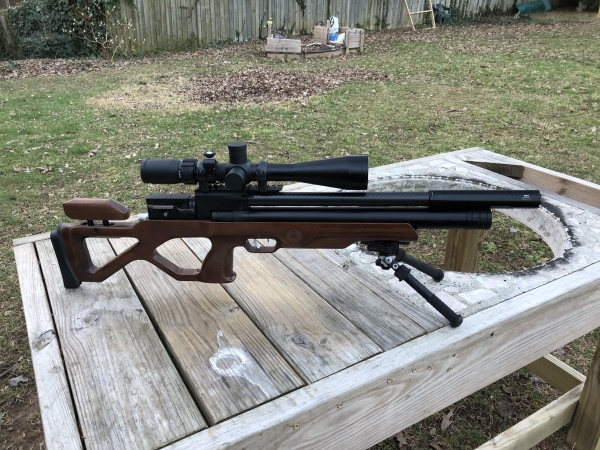

Took a little time to do some shooting and see where things are after the last tune. Lighting was not optional outside and the Chrony only worked part of the time. So, the first 25 shot string will be used for speeds.
12-19-2018 @ 1610, light breeze. Filled to about 250 Bar. Gun hammer adjusted to shoot the 18gr JSBs at 895fps.
High 898, Low 890, Ave 893, ES 8, SD 2. Over 25 shots. The actual shot count was about 52 to 54 before falling off the reg.
Did not measure groups, but we are looking at 1/4 to 1/3 inch at 30 yards.
I could not repeat the whole test with the 16gr JSB, but it's a good guesstimate that the gun will shoot over 60 rounds before falling off the reg. Will try and run these numbers when time allows.
I did shoot a couple of 25gr at 780fps for about 1/4" group, and 34gr @ 690fps less than 1/4" (same hole)
All in all I'm very happy with the performance.

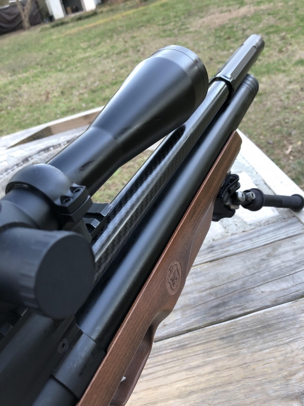

Looking good Christian. I think I like the larger diameter CF that you used better than the 18mm diameter CF that I used. Nice job!

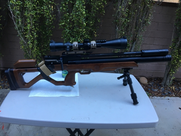

PS. I know you had asked a little while ago when I did Nicks power tune on his .22 Cricket mini. With just adding the Ernest power plenum and changing nothing else, how would that affect the gun’s performance? I did that Saturday to my Cricket mini. Velocity went up 20 FPS from 855 to 875. Not major but measurable and significant. But now my air tube is longer than my barrel with Tanto. I guess I need a Koi. ;)

I’m still going to tweek a bit more that CF shroud. Looking for a better option than the Gorilla tape. Your original idea grew on me fast, but only after I saw I could do a larger diameter CF, I was not in love with the look of the skinny tube and multiple steps (barrel, adapter, Koi) But centering it while still “floating” is a bit more challenging. I’m also going to paint the tube with a satin clear coat. I don’t really like the ultra shiny tube, something in the middle is more up my alley.
Oddly enough, I've never shot the 16 grain pellets from my Mini. I've shot the 18s almost all the time, and the Polymags from time to time when rat hunting at night. FYI, added benefits of the Plenum is that it allowed me to back off the HST almost a full turn to get my speed back to right around 865 FPS. So the cocking is easier, the gun actually sounds better (hard to describe), and the efficiency increased. Like Nick, I can now get about 5 full magazines on a 250 bar fill at 860 FPS with the JSB 18.1 grain pellets... ;)
I've also noticed, and I can't say for sure if it was just the plenum, but my ES for a two mag string (28 shots) is very low. I hadn't checked that in quite a while before I added the plenum, so I don't know if it was this good before (its always been less than 10 FPS). My 28 shots varied from 863 to 869 FPS, with only one 869. So a true ES of 6, but except for one shot, closer to 5 FPS. This is with the stock Cricket reg. that I haven't touched since I bought the gun. I bought it used, so I can't say for sure that its never been rebuilt and polished like Ernest does in his videos...
