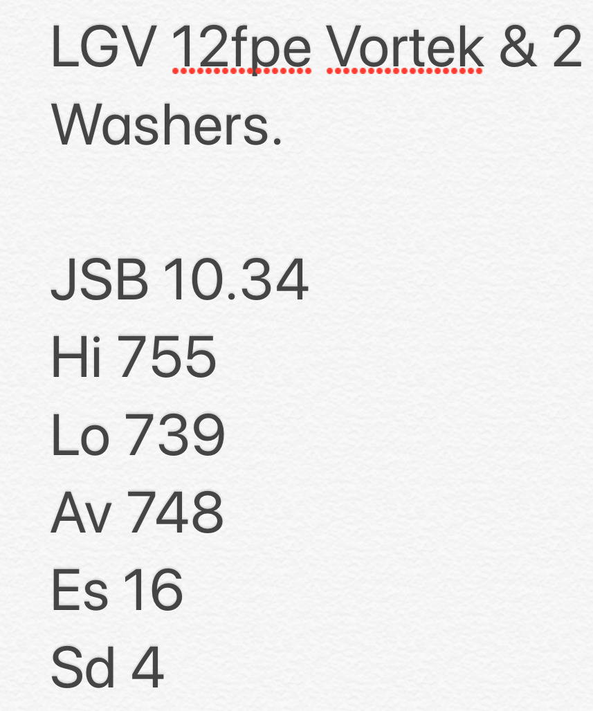

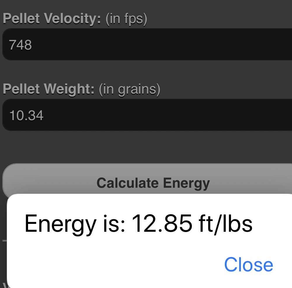

 Current Situation:
1522349279_19111819685abd34dff19f15.22837287_D2E6B7CF-922B-4CD6-898E-0475D0F8FC91.jpeg

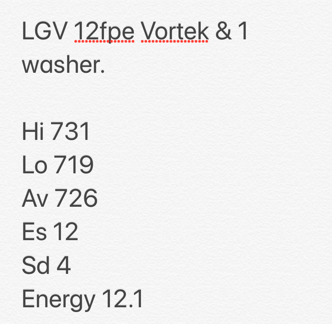

Goint to remove washers and see if it drops below 12.
Compress or remove a coil. But if you are happy with it where it is at, is that really worth it...

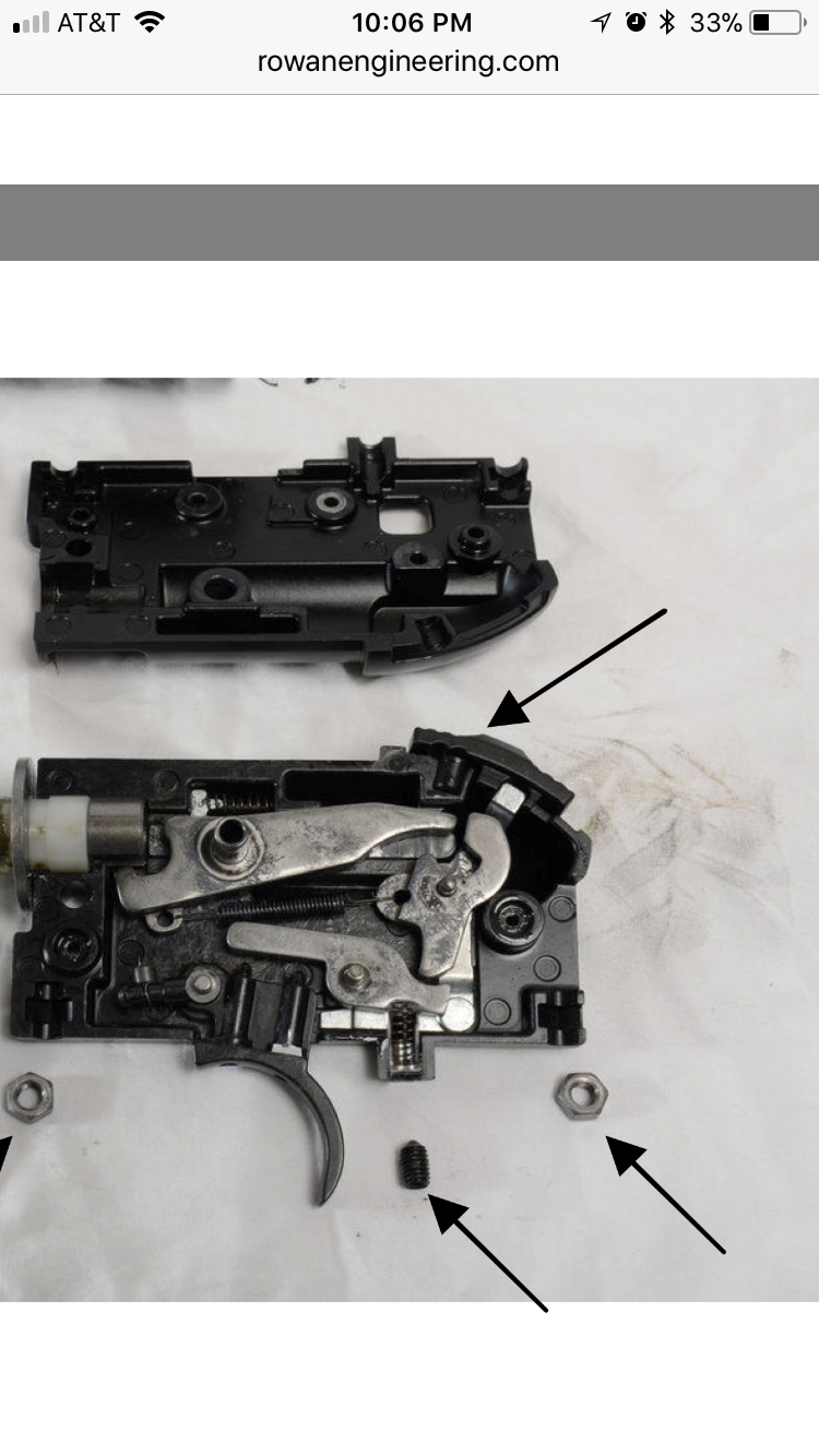

"Crutcherro1"
1522376232_19252439785abd9e2890e723.51113037_83D97AAE-D25A-45F8-A2B9-D4EE2ADF631F.png
When I backed out the tension spring grub screw on my original equipment screw, the pull weight decreased to a perfect weight.
This picture is in Rowan LGV trigger’s install and adjustment PDF from their website. I believe that the tension grub screw adjustment should correlate to either the Rowan trigger or the stock trigger.

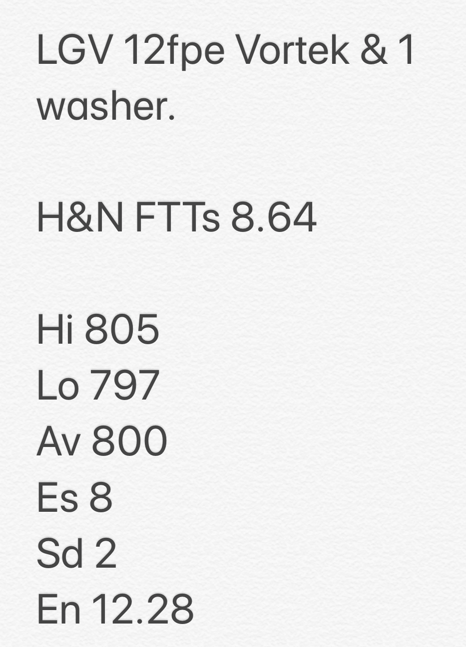

Results after barrel cleaning:
JSB 10.34 x 5 @ 30 Yards. That shot to the right was all me, but still not too bad. (Please ignore the shots on the white part of the paper as these are not part of this group)
H/N 8.64 x 5 @ 30 Yards
