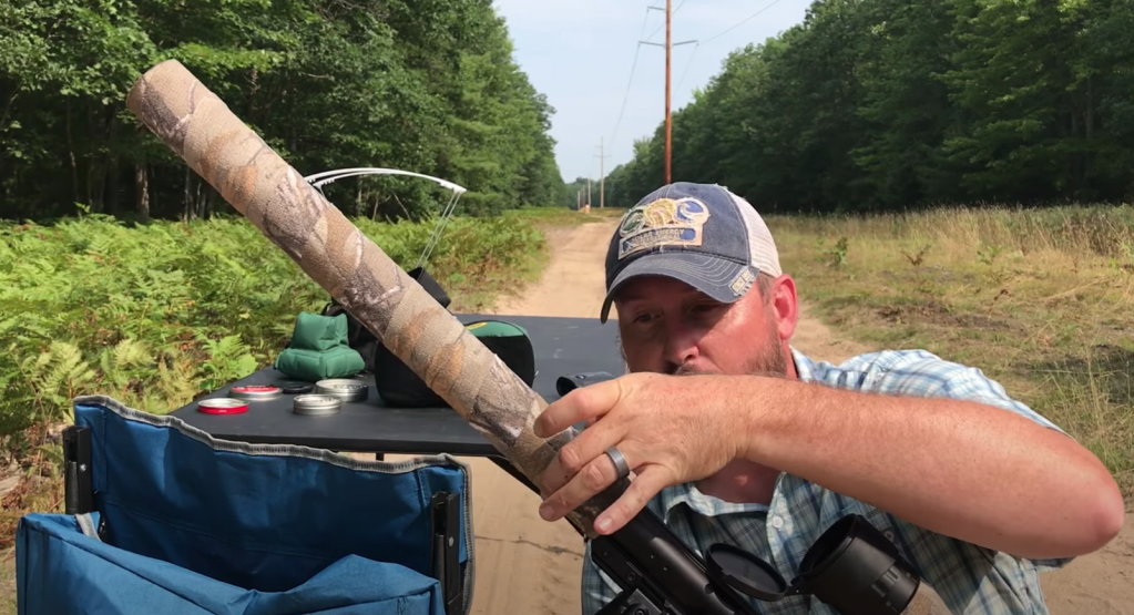

Yup. PJ Clark and I have done a TON of testing and discovery using every single DonnyFL can and we found that even .4 ounces of weight change can change your POI a TON. Those findings fell in line with what I had already found with the dampening and trying to barrel tune big bore airguns.
If you have been following me the last few years you may recall seeing those rubber Limbsaver donuts on my barrel and this hideous shroud thing I had on my gun from the very beginning of my YouTube Chanel. That is actually where this idea started as I made that shroud out of ABS plastic tubing. The secret sauce is what was in side of that barrel shroud I had made. There were two rubber pull plugs on each end for dampening and then a collar weight on the barrel itself I would move up and down the barrel. What I found was barrel harmonic tuning was NOT a macro effort of sliding something up and down the barrel - it had to be very small adjustments. I could literally nudge the collar weight almost an imperceivable amount and it would change the shot groups. I think people who say those rubber donuts work have found that dampening does help, but to find WHERE it needs to go on the barrel is a total lucky guess.

Your not the only one that has been looking into doing a barrel tuner. Here is me messing around with the idea. In the end I could see it showed promise but needed to find a better way to make fine adjustments. Bill

Right on brother. This isn't the first barrel tuner by a long shot. Barrel tuners have been around for a loooooooooooong time. I just watched your video and if you test it long enough, you will find the same thing I did with the home brewed one you see in this photo. Large macro adjustments up and down the barrel will have you chasing your tail. Trust me, I spent all of 2018-2019 doing that exact thing with a collar weight on my big bore airgun. Sometimes I would get lucky and kind of sort of find what I thought was an accuracy node, but it wasn't repeatable if I took it off or moved it. My aha moment was one day I barely nudged it and it opened the groups significantly. Nudged it again and it changed the groups yet again. That is where I came up with the analogy that trying to find harmonic accuracy nodes or if you want to take a deep dive discussion into positive compensation barrel tuning, buy moving a weight or a deresonator donut up and down the barrel - it is like trying to measure a grain of salt with a yard stick. The weight shift only needs to be in the thousands of an inch to have controllable and repeatable results and you have to have a way to return to that spot.
The approach that makes this unique though is how it is a fully integrated system that takes different aspects of barrel harmonics from dampening, to stiffening, to tuning all while keeping a nice sleek FX look and feel so it doesn't look like you have a roll of toilet paper or some plumbing parts on the end of your gun. During my research, I looked more into the precision shooting powder burner world to see how and why they were using them when they also have so much control over their custom loads.
